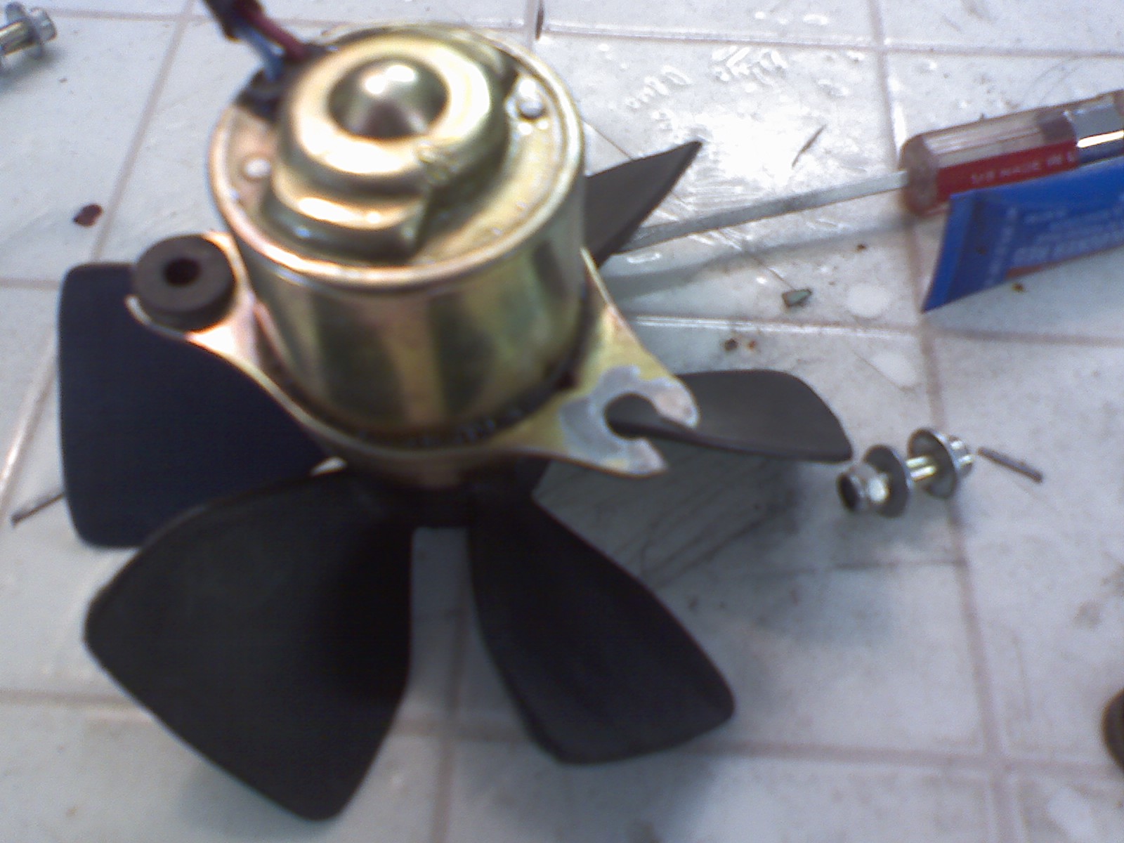

Just remove the metal housing and looks like the mounting holes are exact.

Still a lot cheaper than buying genuine, at the worst you'll just have to slot the mounting holes by cutting the metal around the rubber. Looks like the connections are the same unlike the 1 I used although everything was easily done
Quick update.
IT'S ALIVE AGAIN

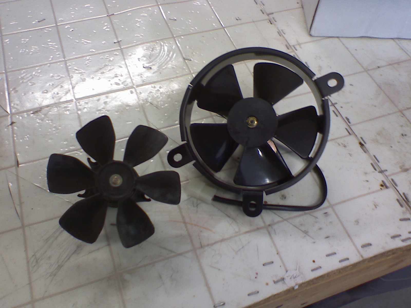

Left Original Right Fan from Helixparts
Fan blades direct swap

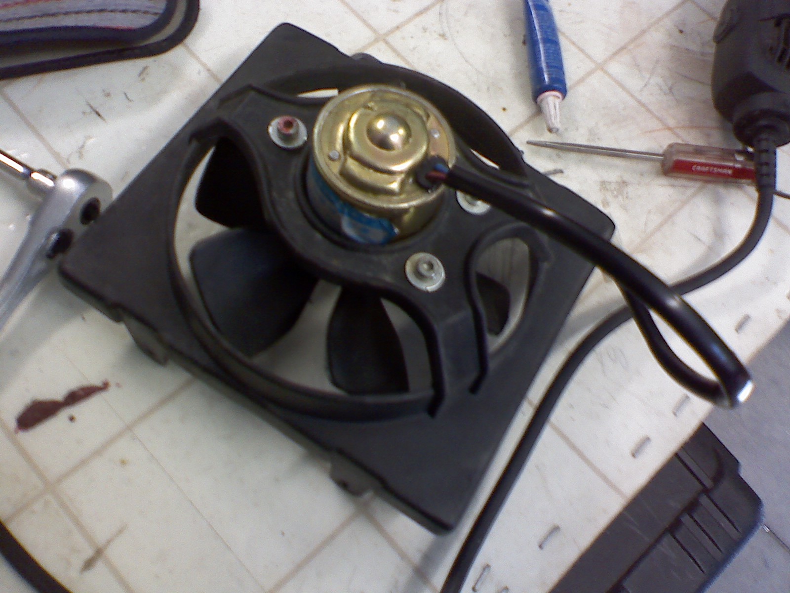

The new one had threaded mounting holes. so I drilled them out to 6.5mm like my original fan. Also slotted the holes like the original. (made inserting the rubber grommets easier)
Bolted directly on with the original hardware.
The electrical connection is exact same as the original, just plug and go.
