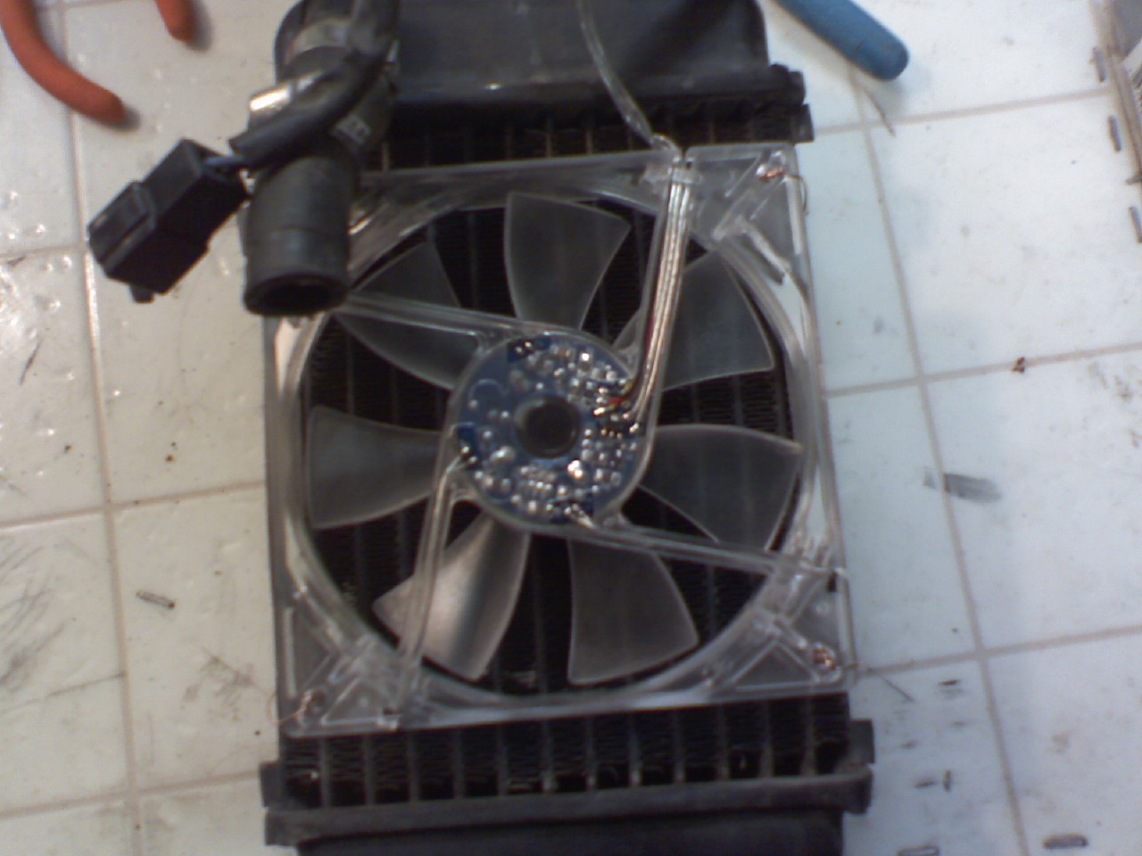

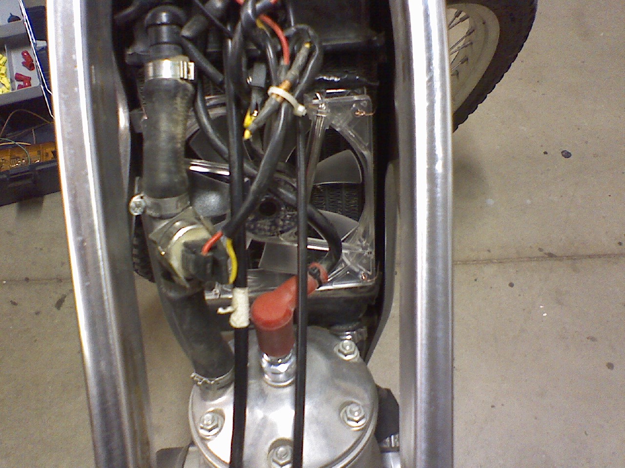

I would like to send a BIG THANK YOU to my good friend Biffsgasgas. :D
He put in the time and effort of Research and Testing of the Computer Trials cooling fan.
And then he was kind enough to hand one over to me. He took it right off his bike after a very fun day of testing it. And it looks really cool when running with the red led lights on it. (maybe I will get a vid of it in action.)
Attached it using welding wire wrapped and twisted around the fan housing and radiator
Now to finish up the other cleaning and lubing things and go play.

Apparently the computer fans are not quite robust enough. Biff had it on his bike for a while and then I transferred it to my bike. Took it out for a test ride today and about 20 minutes later it was fried.
Guess I will have to just have to break down and buy the proper fan. but it was a fun experiment.

I would guess that the poor voltage regulation (compared to a computer power supply) would be the reason the fan died so quickly....assuming you didn't do the "cup of water" test :lol:
You could introduce extra components to stop this next time but to be honest it wouldn't be worth the hassle.

After taking the fan off, the blades were all wobbly and hitting the cage. so I think it was a shaft issue.
OH well, just gonna break down and buy the proper fan someday.
