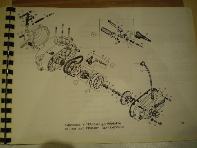

Hi Steve - Here is a photo of the clutch parts from the model 158/9 parts catalogue. Hope its all there!
Fantastic - NO extension in this picture !!
Thanks for posting that.
