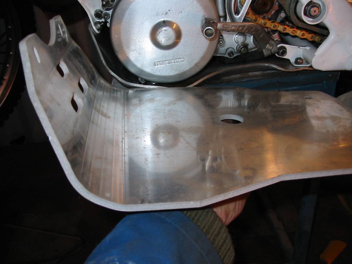

got me Flat bash plate today, nice bit of kit too :P not sure if it's a OE that is fitted to the latest SY's or some after market item.
It's 6mm thick!! compared to my Scorpa's 4mm, don't think I'll be bending that in a hurry (not unless Bikespace sumps it out for me :wall: )

Marky,
Unless they have changed the flat skid plate since I got mine, you will have to make the hole in the middle a little oblong, that is if you want to change the gearbox oil without removing the skid plate. I used a carbide bit on an air tool to open the hole up just a little so that a socket wrench would fit on to the plug.
The flat plate is great to ride with. You won't wobble if you land your skid plate on a log.
