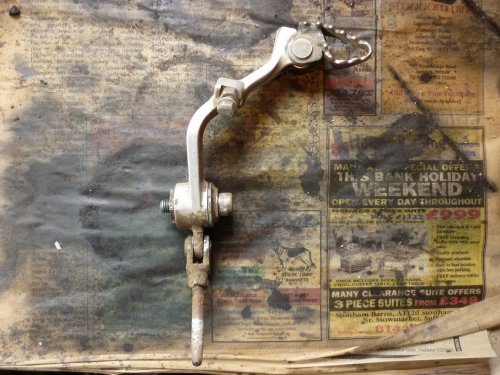

I managed to hit my rear brake pedal on a stump the other day and bent it out a bit. Who can tell me the procedure I need to follow to bend it back into shape? It's aluminium and I'm assuming it will be better heated a bit first, but how hot, and quenched afterwards or not? It's a 315R one if that makes any difference to anything.

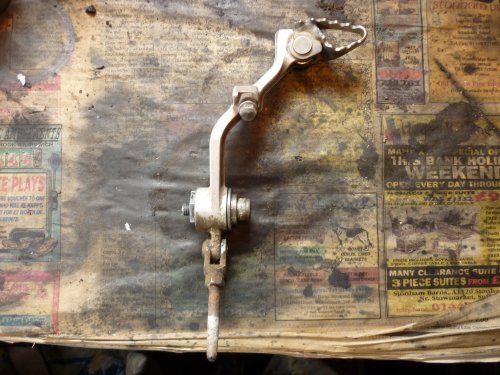

I pressed the bearing and seals out, stuck it in a vice and heated it gently with a Propane torch, whilst keeping a bit of pressure on it with a big spanner. It resisted and resisted and then slowly bent a bit. Then stopped. I heated it a bit more and it gently went again. Repeated a couple more times and it's now better than when I got the bike. Looking good.
