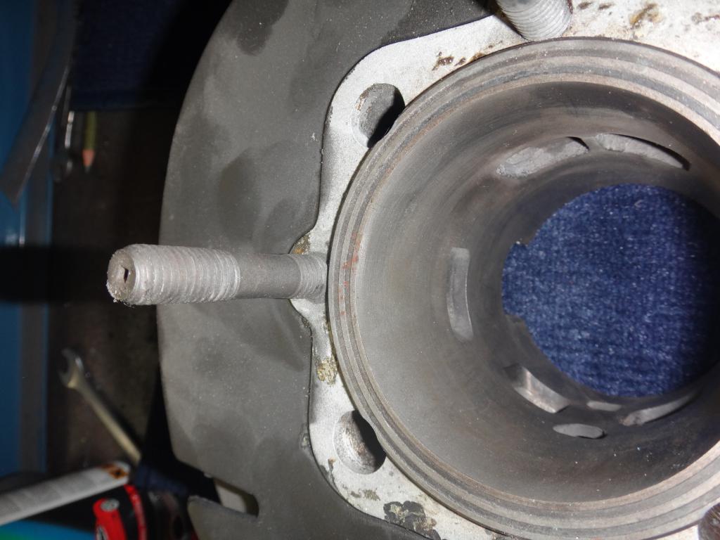

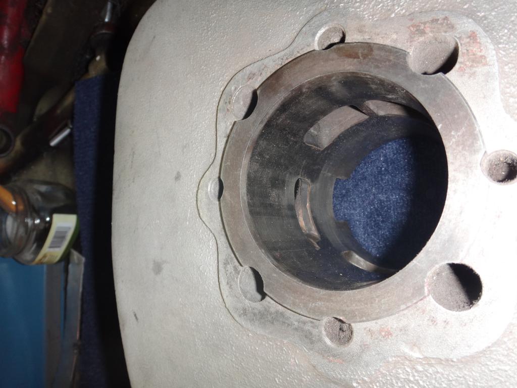

Steels yokes and early sliders didn't find them so far , all the rest is there. Interesting about the front brakes ...Friend of mine (same age as mine , born in 1965) said of the front brake ....Yamaha FS1 (Fizzer) rear brake.... I'll post 2 pictures of the barrel , original 247 and the square special. Mr Thiel used a lot bigger ports!!! those it look like a Greeves cylinder barrel????? I am now tracking down the old preppers who worked for Henk Vink, Renstal Bruinsma , mustn't wait to long because they are all in their 70ties

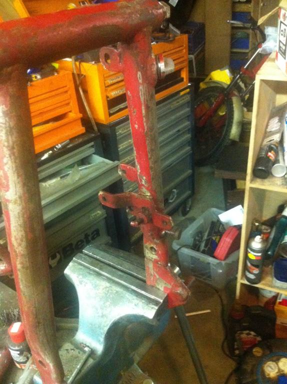

Can anyone confirm if this is a normal 247 MK1 swing arm?
tks
Esper
Edited by esperovich
And then its clean : glass bead blasted , ready to regain its former coating!

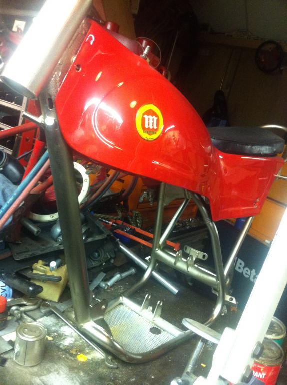

latest update on 247 Henk Vink 247 restoration!  Frame is replated now and I am starting to put everything together I was a bit nervous because of the level of plating. Henk Vink was the first of all ( F1 teams included) to have his presentation superb. thats why he had a nickel plated Montesa 247 frame. I had it replated but how shiny it was and had to be? ( I want to ride it !!!)  luckily I found some prove it was not that shiny inside out in those days!

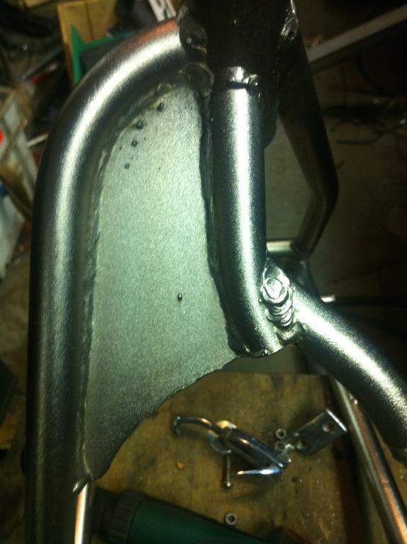

This is why : here you see some welding spaters with a Barcelona signature from the mid 1960s! so I am happy with the newly plated frame so far!
