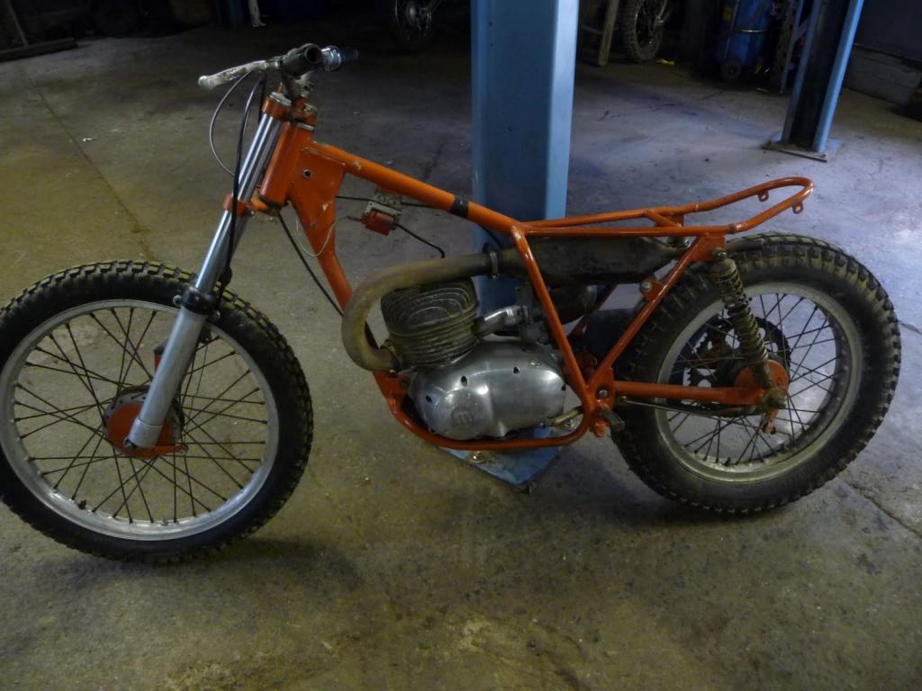

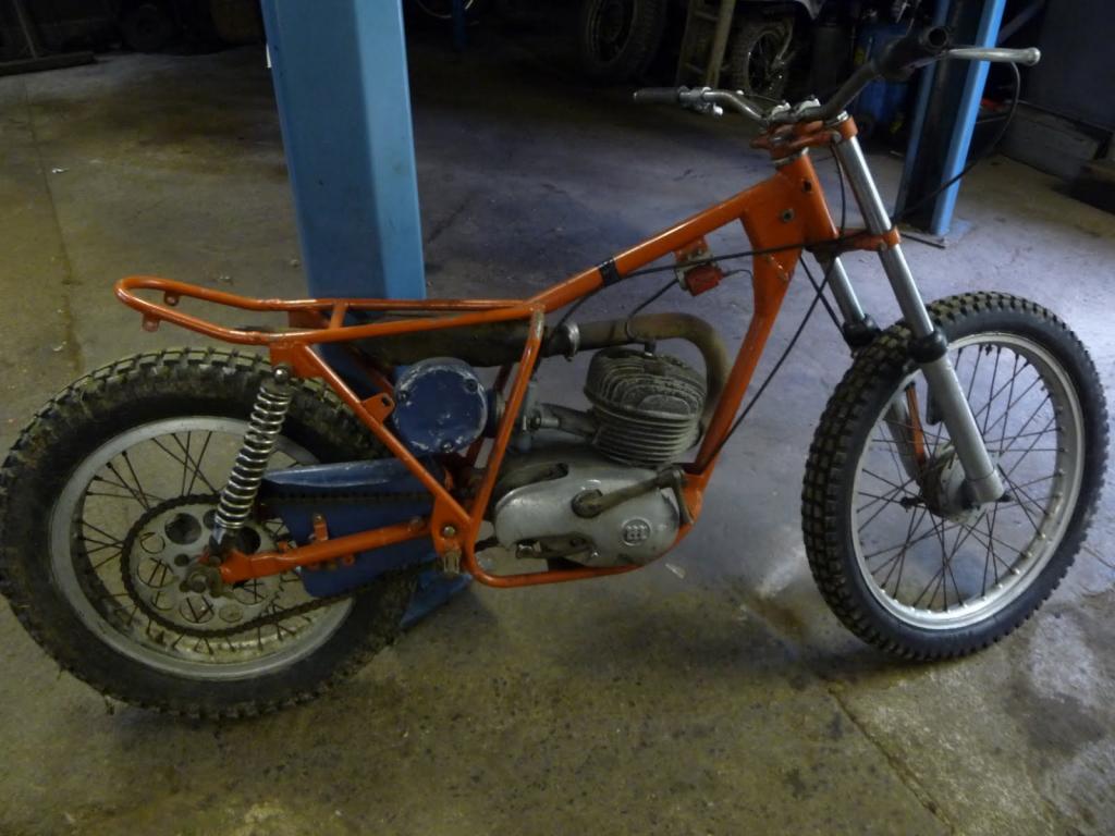

Finally got round to taking a couple of pics of my latest Cota.... I intend to use its engine in my original 247 as this one is up and running well.OK it wont be the original in the bike,but it will massively speed up getting a big hub Cota back into use.(We are talking months here,cos its still 4 projects down the line....)
