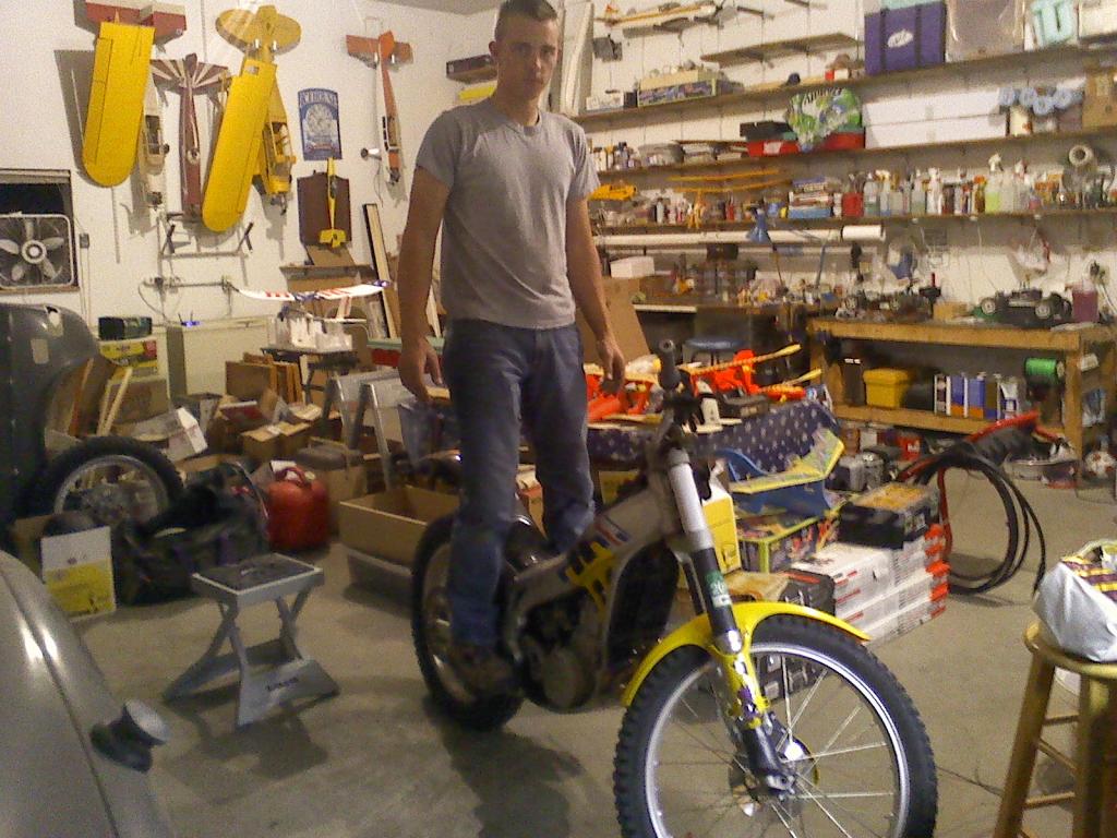

The best thing i have discovered when it comes to balancing is to just get out and practice. When i cant get out and practice outside especially in the winter ill practice balancing in my garage. just by practicing balance for a hour a night or so it starts to get easier. When i got my girlfriend into trial i started teaching her how to balance off the start and it helped get her used to the bike and get a feel for how the bike can move very easily with very little movement.post-10302-0-08415800-1365745431_thumb.jpgpost-10302-0-06000900-1365745451_thumb.jpg
