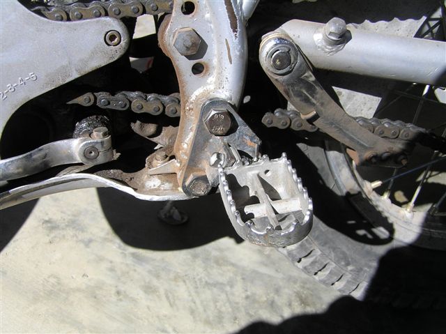

They do help,and yes are in a better position.The only problem with them is that they are too weak,mine kept on bending until I welded a brace at 90 degrees down their front edge.This stopped the bending,but you obviously lose the plated finish and will need to paint them.

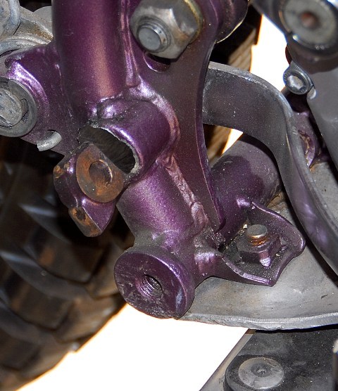

One of the best improvements for the TY. As has been said the bracket is a little weak and will bend in over time. Easy to straighten. Things to note: Is your frame equipped with the lower rail studs? If it was a CAT model for the US it will be and fitting will be no problem. True 74 Ty's only had an open rail and you will need to either fill and drill + tap or go for the easy option of a length of threaded rod and use a self locker on each end. All later frames had the lower rail studs. You will need to check the length of your swinging arm bolt (they come in 3 sizes) if it was a CAT model and has those lower studs it will be long enough.
Also you have to remove the old hangers with any of the footrest options. You might want to read my blog article on 7/28/2008 on how the operation works with all the pictures.
Tony
David,
The TY175 replacement SM pegs are a direct swop, but on ALL TY250 models you MUST remove the hanger as it was part of the frame.

The SM kits I have seen do not require removal of the original mounts
You sure you are fitting them the right way round? Just asking as if you fit the left on the right etc you dont have to remove the lugs but the rests are then too far forward. Thats from memory on a bike i had in a while back. I just cut em off and fit a new bracket and modern rests.

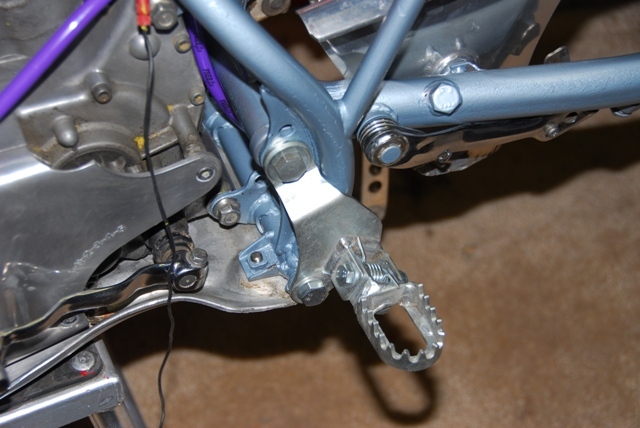

I do agree that it change the way the bike handle and I like the lower and back mod. The first setup I made was not in the right position for me so I made a second one that is at the right position http://s1065.beta.ph...907578292812924
I cut the lug, drilled and taped where the lug was, on an A model I decided to weld a threaded '' washer '' and voila home made bracket that is cheap enough to trow away if it's not to your liking.
