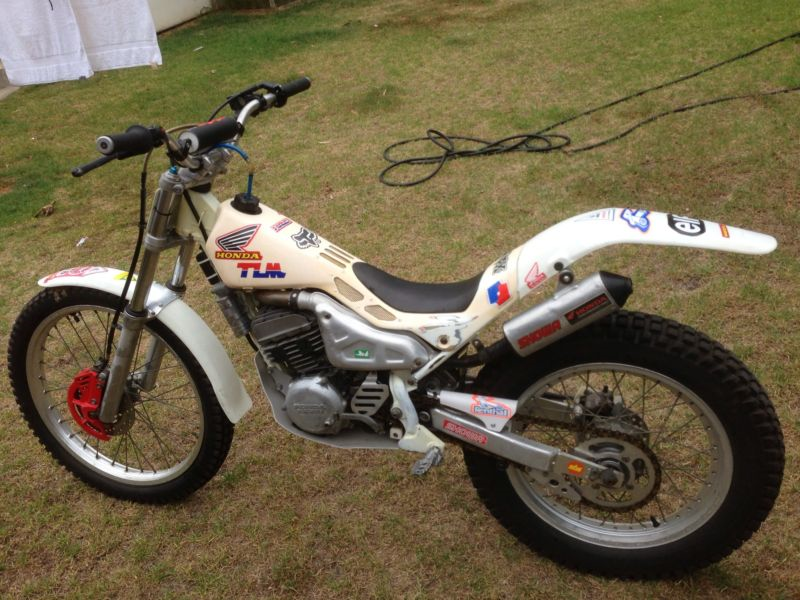

Here is mine as i bought it
That one is very nice 4 stroke! I'm noticing bits on yours that are similar to the Narita special that i've seen in a mag. Not saying the same one but someone had done some work. Aluminum mid muffler, bigger head pipe, shelter/seat venting, same type muffler, CDI box moved to front downtube( which I noticed on Billy T's Pentax). Does it have a flatside carb?

4 stroke somehow it changed its self into a 2 banger from the TLR250 i ride, will be nice to see the difference between the 2 when i get it finished as i ride the TLR better than i used to ride the Beta rev3 250 so can not wait to get this 2 banger up and running
The bike was imported from Japan 15 years ago and used for 2 years and put in the shed for 13 years before i bought it
Carb is flatside and when i kicked it over started 2 kick after been in transit for 3 weeks to get to me and the motor runs sweet but the plastics are shot and shock rubber was just dust (new rubber and service done now)
Still having problems getting the plastics but the rest is about sorted

its to give more power at low revs and allow the bike to rev out more than the standard bike as per the factory bikes but causes a lot of heat thats why the cdi is moved forward to keep cool and extra vents cut into the tank shelter and a flatside carb to help smooth running as what is fitted to most modern trials bikes now
