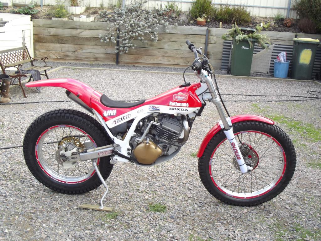

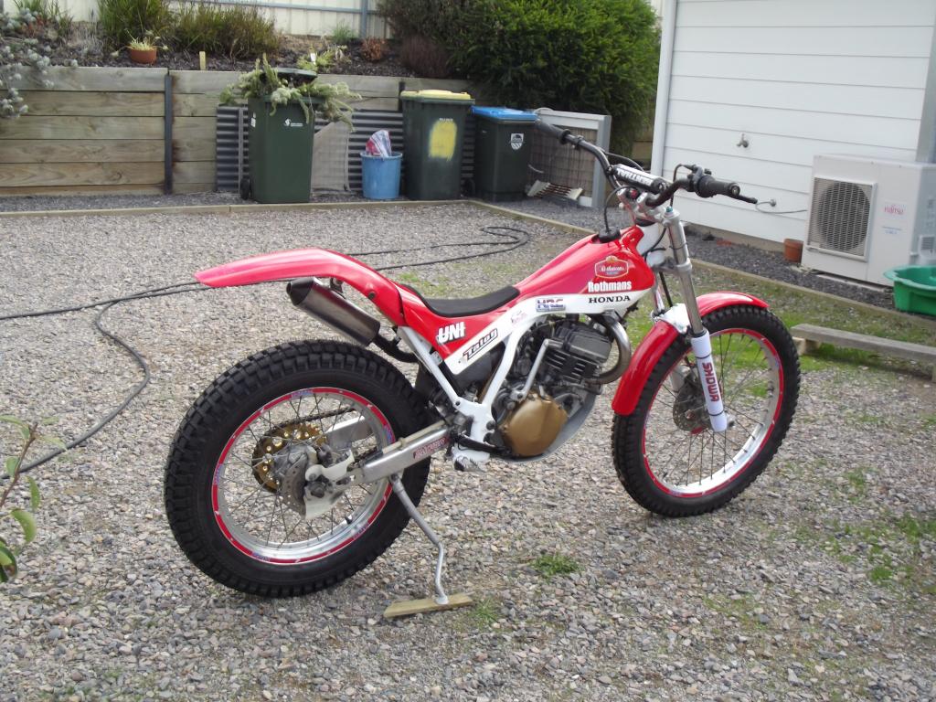

    Here is another pic, cleaned and rested.....
  • As I'm a smoker and have always smoked Rothmans for the last 60 years. (thats not a misprint) I have always had a desire for a "Rothman's". The first was the last of the RTL's although I had a ride on
