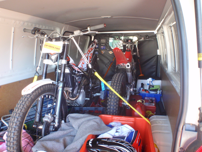

This gets us to our trials area but I'm looking to improve on it markedly.
Post some pics of your set-up when done...
Mags
