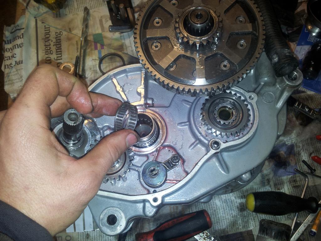

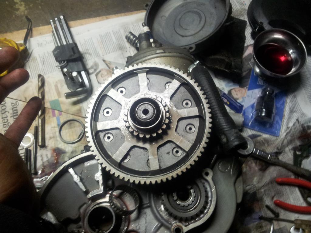

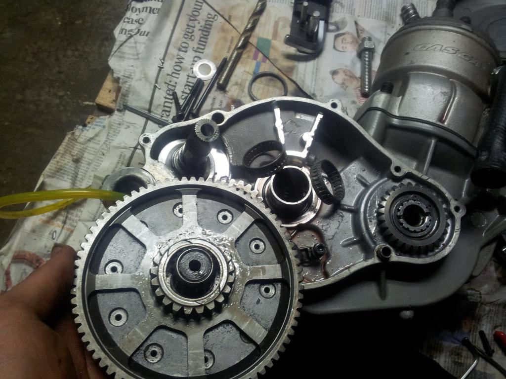

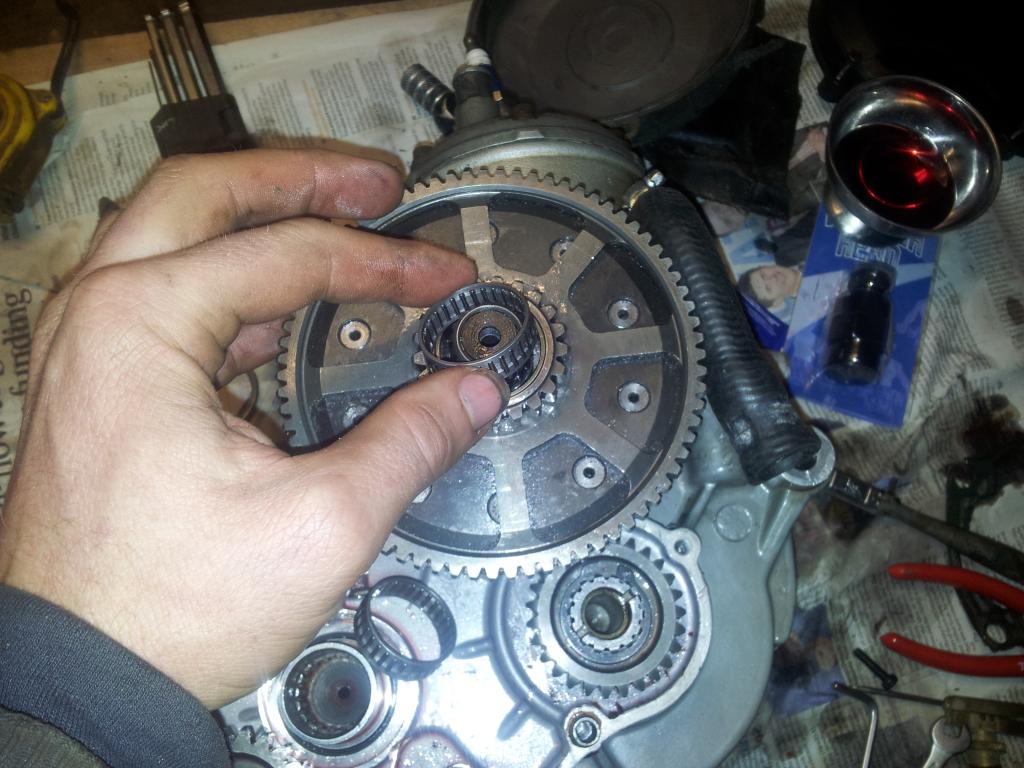

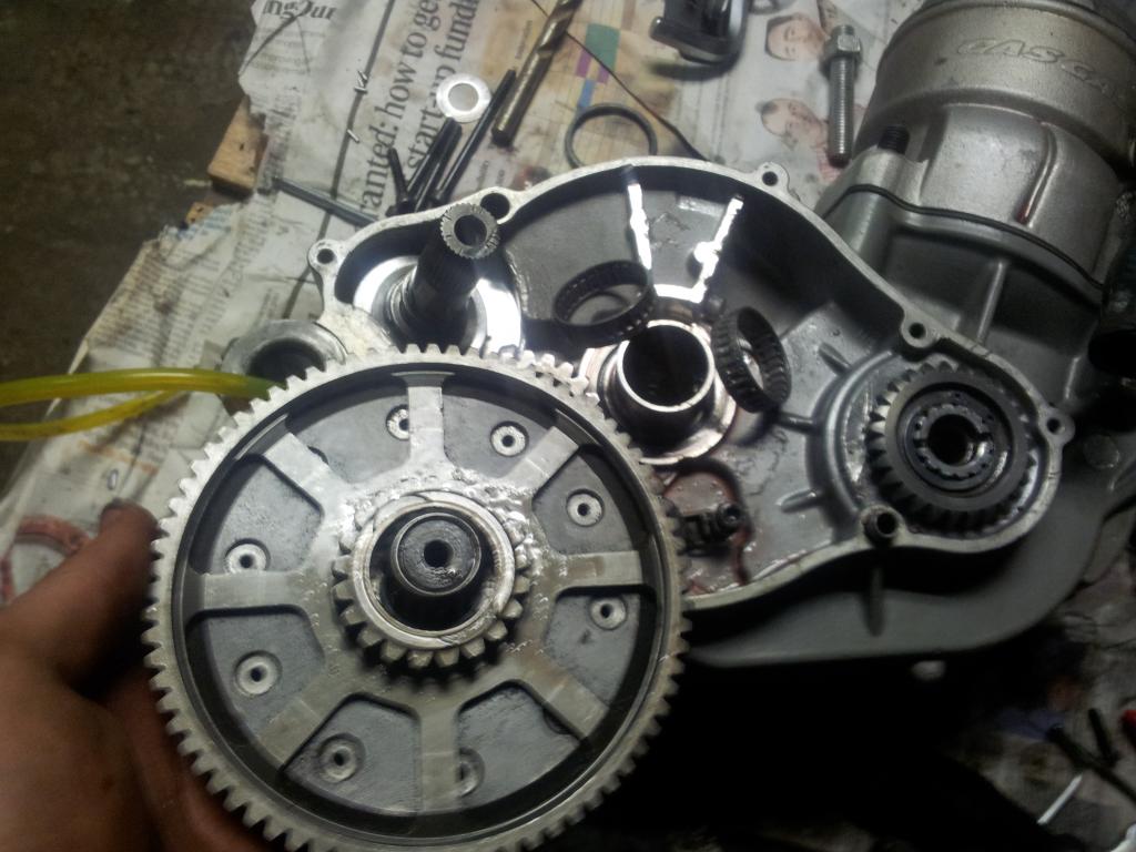

Im afraid theres definitely 2 needle roller bearings side by side that the clutch slides on over the crank. I remember it being a bit awkward to get tge clutch over both.
I got two new needle roller bearings but theres no possible way to get the clutch over them!
post-19212-0-27923200-1386637187_thumb.jpgpost-19212-0-11442400-1386637242_thumb.jpgpost-19212-0-45935000-1386637295_thumb.jpgpost-19212-0-69491900-1386637355_thumb.jpgpost-19212-0-49479000-1386637433_thumb.jpg
No they just dont fit, I think it can still work with out them?
No, it can't. It looks like the needle support collar may still be in the hub, but can't see clearly. If you would, remove the clutch pack from the hub/basket and take a photo of the inside of the hub bore. Trust me, those bearings are made to fit inside the basket hub and you will ruin that engine if you do not install them.
Jon
Jon
Ok I will remove and take a photo of the hub bore, There is something in there alright but I dont think its a needle support collar because it pure round and smooth where as if it was the support collar would it not have groves in it for the needles? and lets just say if this was removed it seems like theres only room for just one bearing to if in there...
also how do I remove this collar?
Didn't the early Pro 02/03 have a bush in the clutch basket? Could it still be there?
I think you have hit the nail on the head, its hub bush alright, as I had a better look at it today...... So big question now is " does that mean I dont need the two bearings?" I take it that the hub bush does the same thing as the needle roller baerings?
I think you're right. For some reason I kept thinking about all the later hubs. Haven't worked on the early ones for some time ( and I'm old and feeble....).
I think the inner hub should just push out from the basket and I'd take that stepped washer from the center hub out just to keep track of it.
I looked up the part numbers for the basket and the primary shaft (essentially the inner and outer "races" for the needles) for the 2003 (bushing) and 2005 (needles) and they are both the same, so I'm assuming that the needle bearings are a direct replacement for the bushing.
Jon
