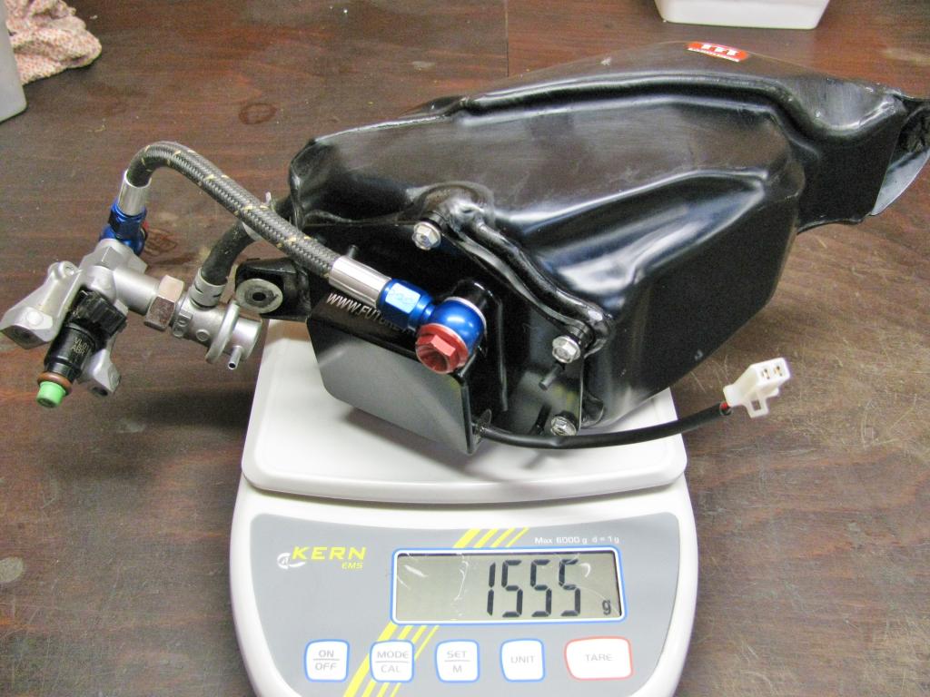

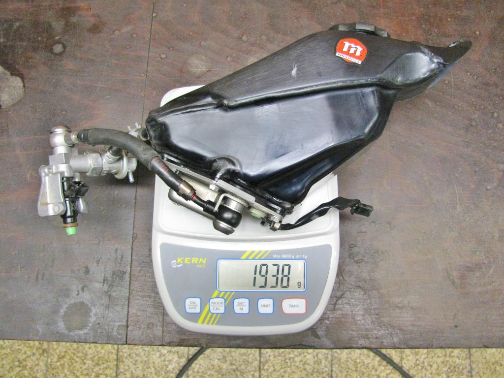

Did you weigh each assembly before and after. The quoted saving is quiet good for relatively reasonable money when last I looked. I did think about having 1 machined myself but was unsure of pump fitting, hose fitting and cable sealing etc.
Was going to look at possibly increasing fuel capacity around the pump to make up for loss with flat tank.
I weighed mine and it saves 383 grams
And I made an aluminium fuel pump holder kind of like the original steel pump holder...
Edited by guys
