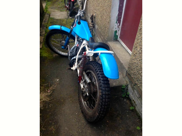

Looking at a Bultaco for sale locally, seller not clued up so can any one identify the model?

  • I guess the rear rim looks like an Morad Akront Style High Shouldered type. If I'm right it was a common replacement in those days.

W hat does the frame and engine number start with The first number are the model type and size ie.221=175 Sherpa or 198 199 are 250 and 350 Sherpa's Also do they match
Not got that information just now, the guy thinks it's a 370cc :closedeyes: so i was hoping that the pictures would help just now.

It could be, judging by the swinging arm. Can you count the gears? If it has 6 that would be good news. Most will have 5.

looks like a 199A frame but can't really tell if the S/Arm is round are box? if round its off a 199 if box it's off a 198B 199B like mine hear.

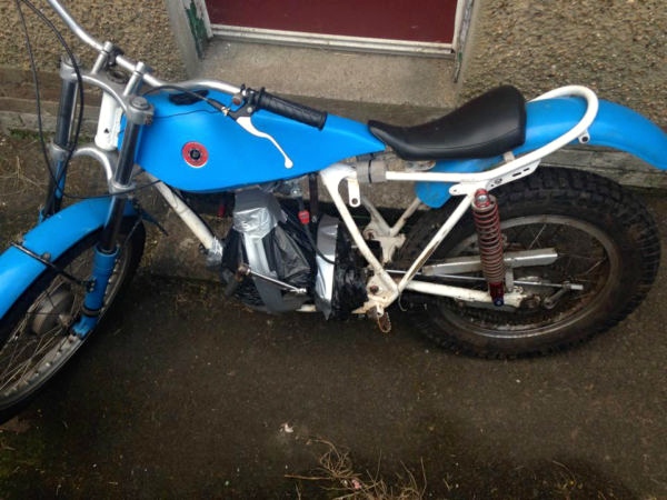

No ones mentioned the bottom frame rails making it a late 70`s model, they had round tubed swing arms before the gussets were fitted with the alloy sump models.

It's a 1978 model 199 if it's a 350 or a 198 if it's a 250. Originally silver frame and red plastics and mudguards.
Thanks woody, guy say's it is 370cc so may be had a rebore at some point, the seat looks like it might be off a different model?

The rear wheel is wrong for the model, looks to be from a much earlier bult.

What about the tank and seat, do you think that they are from the correct year?

Thery won't go to 370cc, it's not possible with a Bultaco piston. The only way to get a 325 Sherpa to 370cc is using an Alpina top end and crank as the 350 Alpina has a longer stroke. The most you can get a 325 Sherpa to using the 85mm 360 Pursang piston, as they did in the 340 Sherpa, is 340cc
The tank on the 199 was the alloy type originally, a bigger tank than the plastic tank now fitted which is from the next model. The tanks had a different profile at the rear and seats were shaped to suit the tanks. That looks like the original seat for the alloy tank
