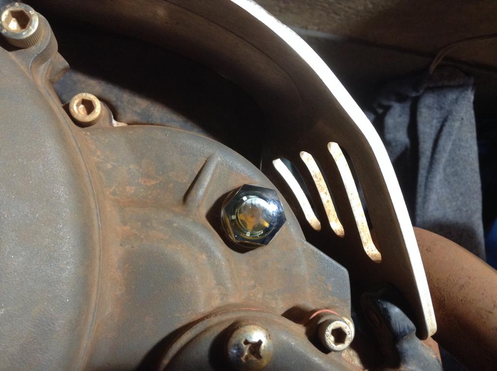

Looked at sight glass after washing bike and discovered whitish gunk on bottom of sight glass window. I'm assuming this is water? The oil on top looks good. Wouldn't oil float to the top?

Sorry don't know why picture is upside down and how to make it smaller
If this is just on sight glass but rest of oil is ok I'd say not to worry. Worst case change your oil and monitor.
Pull off the waterpump casing and check for corrosion if it looks o.k just change the oil and keep an eye on it. Could be a waterpump seal or as others have said just condensation, I get it on mine from time to time and it reminds me to change the oil!!

Lean the bike on its side, unscrew the "glass" plug and clean it out with brake cleaner or whatever.  There are some ribs in it which prevent use of a cloth or the like.

As above lay the bike down and remove the glass and clean.
Refit the glass but do not over tighten, the plastic can become brittle, just put a socket on it and tighten it with your hand do not use a ratchet or bar, socket and fingers only!!
