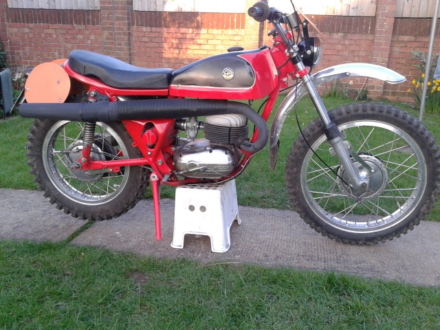

I geared up my mk3 by increasing the size of the front sprocket. Unfortunately I can't remember the size. Cruises at 55mph no problem.
Nice. I see you have the SD exhaust on yours, mine has the trials type so wont breath as easily. Have fitted a 14 tooth sprocket but waiting for DVLA to send me a registration number so can try it on the road.
