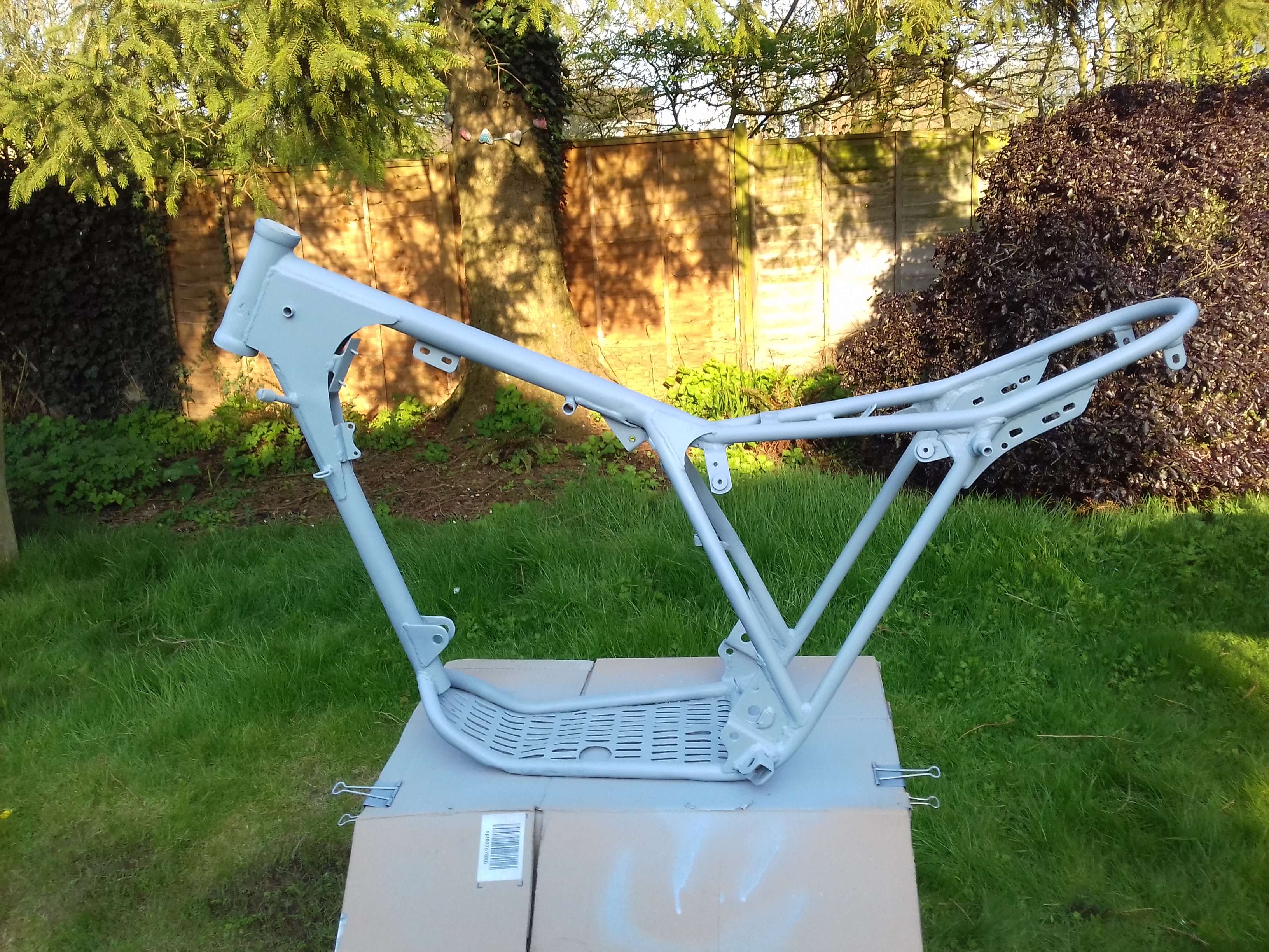

I distinctly remember that I said I wasn't going to do a shiny restoration, I was just going to sort everything out mechanically and have a rat bike to ride around on, I definitely wasn't going to strip all the paint off and repaint the frame .........
So here it is all primed and ready for paint ;)
I had some time to think over the winter when progress was slowed and decided that the old adage of "If a job's worth doing, it's worth doing well" was a good idea :lol:
Expect the idiotic questions to start flooding back into this thread :lol:

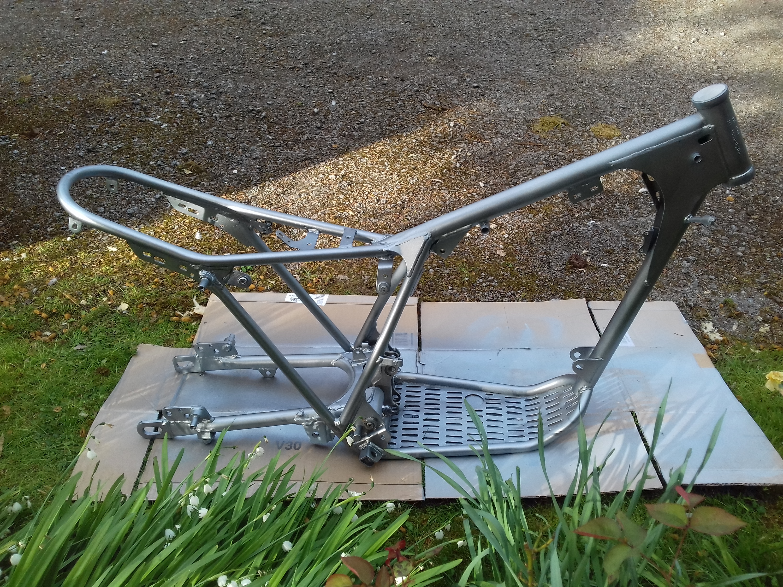

Frame all painted :D
As I'm on a limited budget I just couldn't justify £10 for postage for actual Bultaco grey from a well known shop in Egham, so it's BMW "Space Grey" from Halfords.... :blink:
Let me know what you think.

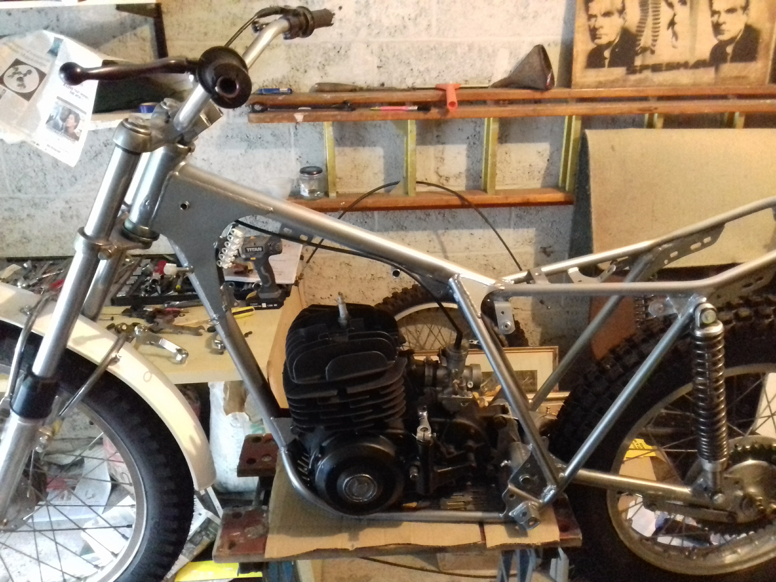

I have started bolting things back to the frame :D
Admittedly I have bolted things on, then realised I have put them on backwards...... ;)
Oh and then there's the paint scheme..... I shall leave you guessing on that one for the moment, let's just say, it's not factory colour :D

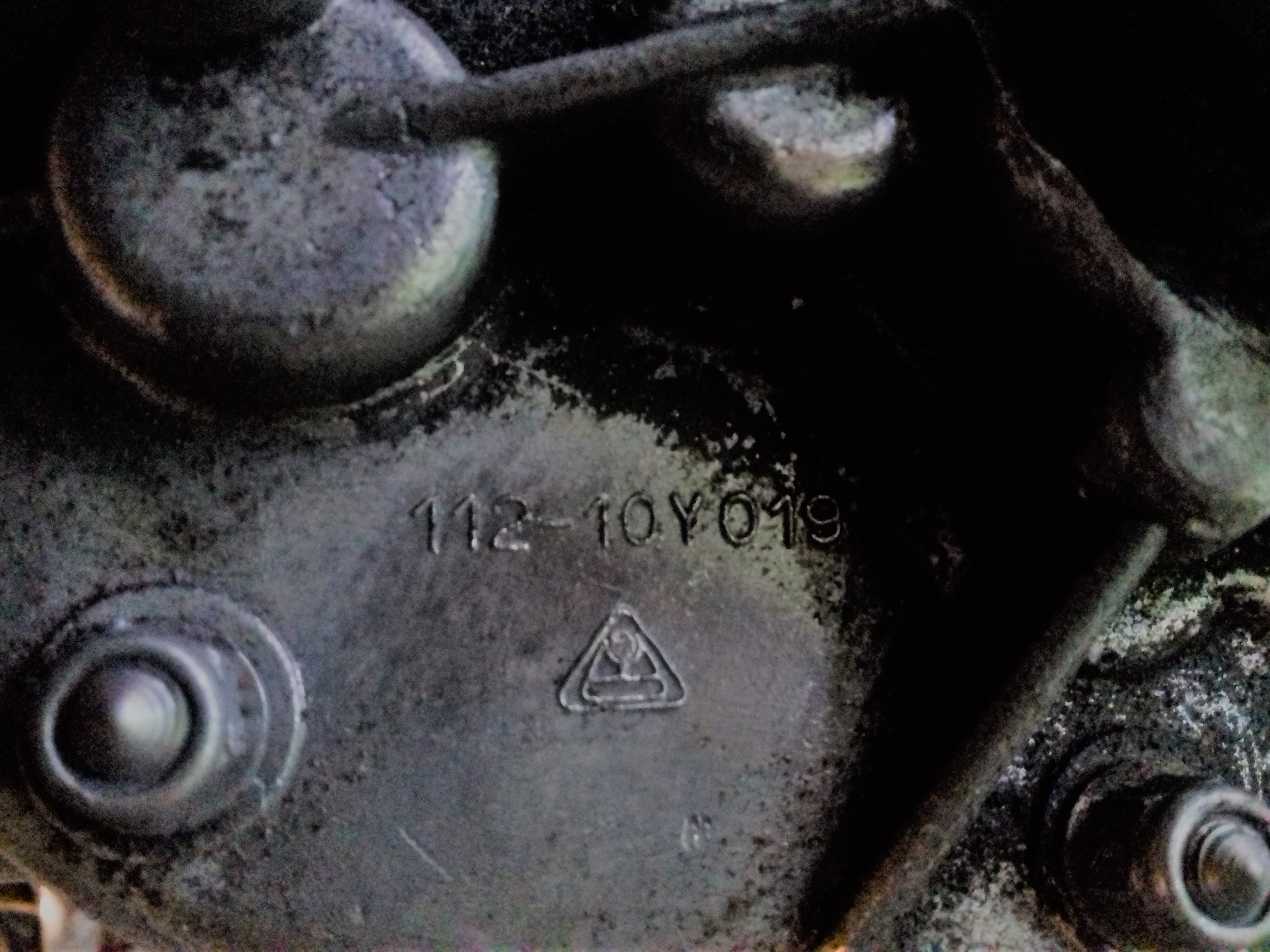

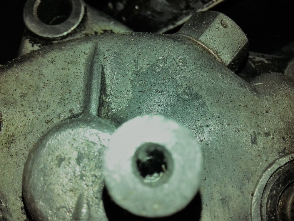

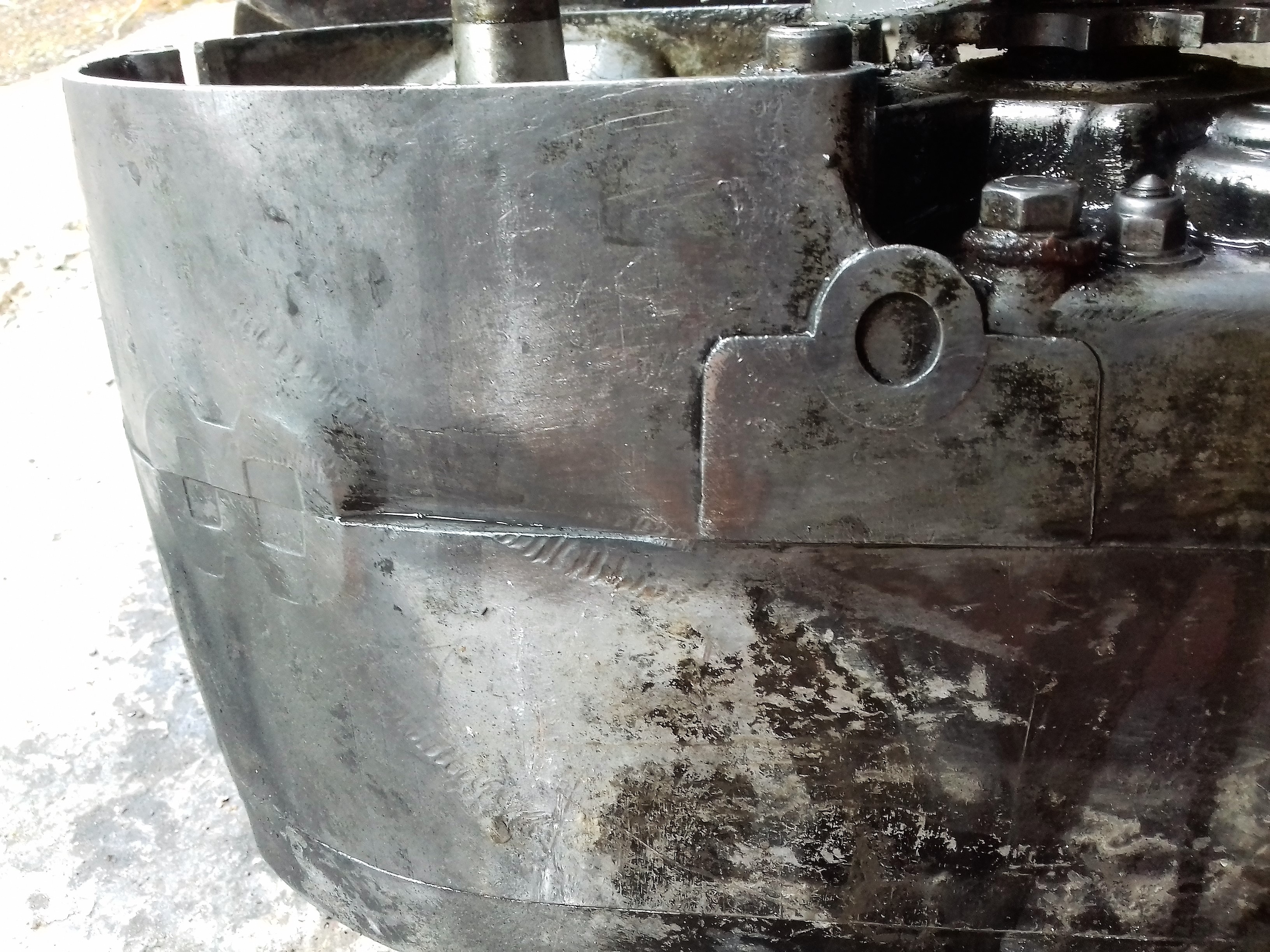

I don't know if this is a stupid question or not but here goes.....
I have been cleaning 40ish years of mud and grime off my engine and as per the engine number I reckon it's a 199-A from 80/81ish.
Just by the drain plug on the left side of the engine by the left-hand shifter spindle there are some numbers stamped into it and one of those numbers is 199 so I was just wondering if at some point half the engine has been replaced or if this is standard (I know in the later years at Bultaco the numbering system went a bit awry ;) ) oddly enough on the bottom of the engine the 2 halves don't seem to match.
Cheers.
A few pics of the mystery numbers...
The step in the bottom of the engine case....
Edited by speshal
All cases have the 112 number. Not sure the reason for that.  It isn't a part number. Could have been a reference number that the foundry used when casting the parts.  Cemoto sublet all their parts to other companies.  Many parts were produced off site and then assembled at the bultaco factory.
What you're thinking are mismatched cases are not.   Again this looks to be something that was done during the casting process.  All cases have these.  Especially 199's. All three of mine do.  On the older engines that drained the gearbox oil out the bottom of the case instead of the side like the 199's they had a protrusion on the bottom of the case.  This protrusion was simply removed on the 199 cases and what you see is the remnant of it.  Remember bultacos used a large number of same or similar parts.
The 199 on the case simply denotes that they were likely lined bored and set up for 199 parts only.   This was important because the 199 uses a different gear cluster set than say a 191 model before it.  Later model 199's also had the stroke stamped on top of the case too.
Steve
