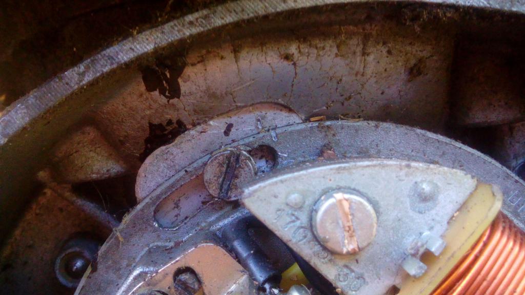

Well I managed to get the flywheel off for the first time in 25 years...
I've discovered 3 things so far...
First thing is, I'm guessing that these marks aren't standard (someone has punched a TDC mark I guess?)post-22741-0-38306400-1470505971_thumb.jpg

The marks are usually from someone marking it prior to removal so as to have a ref. point when replacing it
after removal possibly to replace the seals.
