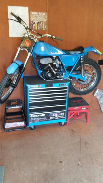

MY 199A dose not have matching numbers but are the correct frame and Engine hear take alook.post-12321-0-94036800-1467236207_thumb.jpg
Edited by bondy
