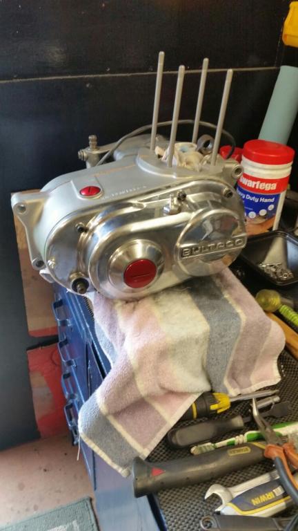

yes it is a clean Engine same as my 340 thats been rebuilt i did have the 1 in the photo vapor blasted then i had to polish the cases myself turned out nice. i have the earlyer 198 ignition case on this 198A it will be red and silver ith the Alloy bash plate the frame is also a 198A i have put the bigger Airbox on it.
I looked up vapour blasting and lo and behold there is a chap not 3 miles away that does it  :thumbup:

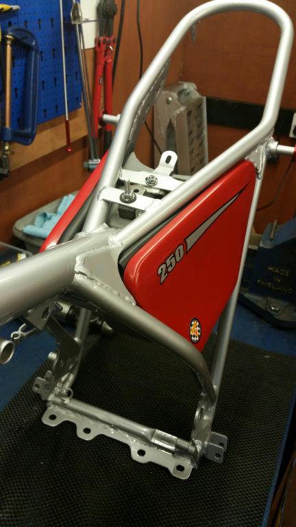

I was just wondering if anyone could help me identify this frame, it has no numbers on it unfortunately?
I'm guessing.... it's a 198 or 199 but some confirmation would be very handy.
Thanks.
Ed
The silver frame is a ...... ;)
Possibly a 183 from 76/77
I don't think its 159 75/76, if I recall correctly that had round holes in the slump plate and not the elongated slots similiar to the one's in your photo.
It doesn't look like a 199/198, as it doesn't have the brackets on the frame to house the gromets to locate the side panels. Thats not to say they have been removed at some stage as the difference between the 159/183/199 frames is minimal. With the main difference in the bikes been how the air box and side panels were attached.
Would you have a photo of the companion swinging arm?

That's correct
Thanks guys, that's great information, I was trying a pictorial visual side by side comparison of a 199 frame. I guess the frame design department had a long Spanish lunch between 1970 and 1981 ;)

It looks very much like my M183 frame. The number would be on the headstock but it has quite a bit of rust on it.
Thanks guys, great info, I'm considering chucking my 199A engine in it if I can't find anything more suitable, I have a few irons in the fire atm but trying to find the right frame and swingarm is rapidly becoming a ball-ache  :wall:
