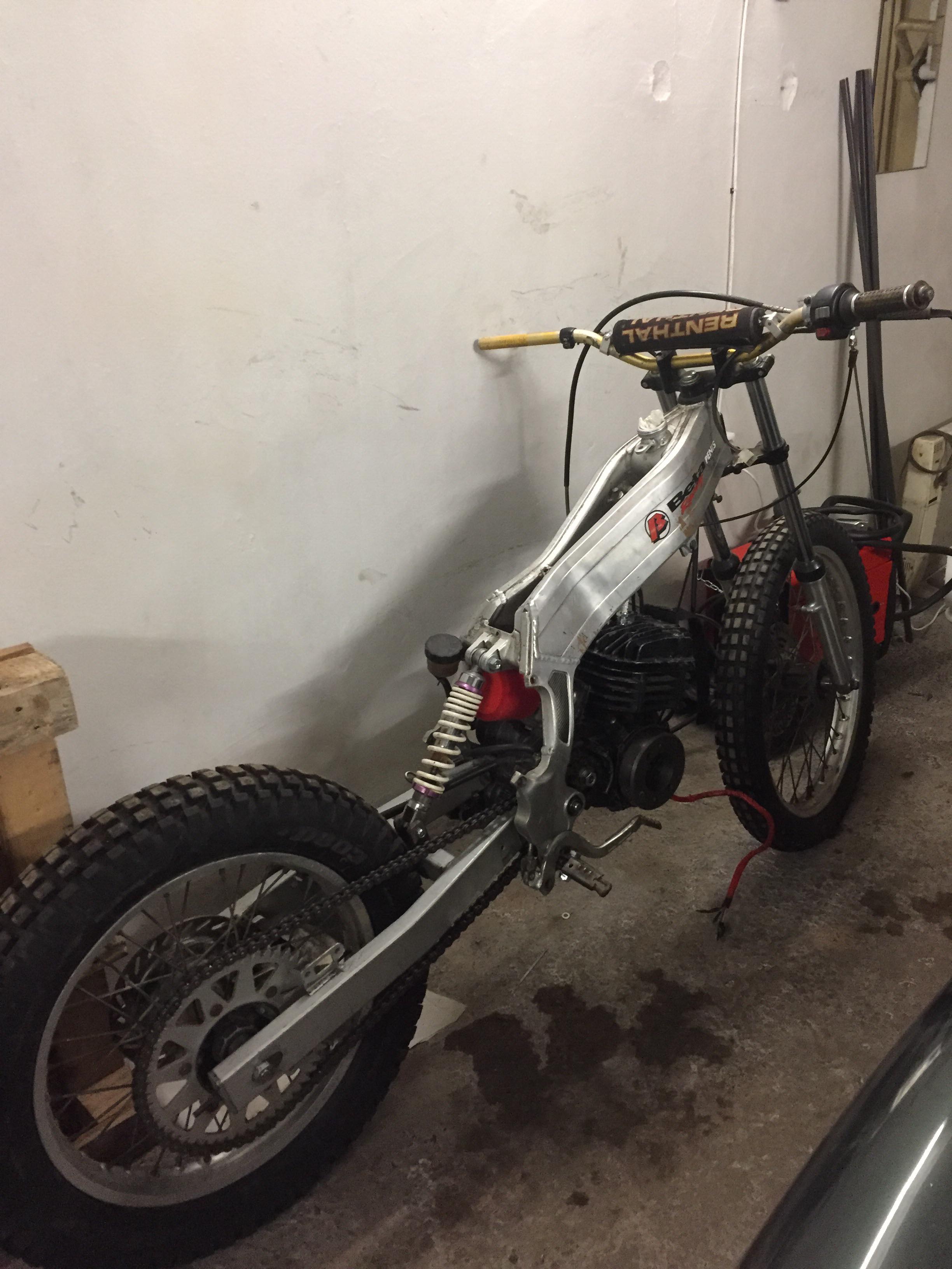

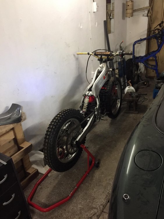

Finaly took the tyres up and got them properly on the rims, they´re straight now, will see how the tubless rear holds once I start ridin :D

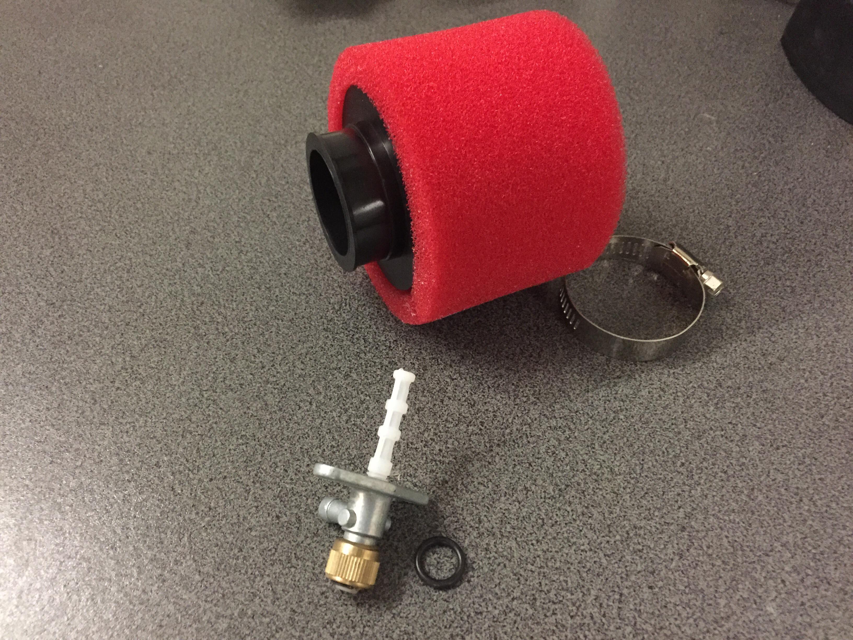

The fuel tap and airfilter arrived which fit just perfectly.

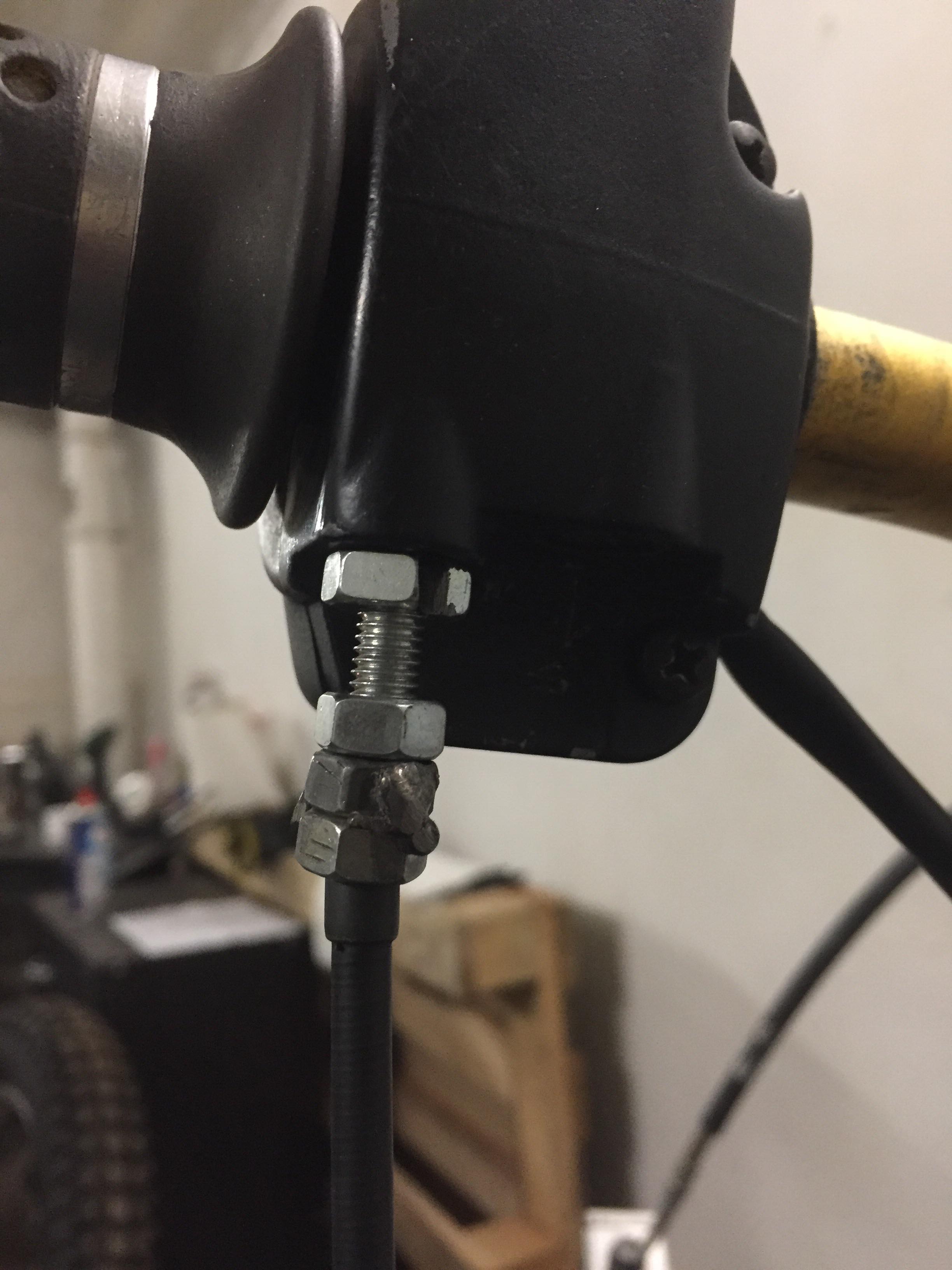

Had to start with the cables since I can´t get the flywheel off, so orderd a puller and a new clutch cable since the one I had is sticking like grazy and isn´t a good fit, throttle wasn´t also a bolt-on... neither is it nice but works good.
With a new chain the bikes starts to look like an actual motorcycle.
Hoping to sort out the motoplat, but still have the front engine mounts and an exhaust on the list.

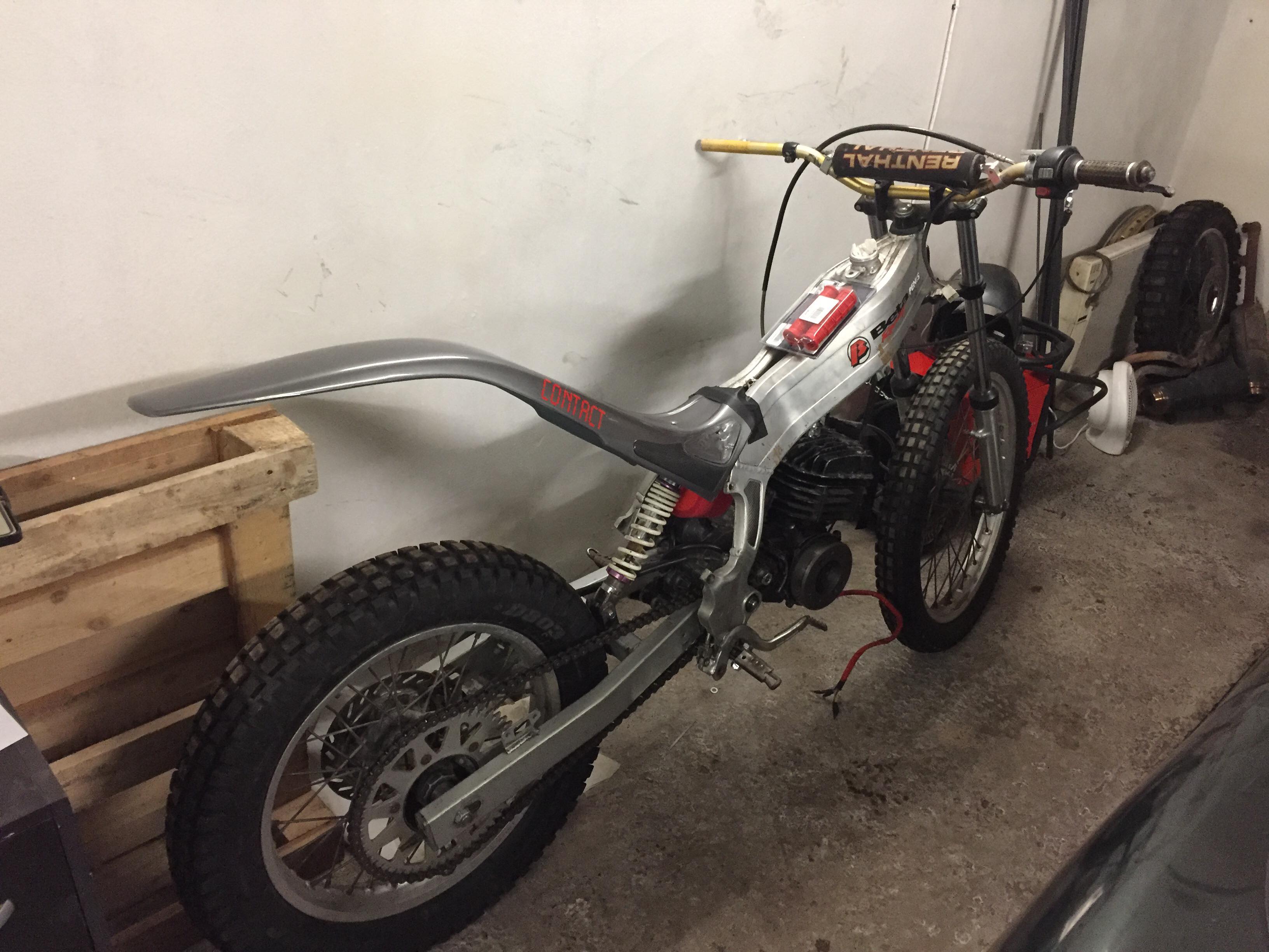

Raer mudguard from a GasGas TXT, will fit with some modifications so can start with the subframe and engine mounts. New grips and a clutch cable.

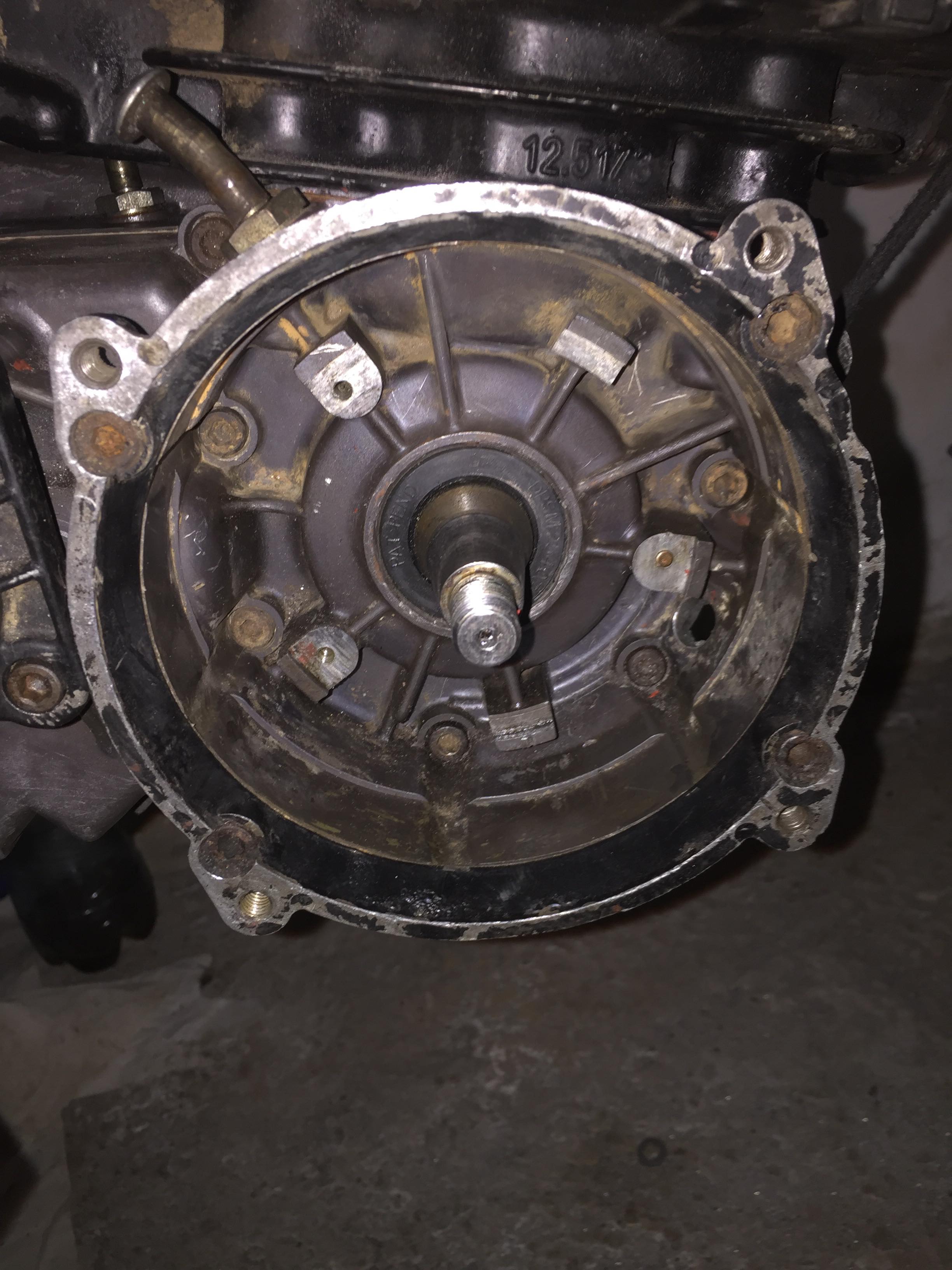

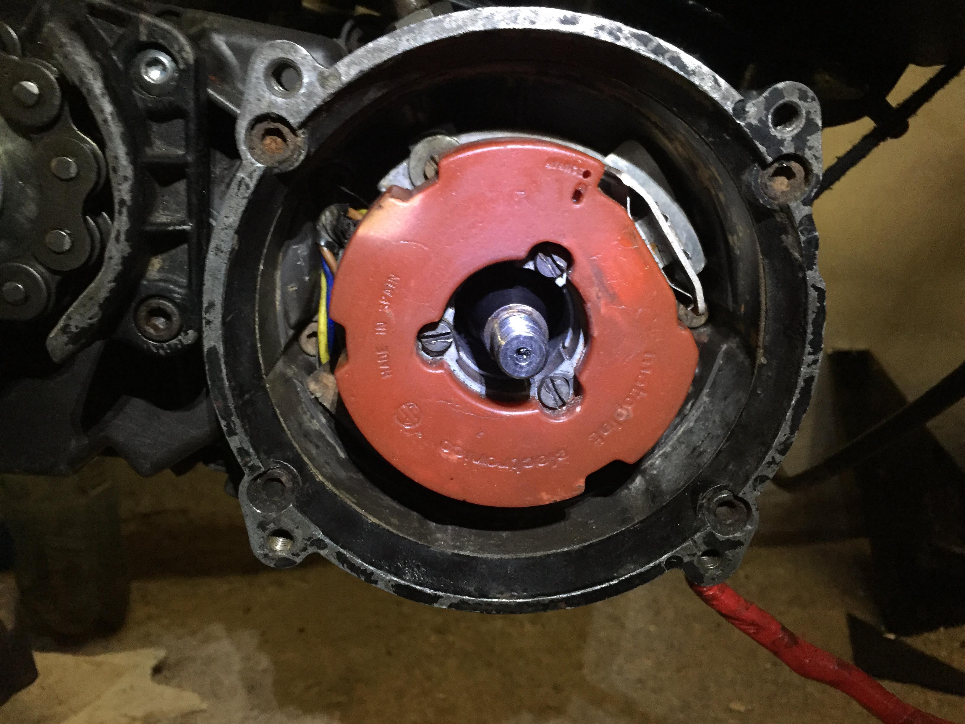

Still nothing from the ignition part, but I got the puller and seems like sombody has changed the stator, because it looks like there´s been some milling done there...

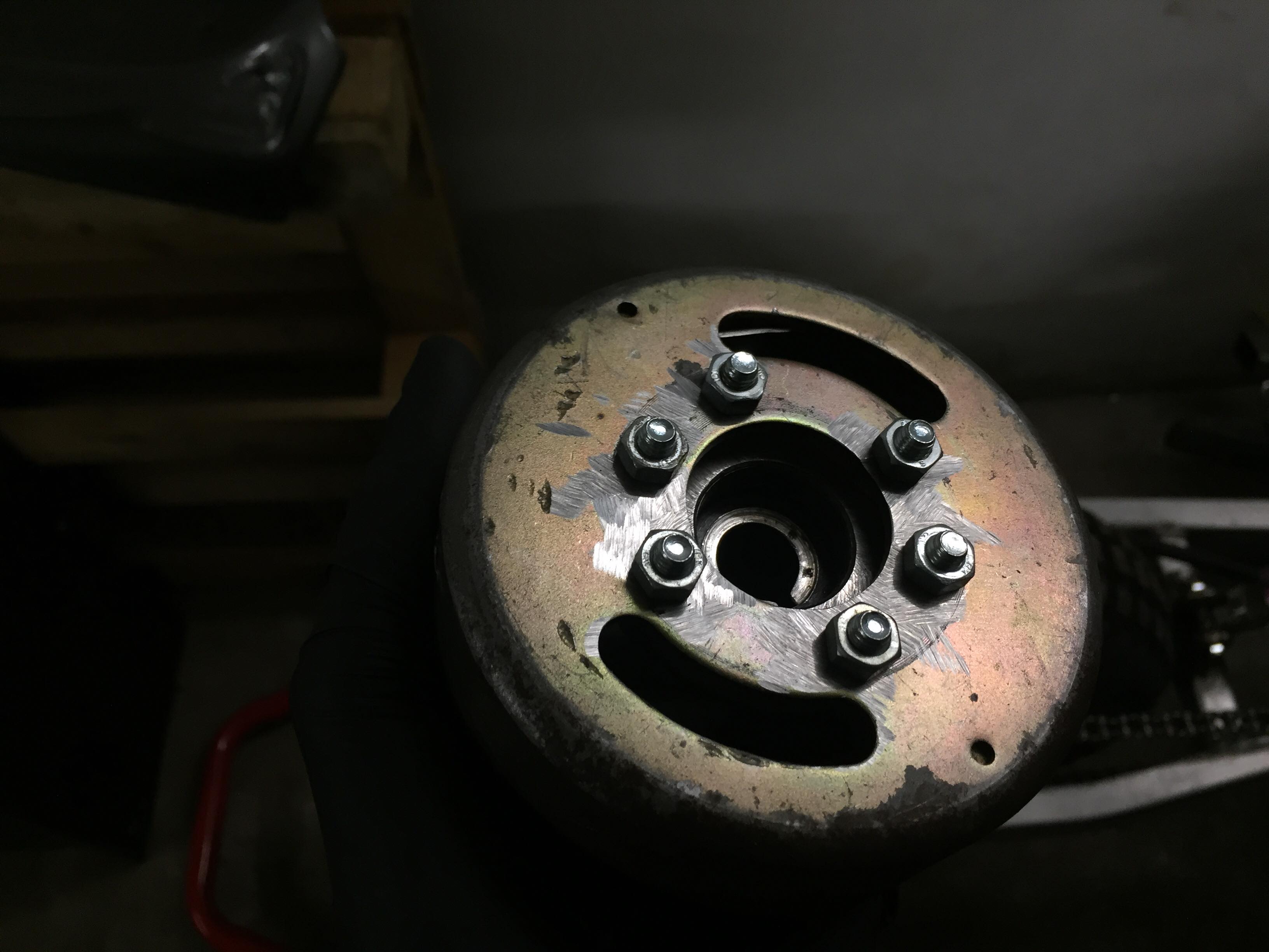

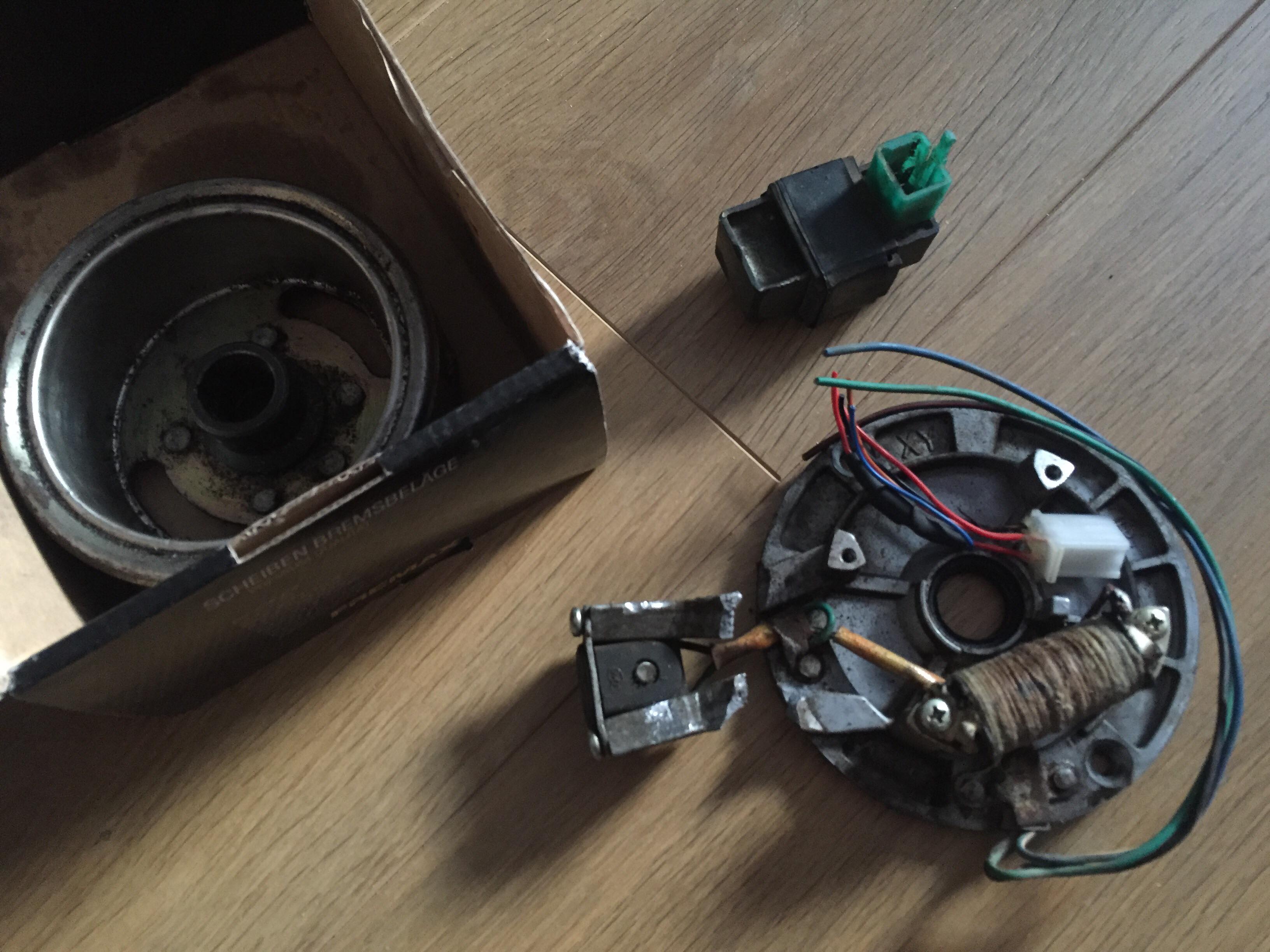

Didn´t get a change to visit the garage for a long time but today started working on a new ignition system, just thoughet it easyer and cheaper then messing with the motoplat!
Got a chinese pitbike cdi ignition and hoping to get it working though it will need some pretty seriouse mods.
Gonna keep the plate and had to also modify the magneto, because it woudn´t reach the cone.28580456_1673743849335564_1329998186_o.thumb.jpg.4b1d009f125e874630e60e2abb41bb5d.jpg

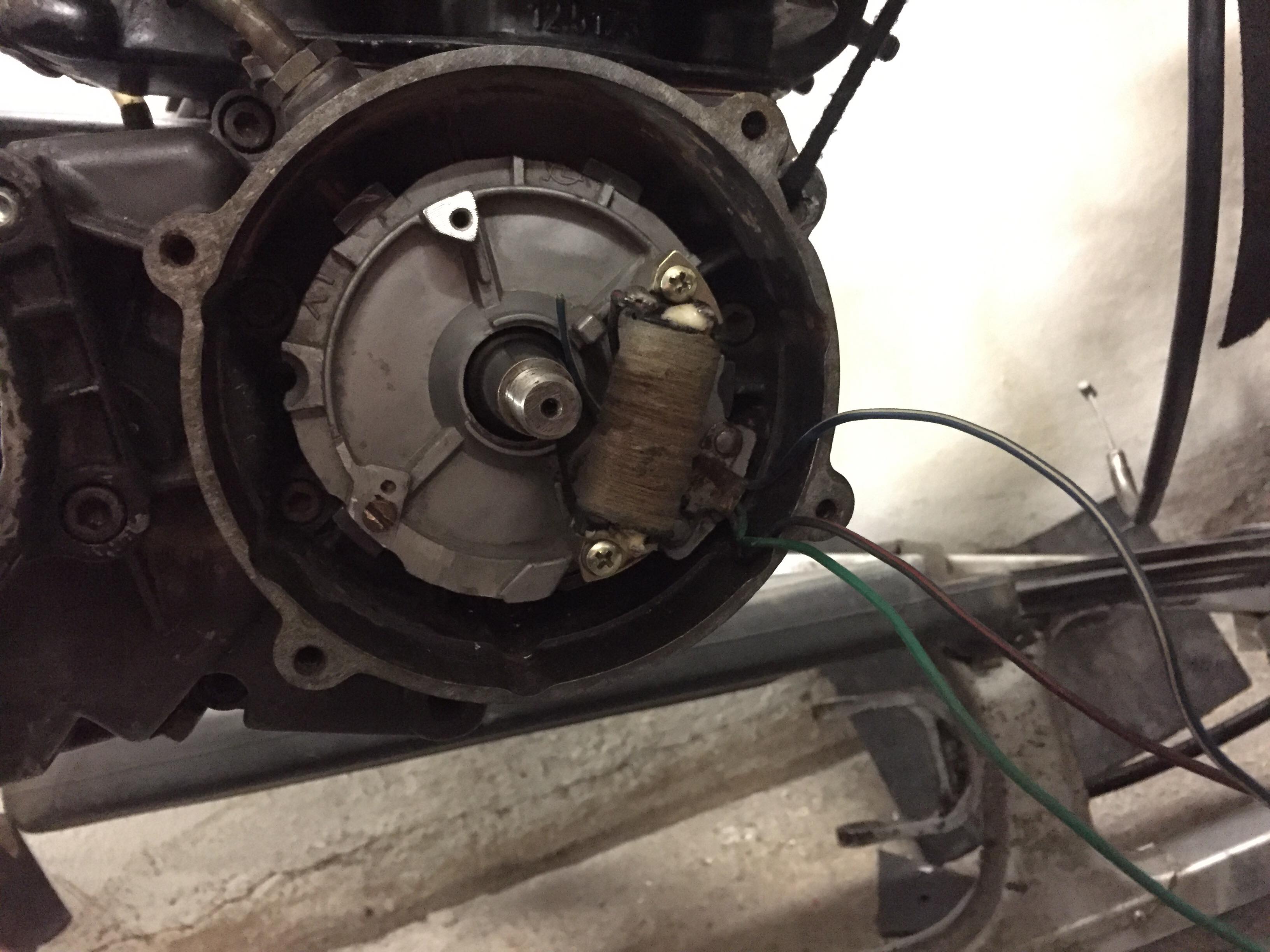

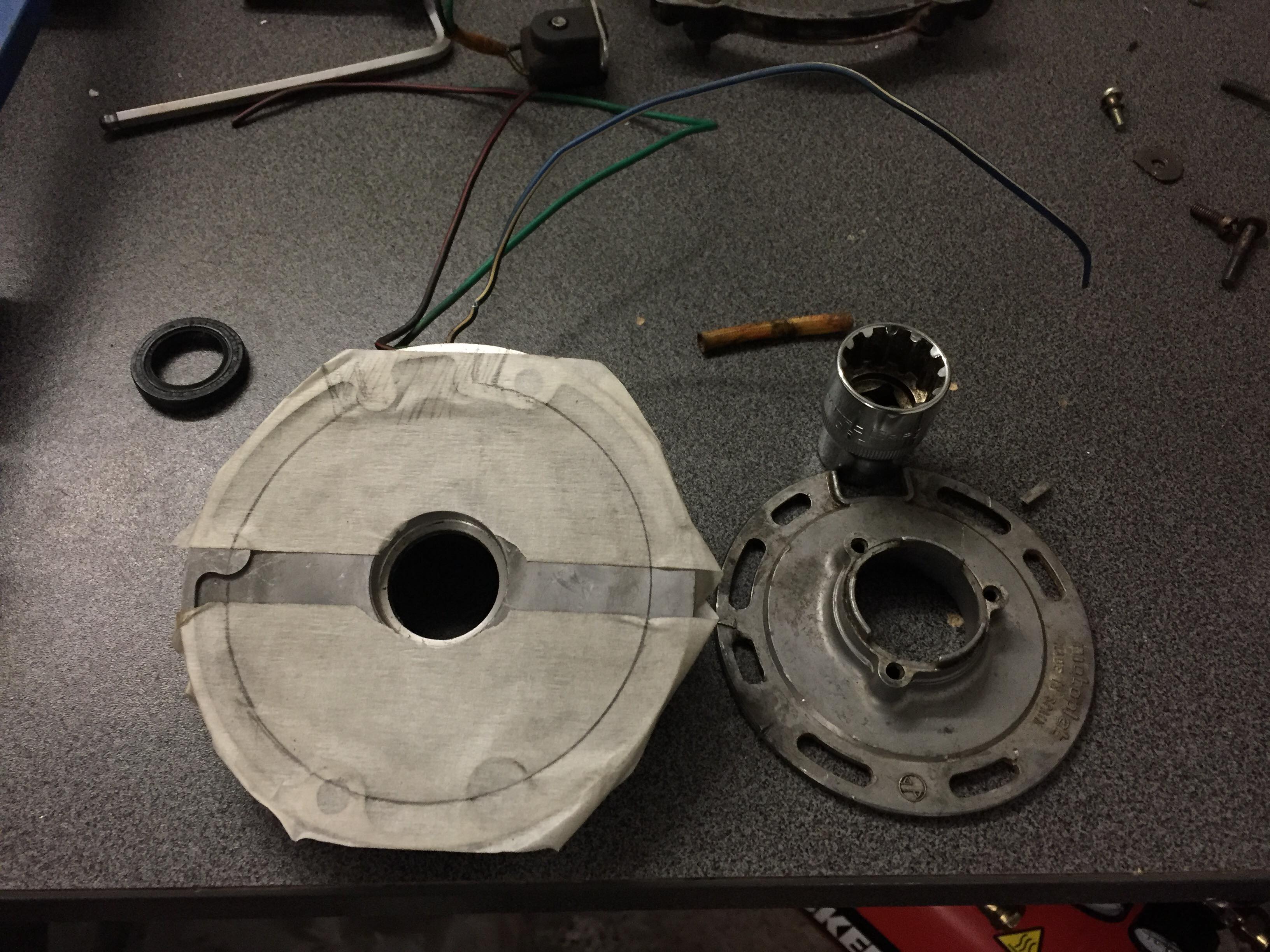

The plate is also taking shape but now comes the biggest problem, the ignition doohickey is external and doesn´t fit the housing!
28641240_1673743872668895_1650806746_o.thumb.jpg.2c732e2ac3076fea4f8d4fbfe1326e29.jpg

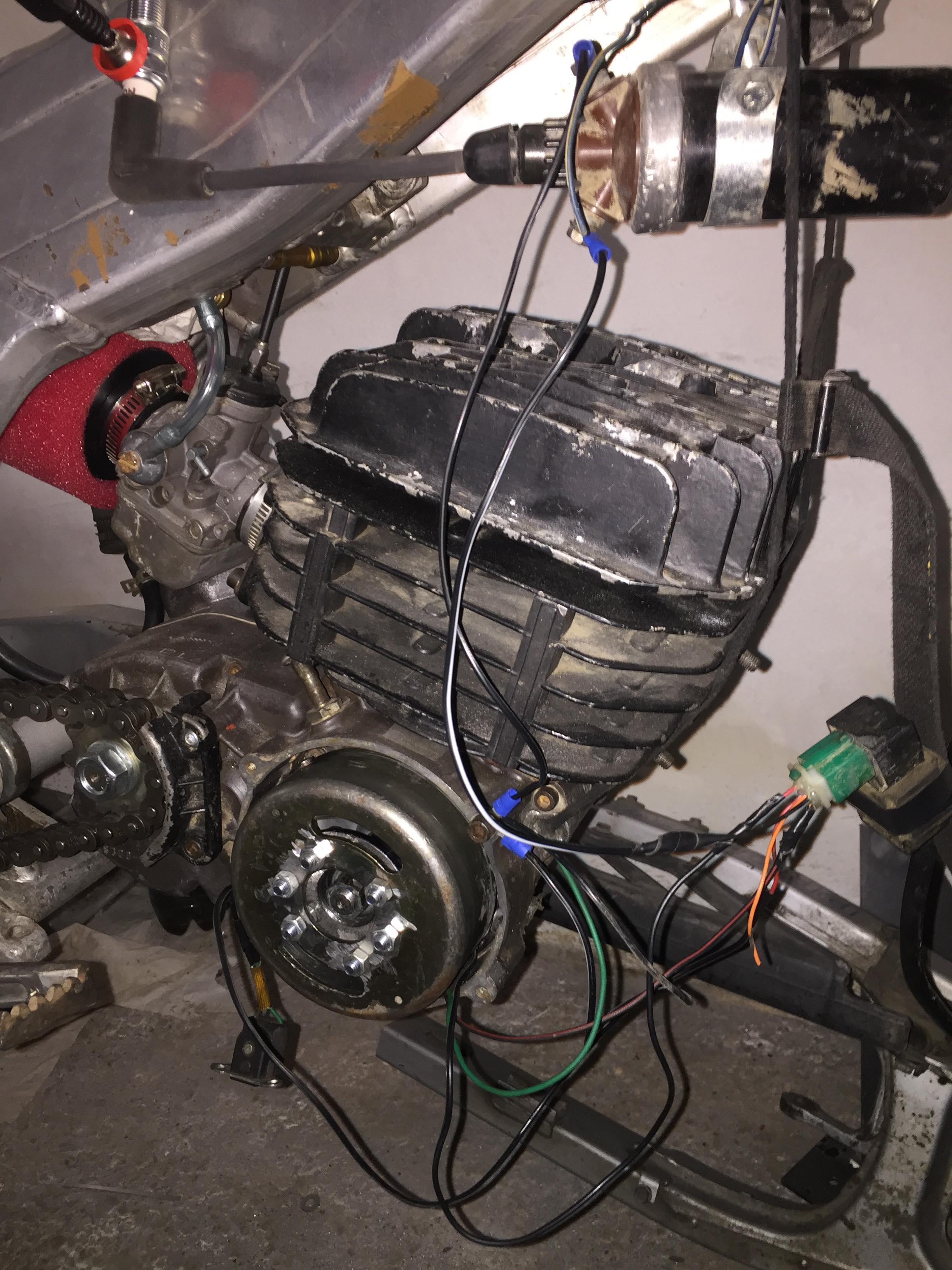

Good god I´m an idiot!!!

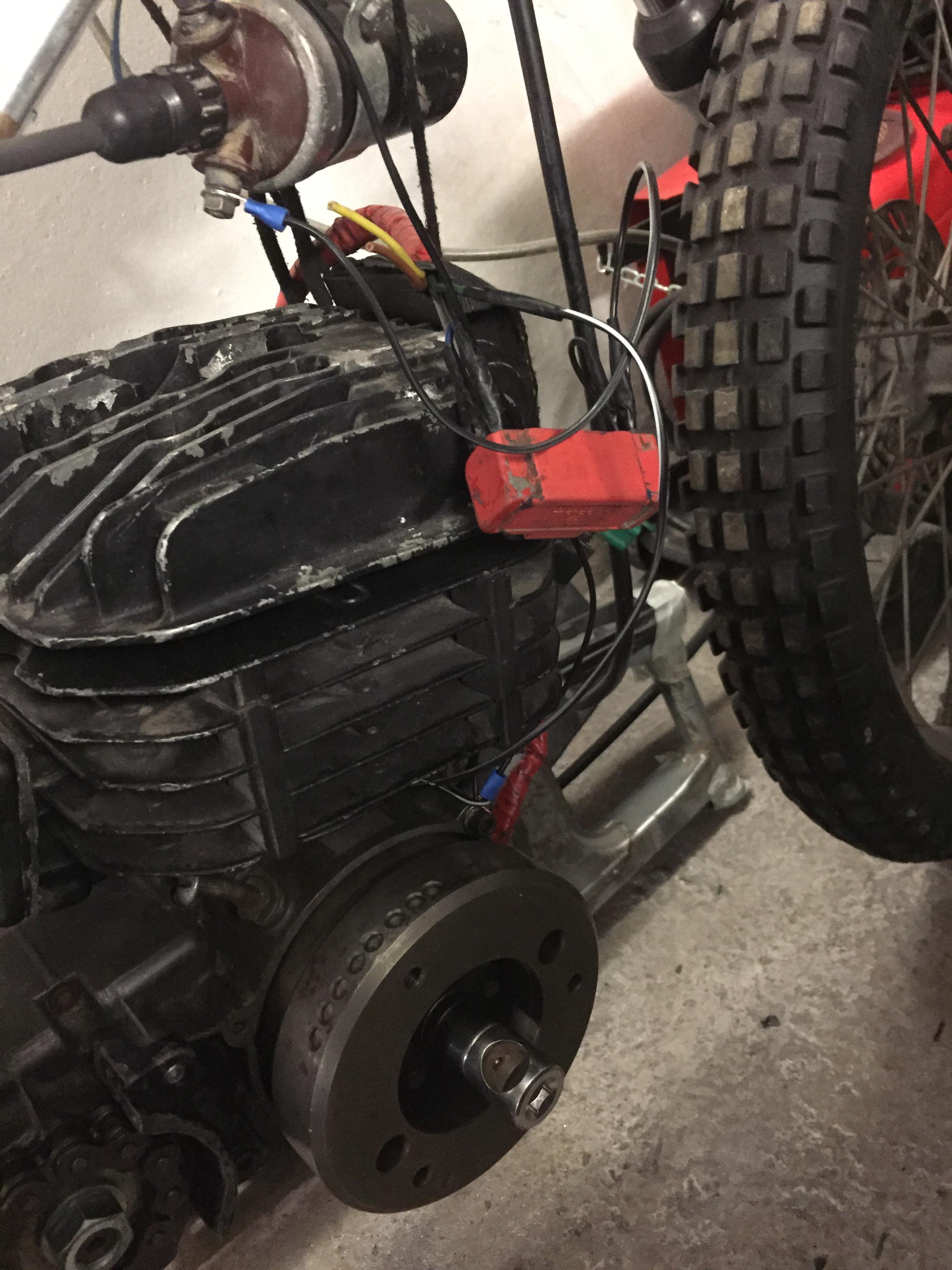

Got the chinese ignition working and had a feeling I should try the motoplat again before gutting up the engine, because the impulse generator woudn´t fit otherwise.
So after taking it all apart and reinstalling the original parts I discovered I hadn´t attached the green wire previuosly and well, that was the ground for the stator ....<_<
Wasn´t sure but had to give it a go and this time I made a 17mm socket fit a drill and when I got the engine spinning there was a beautiful spark!
28755398_1678703712172911_1911328058_o.thumb.jpg.76ef090aeabf260ef316ff59ae5197eb.jpg
Unbelievable how stupid I could have been, so now, I´m gonna tighty up everything, set the ignition and make the front mounts!

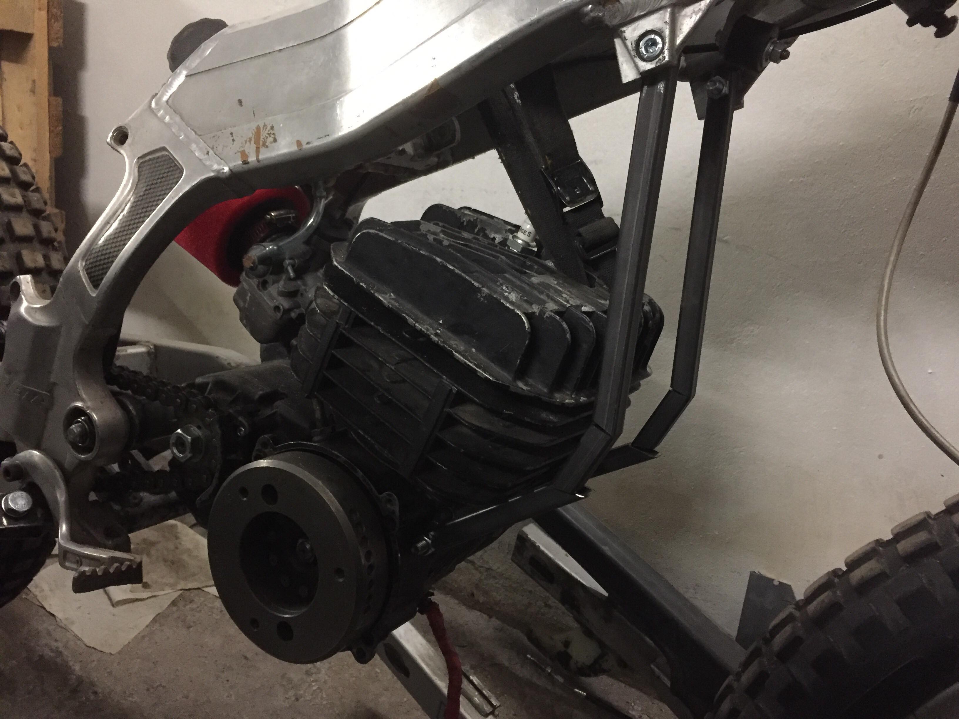

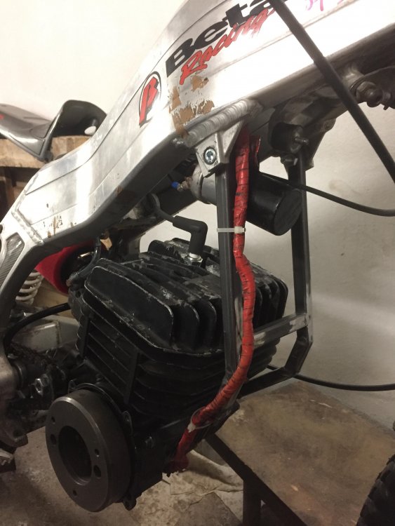

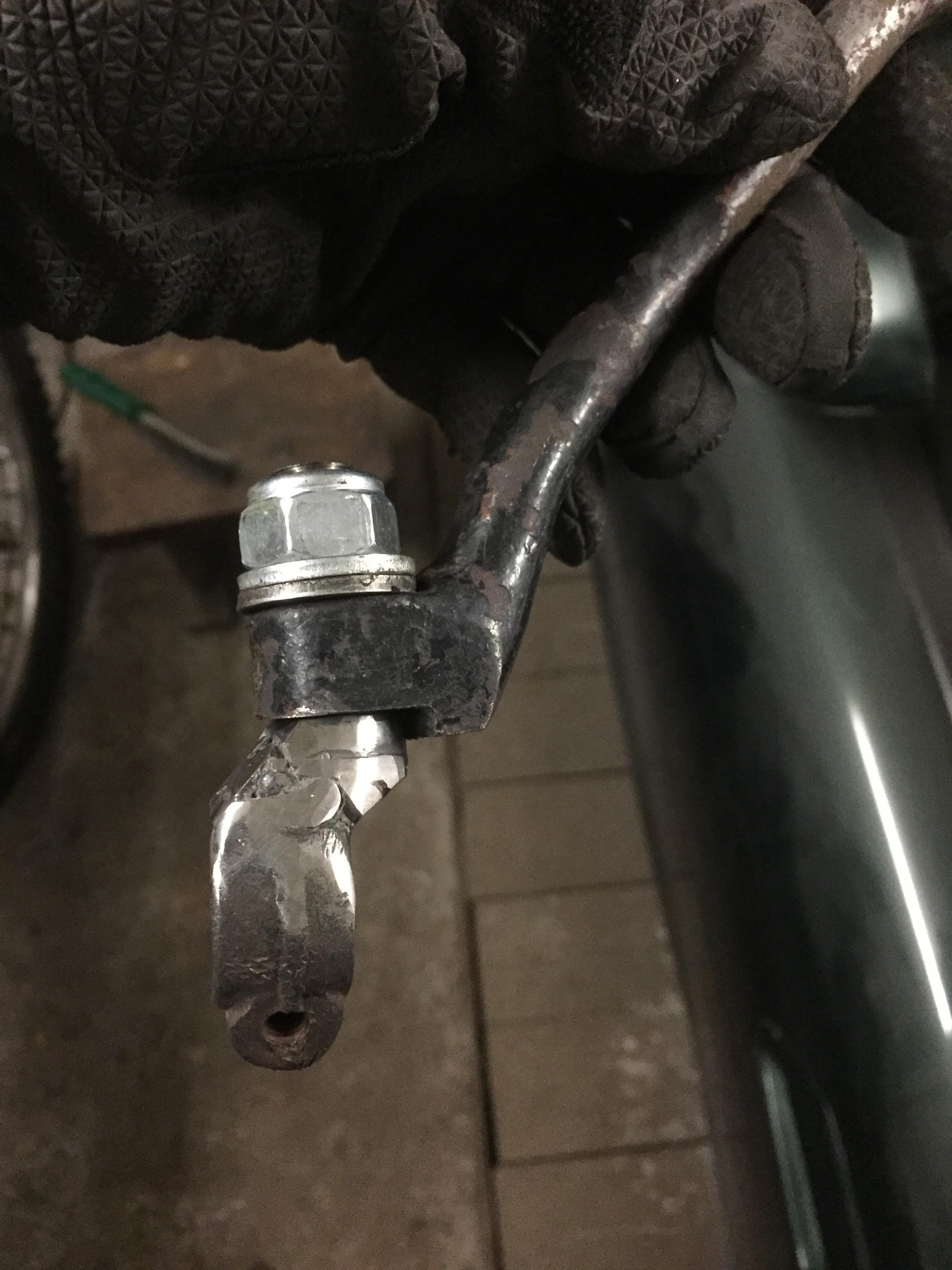

Was away for almost half a week and today was a short one, so made the kickstarter fit and tacked the front mount, hoping to get it running the next time I´m in.
29136326_1686377908072158_1804616666458357760_o.thumb.jpg.38614ef484af104a879aeb7950dd0b2f.jpg29196675_1686377921405490_5876670547001081856_o.thumb.jpg.c68757cd0f381ba4d7df4e673906daa7.jpg
So close, but still so far :)

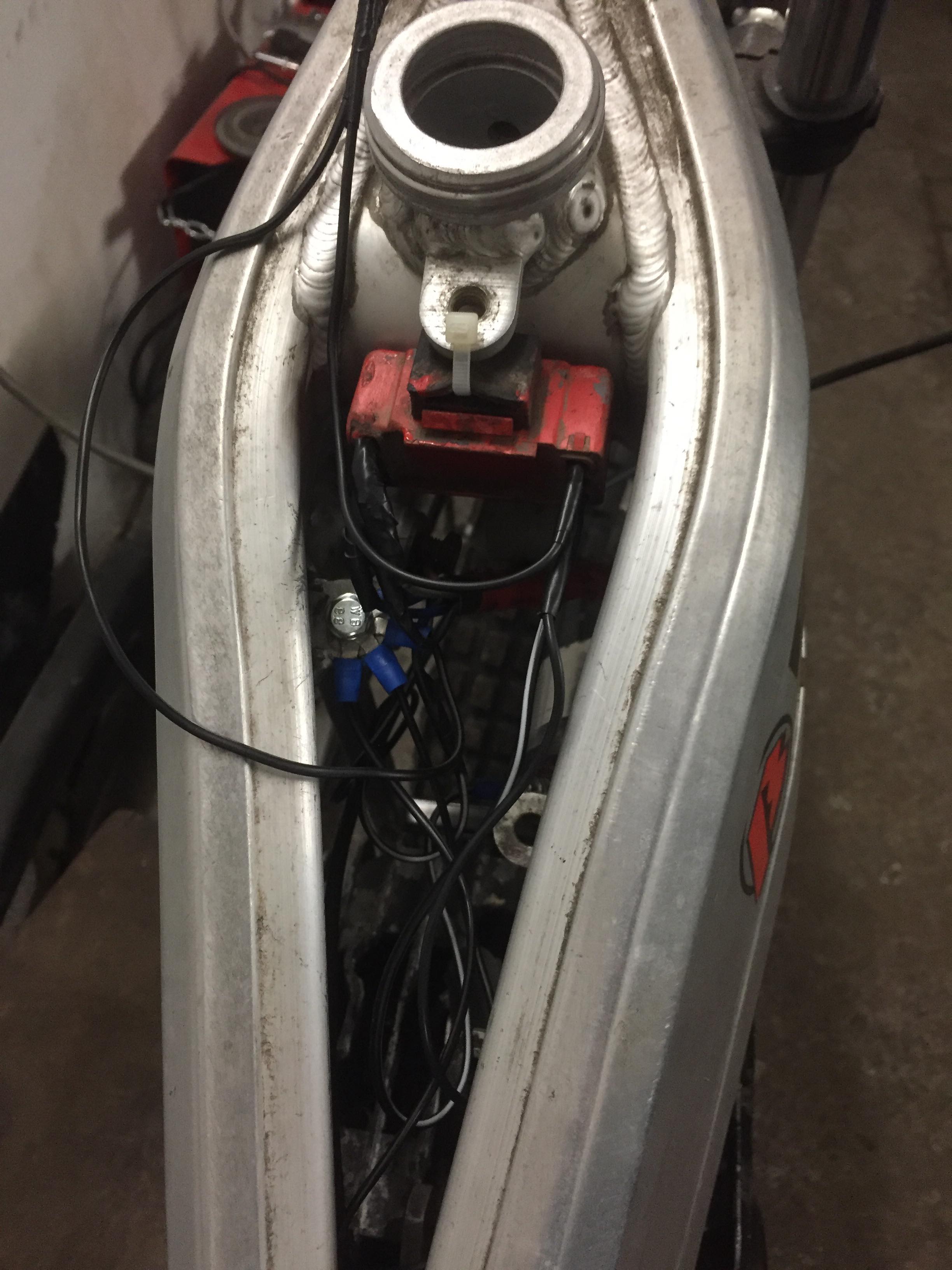

Buttoned up the engine mounts and got the wires routed, I´ll add some plugs and a propper wiring once everything is working.
Also made the starter button a kill switch, and made the clutch cable fit but I don´t have enough movement for propper disengagement.
The last owner made the linkage longer, so I´ll have to return it to a shorter version.
Still didn´t get it started and without the clutch I couldn´t push-start it either, can´t get enough grip on the concrete, once I get the clutch working I´ll take it on a field nearby or something like that!
29214057_1688561554520460_5737981423038496768_o.thumb.jpg.4983083290bc2b04103217621af6dc54.jpg29216652_1688561521187130_2852436687789752320_o.thumb.jpg.02bcfef4e213b0814a158565051e9c25.jpg

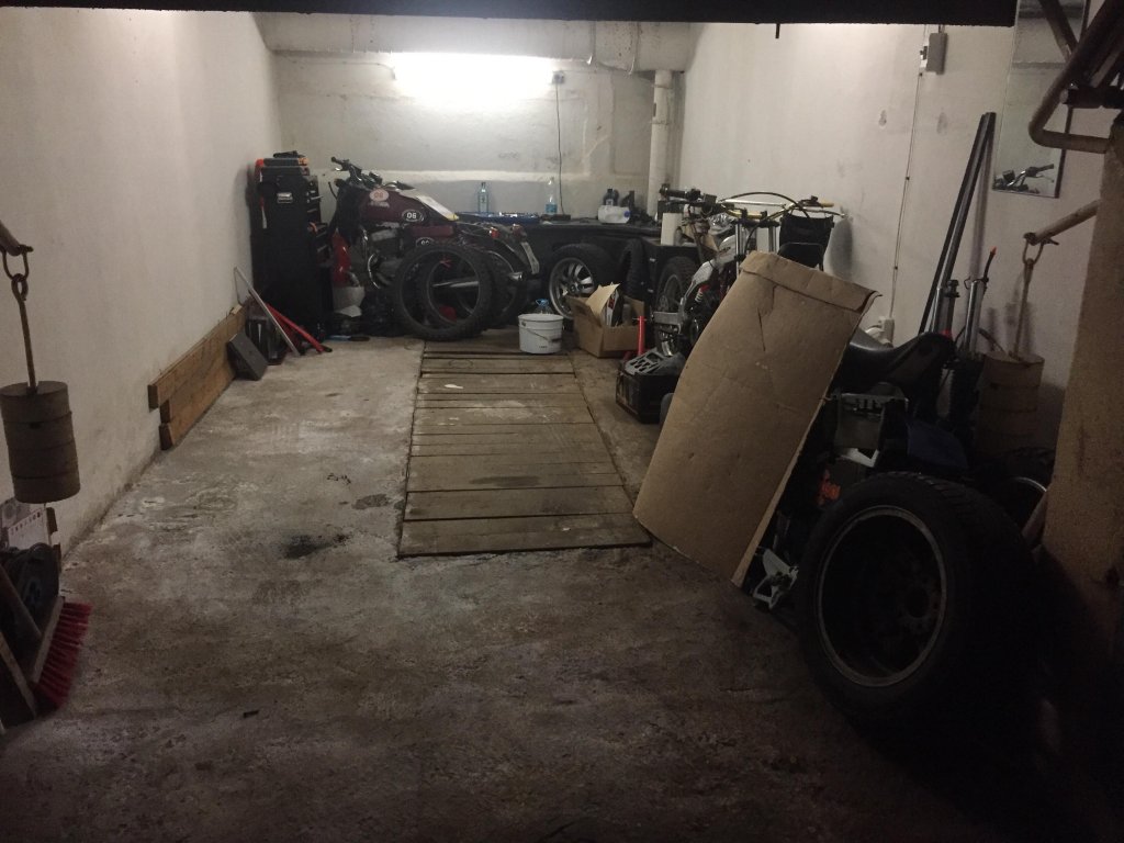

But, there´s heaps of space in the garage now, though I also have to rebuild the tail on my Jawa, because we´re going on an anual oldtimers ride in the end of this month.
SOOOO, a small brake from the Beta but will be getting back to it as soon as possbile.
30652813_1720445627998719_5939601043477233664_n.thumb.jpg.43a2d334a8f65e4f904b19651fbd8107.jpg
ALL THE SPACE!!!!

Filled the gearbox with ATF and hopefully it will start working, so as soon as I finish the exhaust I´ll try to get it running before building anything else (maybe just the subframe so I could push-start it)

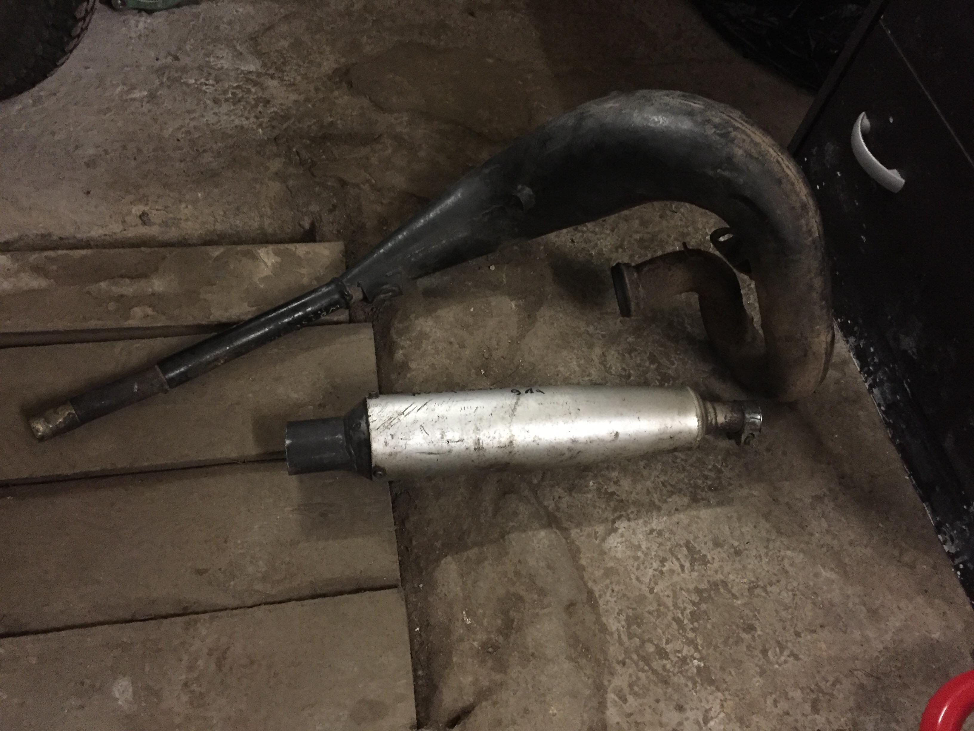

Made an exhaust flange from 5mm steel and cut up the donor pipes.
51492393_556341488176242_6745976373002633216_n.jpg.b96cc82987fbe81b152291dfe4c333d0.jpg
Now it´s starting to look like something...
51509279_622248771575800_9079451522466578432_n.thumb.jpg.7f6382a1efdae3749fed426ac53bb968.jpg
50910817_804901679843357_2884718572519555072_n.thumb.jpg.42d80101513b735a420658e928789c1e.jpg
Just need to properly weld it up and make a bracket or two and deal with the muffler once the subframe is finished...

Excellent work, (thought you had been abducted !) exhaust as shown might lack bottom end power ?
