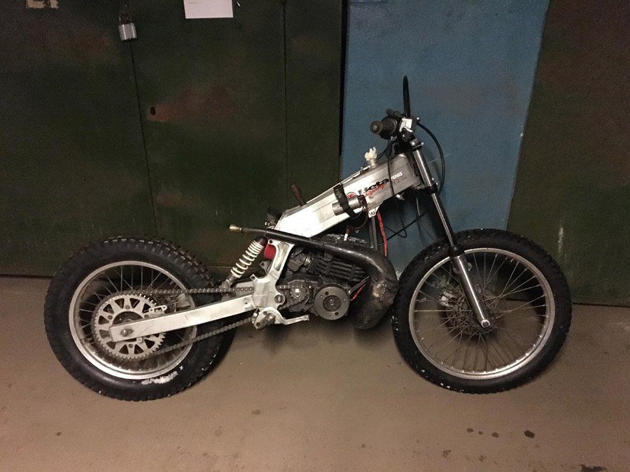

  • Place is starting to take shape with the bike... today I got a Telwin, going to need a welder for the engine mounts and rear subframe and pretty sure it won´t end there. Just need a new balloon sinc
  • Finaly something is happening Today I started with the tyres, put on a new rimtape and inners + used Dunlop D803´s Although forgot the soap and didn´t really have the right tools so one sid

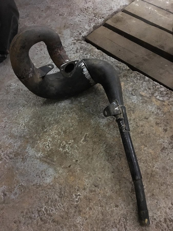

Finished welding the exhaust today and once this was finished started playing around with the engine.

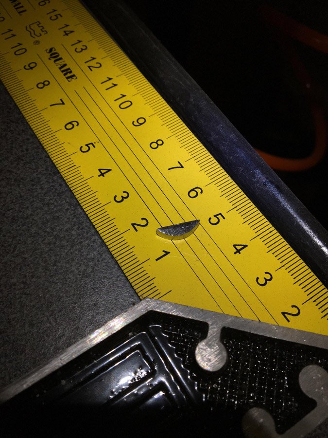

Turned out the flywheel came loos and also snapped the wedge so REALLY enjoyed making a new one -_ - smallest piece I´ve ever fabricated :D

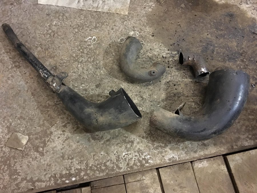

Made an exhaust flange from 5mm steel and cut up the donor pipes.
51492393_556341488176242_6745976373002633216_n.jpg.b96cc82987fbe81b152291dfe4c333d0.jpg

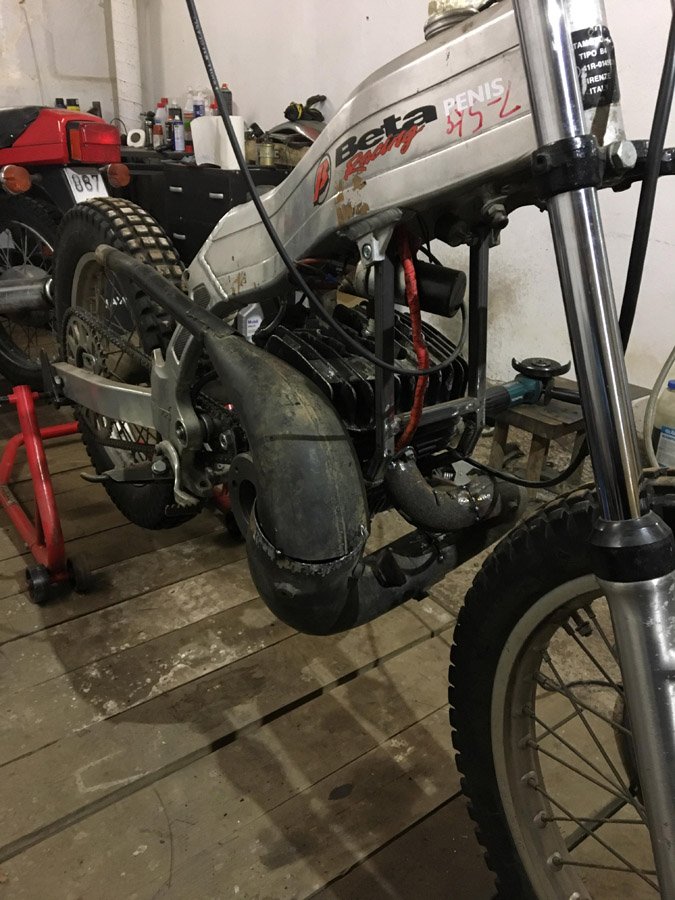

Now it´s starting to look like something...
51509279_622248771575800_9079451522466578432_n.thumb.jpg.7f6382a1efdae3749fed426ac53bb968.jpg
50910817_804901679843357_2884718572519555072_n.thumb.jpg.42d80101513b735a420658e928789c1e.jpg
eJust need to properly weld it up and make a bracket or two and deal with the muffler once the subframe is finished...

Taking it apart I broke the flywheel alinging pin again! Don´t know what material I should make it next but hopefully another steel one will work now :)

Sounds very odd. That key shouldn't see any force if the taper is holding properly
If he's trying to torque the flywheel nut by a method other than holding the flywheel then he might be shearing it off while tightening the nut. And twisting the crank out of alignment too. I'll say this, he's got guts for even trying this. That expansion chamber's going to have a very strange effect with the trials engine porting.

No, I´m torquing it by holding the flywheel from the holes drilled and tapped. I´m not going to be really doing any seriouse riding with it, just want to finish something I started almonst 10 years ago! And planning to buy a proper factory built bike once I get this build sorted :)
Yes it´s shouldn´t but the original cracked when I forgot to tighten the flywheel and got it started the first time... so had to make a new one but I´m guessing it´s just isn´t strong enough, will try with a new one tomorrow!
