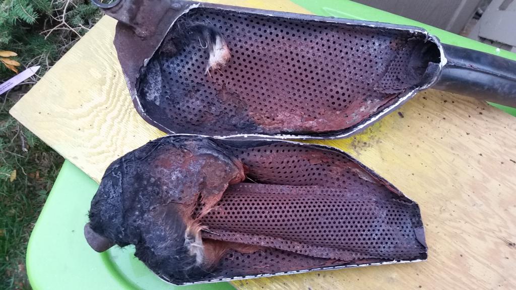

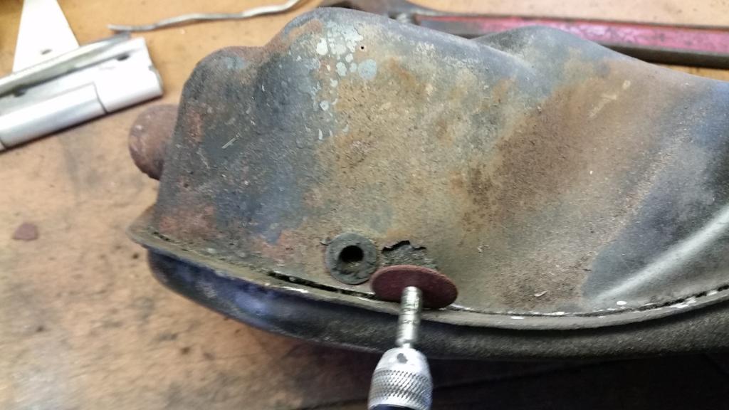

November 3, 20169 yr Had a spare exhaust that was in rough shape. I had burned the sludge out last year when doing another one. I opened it up today just to look. The pics show that the packing was pushed to the back but the perforated holes are clean.
