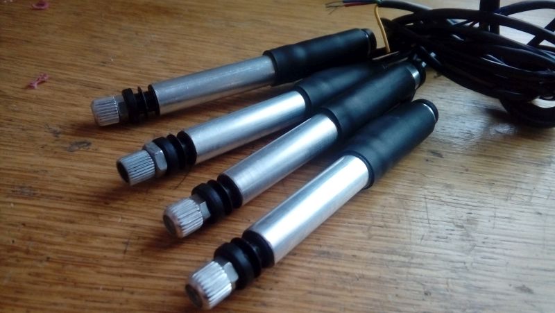

I have a mechanical mod that I have developed that replaces a pure e-bike throttle with a cable throttle of choice and can also fit stiffer or softer springs to the mech so the feel can be customised so that it behaves 100% like that of a gas bike but also puts the sensor for the throttle well away of any possibility of getting damaged , I have never found a good ebike throttle that I have been 100% happy with thats why I designed my own :-) .
This is v2 , and still being tested for reliability.

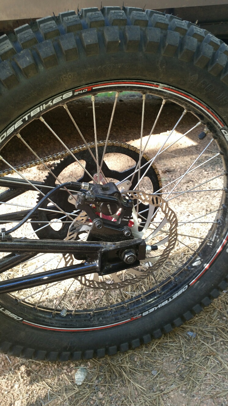

The small rear tire does not have enough feel and flex for our muddy PA rocks. I ordered the Oset  bigger wheel yesterday. $375 plus shipping. I searched online for a 17 x 1.6 rim, but only could find 32 spoke, not 36 spoke. A custom rim would be about $275, $100 for the tire and $50 for the spokes, so the Oset complete wheel is the better deal. Maybe someone will be looking for the smaller someday. At least I will have a spare sprocket and rotor.

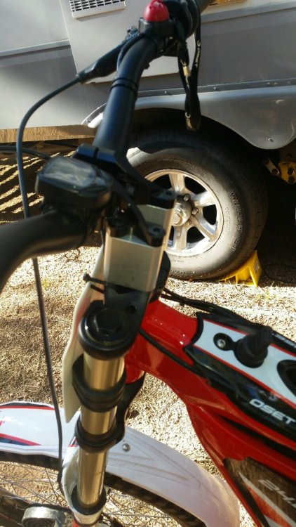

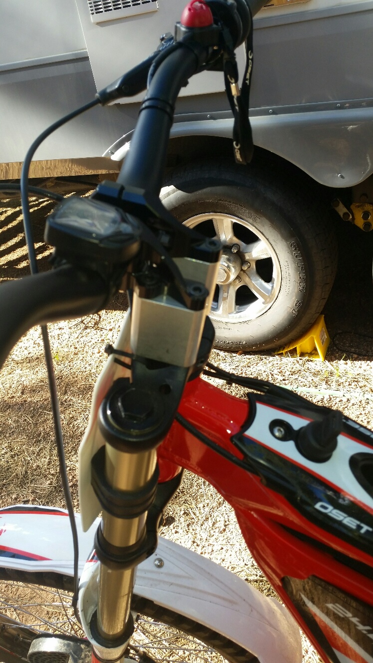

I raised my bars 1 inch at first and then machined risers to go 2 inches. This feels much better and puts the bars at the same height as my Beta. I am 5'9". My dad is 6'1" and I made a two inch pair for him also. He really thought this made a major difference.
These are mountain bike forks,bars and stem but I could not find any risers over about 1/2 inch to buy.

Did you just make a spacer to raise the existing handlebar mount? I was thinking about making new clamp base to move the bars ontop of the triple clamp and use the stock top clamp. Haven't checked to see if I have an end mill close to the bar size.

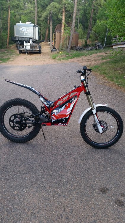

Here are some pics of the modifications made.
Two inch handlebar risers. These will get more machining to make them look "trick".

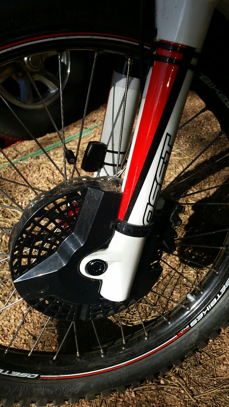

203mm Brake discs front and rear

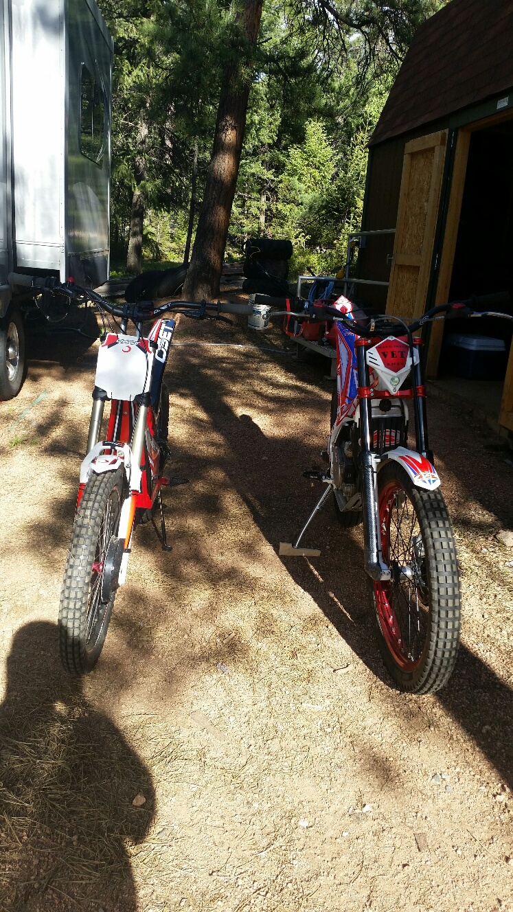

Side by side with Beta 300.
I got my new wheel Saturday. It didn't come with rotor or sprocket. The sprocket hub on the original wheel doesn't want to come off. I stripped out all the bolts I tried to remove. Even with some heat applied. I tried to drill one out. The countersunk head seems to be soft while the threads are hardened. Couldn't drill into the threads. I'll see what Oset says tomorrow.
