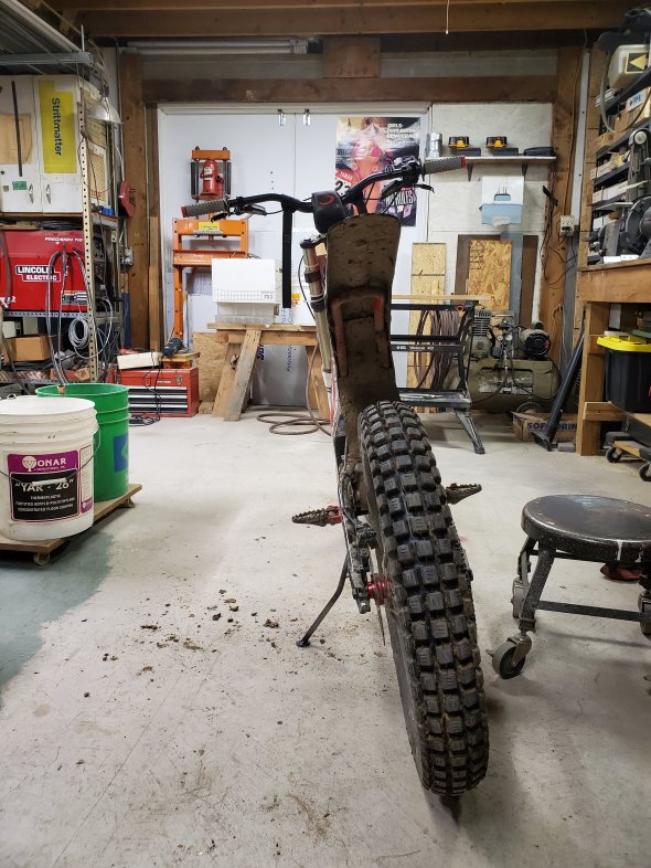

  • Finally got around to making a new kickstand and mounting bracket. Now I don't have to worry about a gust of wind blowing it over. Also, at my weight (165 lbs), I put a lighter spring on the shoc
  • I've been riding my Oset 24 in my backyard stop and hop style and the battery lasts longer than my body. I can do 3 one hour sessions on one charge.

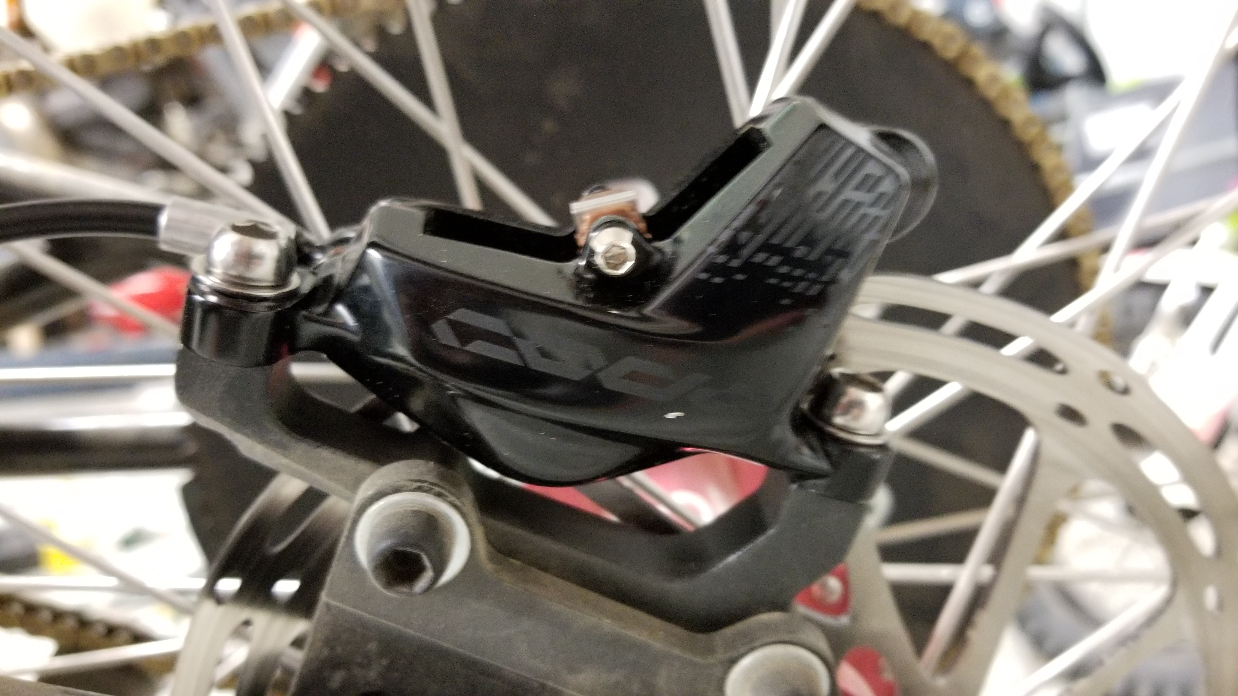

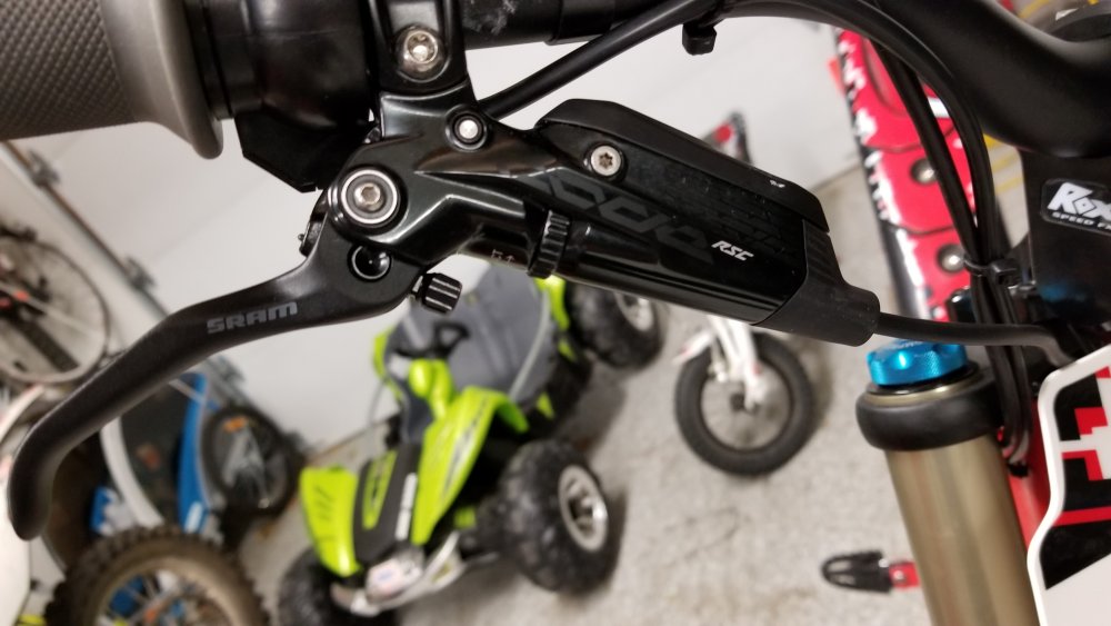

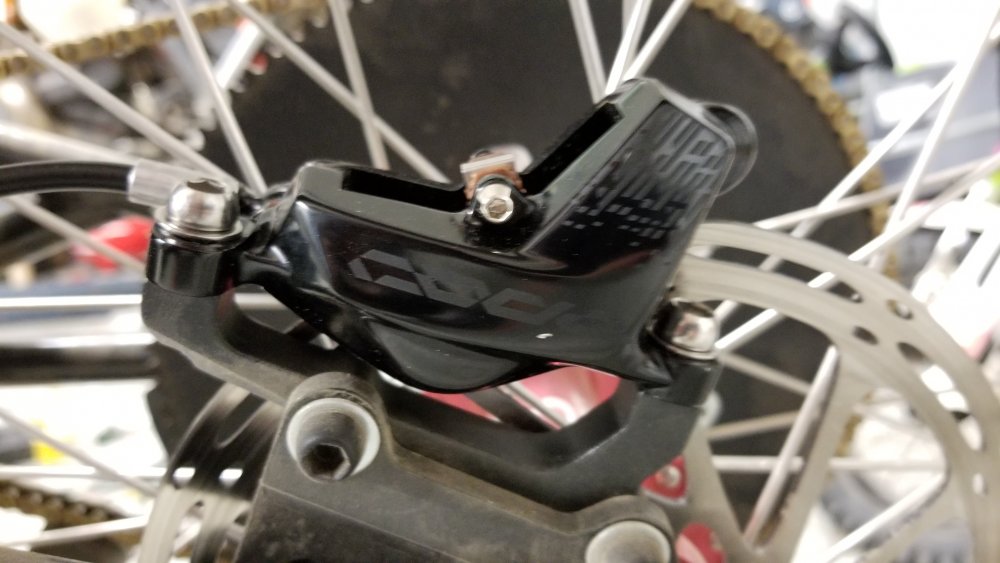

I also just installed a set of SRAM Code RSC brakes using the stock 180 rotors.  PLENTY OF POWER  and really nice brake modulation.  This is a expensive set at $480 but really one of the best you can buy for a mtn bike brake (two piston caliper).  The RSC has adjustable pad engagement which I really love.  This bike needed more clinching power, not bigger rotors.

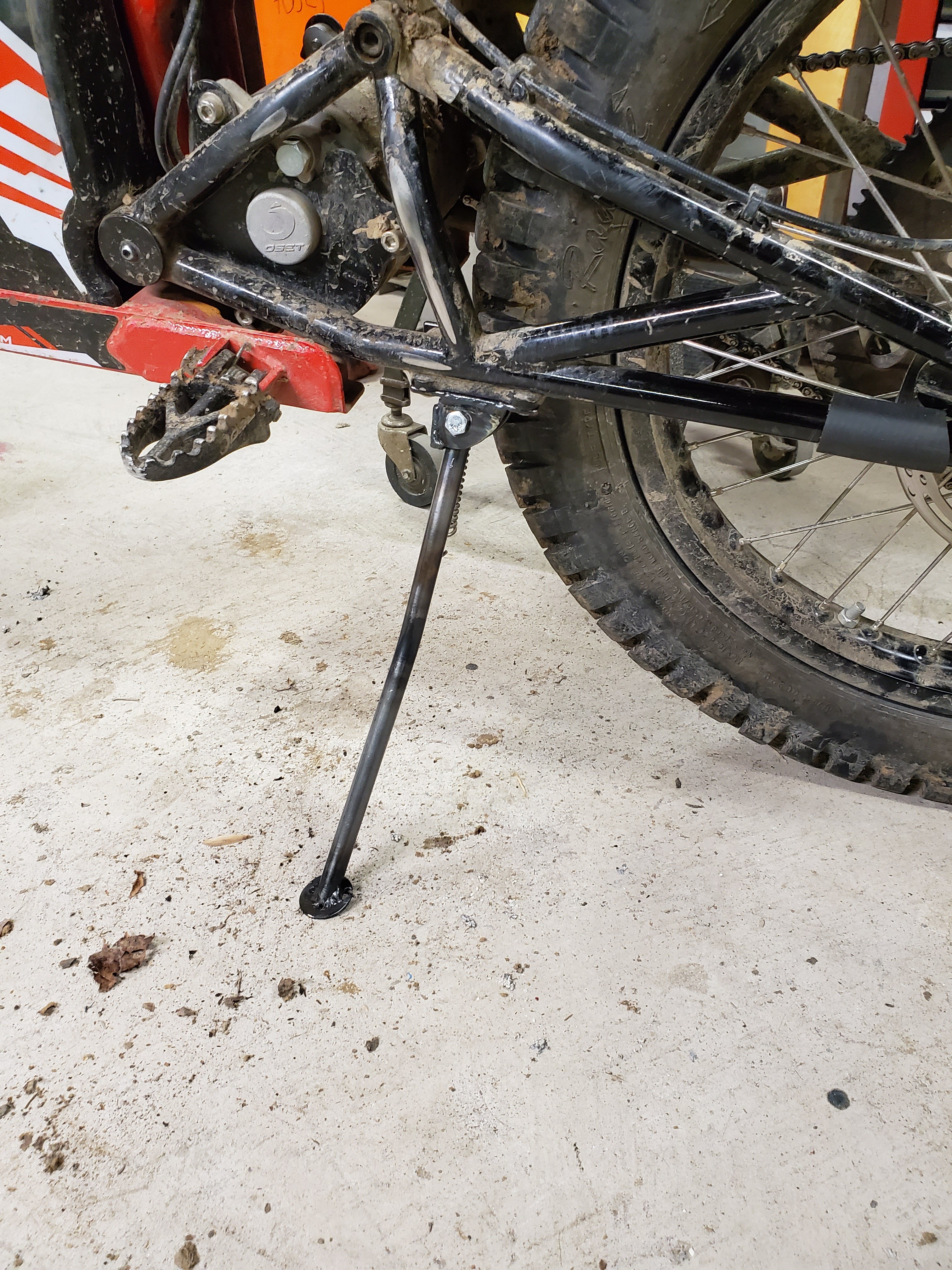

Also, at my weight (165 lbs), I put a lighter spring on the shock and in the fork. Traction is much improved.
