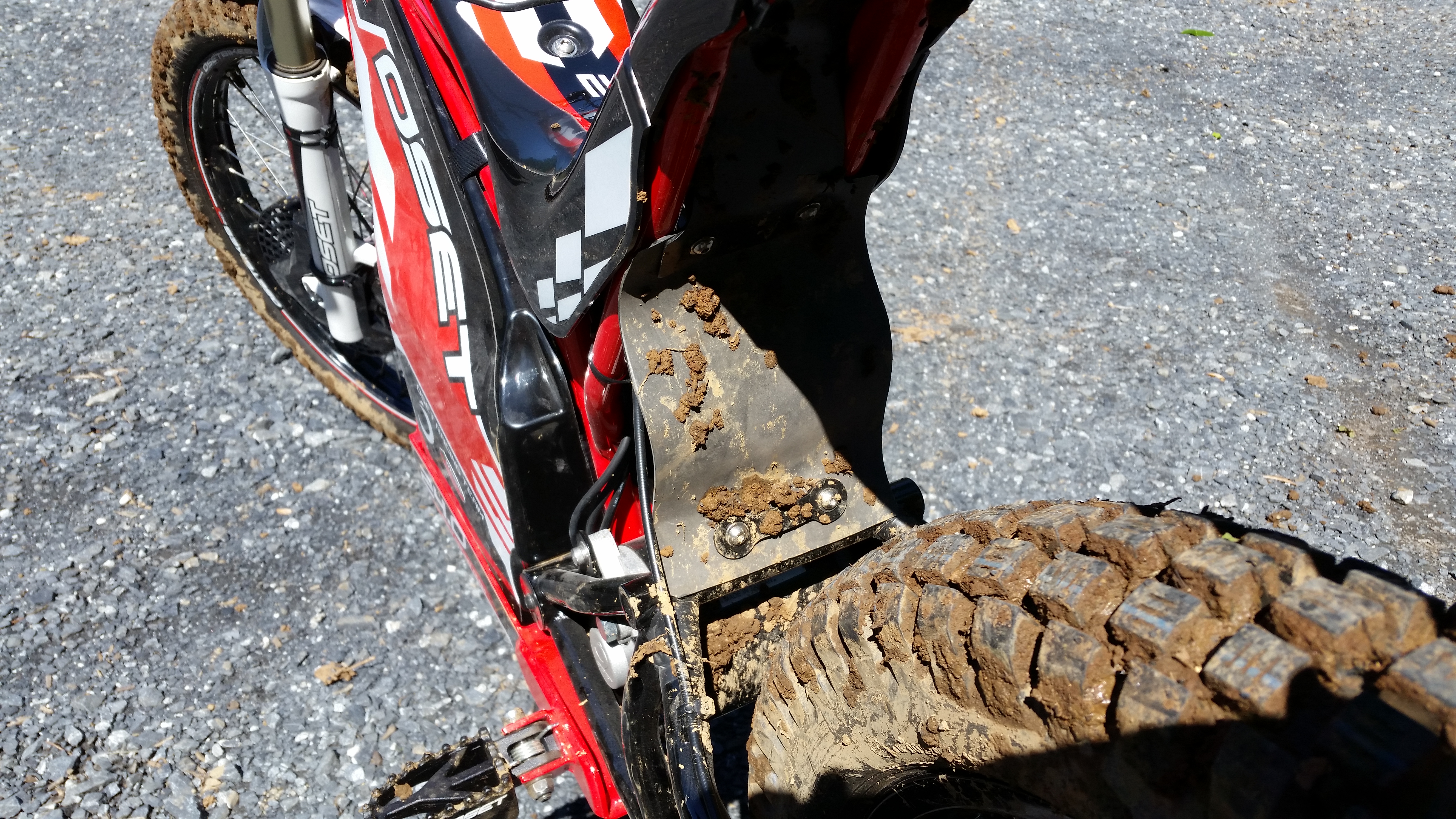

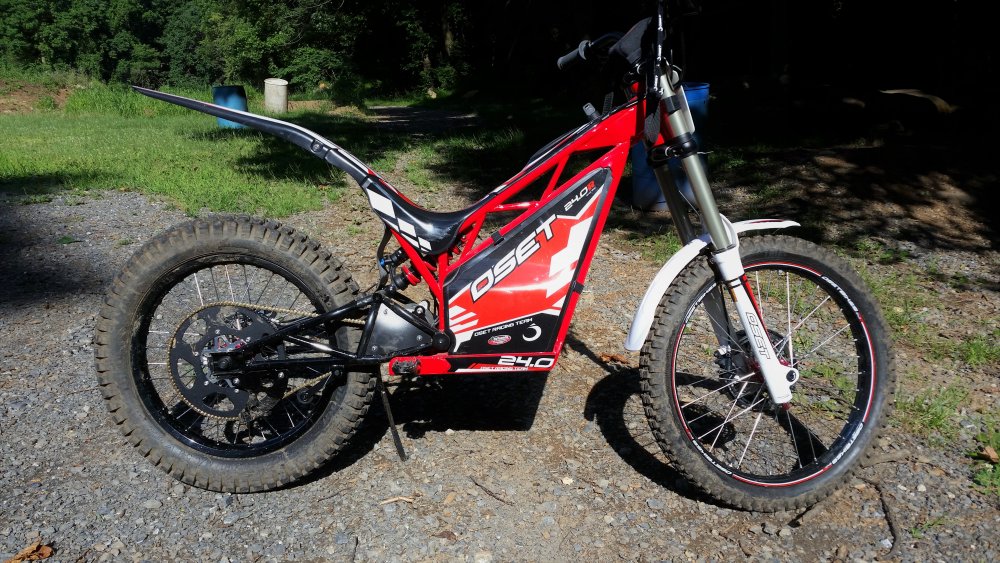

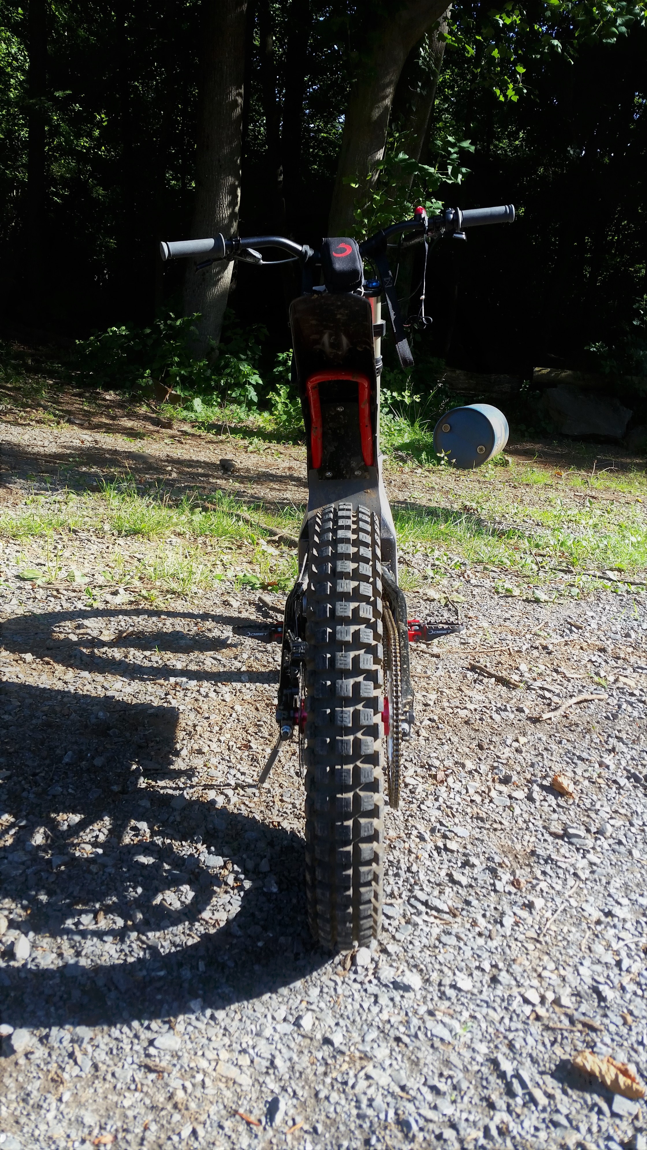

I got to ride with the new wheel this morning. The tire is a radial, tube type. Traction and feel are much improved over the skinny tire, even though it was a bit muddy. I was running 5lbs, pressure. Without the engine noise, you can hear the tire flexing and getting grip. I raised the bars 1 1/2" and made a wider piece of rubber to protect the shock.
Looks good!
Can we see a rear and side views of the rear tire?

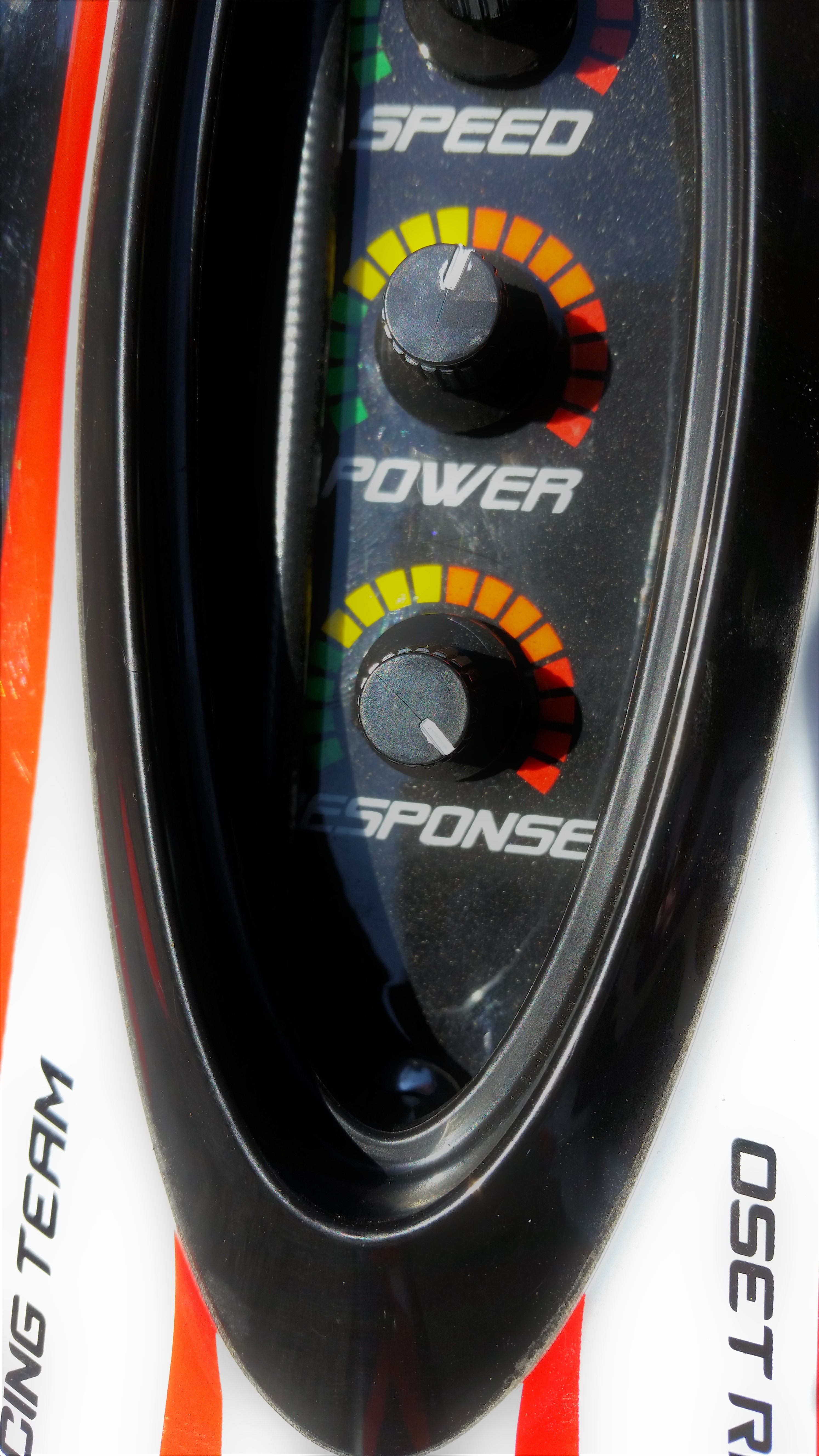

I got back out again today. Left some red paint on a few rocks. Slowly getting used to throttle control. It's hard to keep the throttle on just a little after you open it up to get the front end up and then the second blip to go over a bigger obstacle. I was trying two foot logs and a two foot rock with no drop off on the other side. The short wheel base is the biggest thing to get used to. Have to relearn turns all over again. If I had the time, I would build a new frame with a longer wheelbase. Here are some better photos of the rear wheel and on of the response setting. I wish there was more fine control over the response near the top.

This is a question I sent to an Oset design engineer.
There is one thing I’ve been thinking about.  If there was a way to control the power(torque/current) and speed(voltage) at the same time with the throttle, it would make the response more like a gas bike. Less torque and better traction at slower speeds. I’ve been thinking about using slide resistors for power and speed, connected to a quick throttle assembly with a cable. Can the Oset controller handle this. Would it be best to replace the stock throttle with a resistor (what size would work?) or just the speed dial resistor with a slide and bypass the stock throttle. The one complaint about all e-bikes seems to be too much torque at the bottom.
His response
You could setup a switch that would adjust the amps (power dial) of the bike, so for wet rocks you have it set to low and then for big manoeuvres you set it to high, maybe a middle option for other riding.
This would replace the power dial and you could adjust on the fly, any change would take effect when you fully come off the throttle and then back on.
As the throttle is at present a hall effect I don’t think it is possible to switch to a resistor setup.
I guess we'll have to wait awhile for a controller that can change power and speed at the same time. I also asked about adjusting the free play on the throttle. My bike has way too much. There is no adjustment. I might try to add more material on the stop.
That would be like the Electric Motion adult bike's "125 / 250 / 300" power modes, then.  Makes sense from an electronics point of view, sometimes you might want more power at low revs and less at high ones and there's no way for the bike to read your mind!
I would rather have less power at low speed, more traction, then progressively getting higher with throttle like a gas bike.

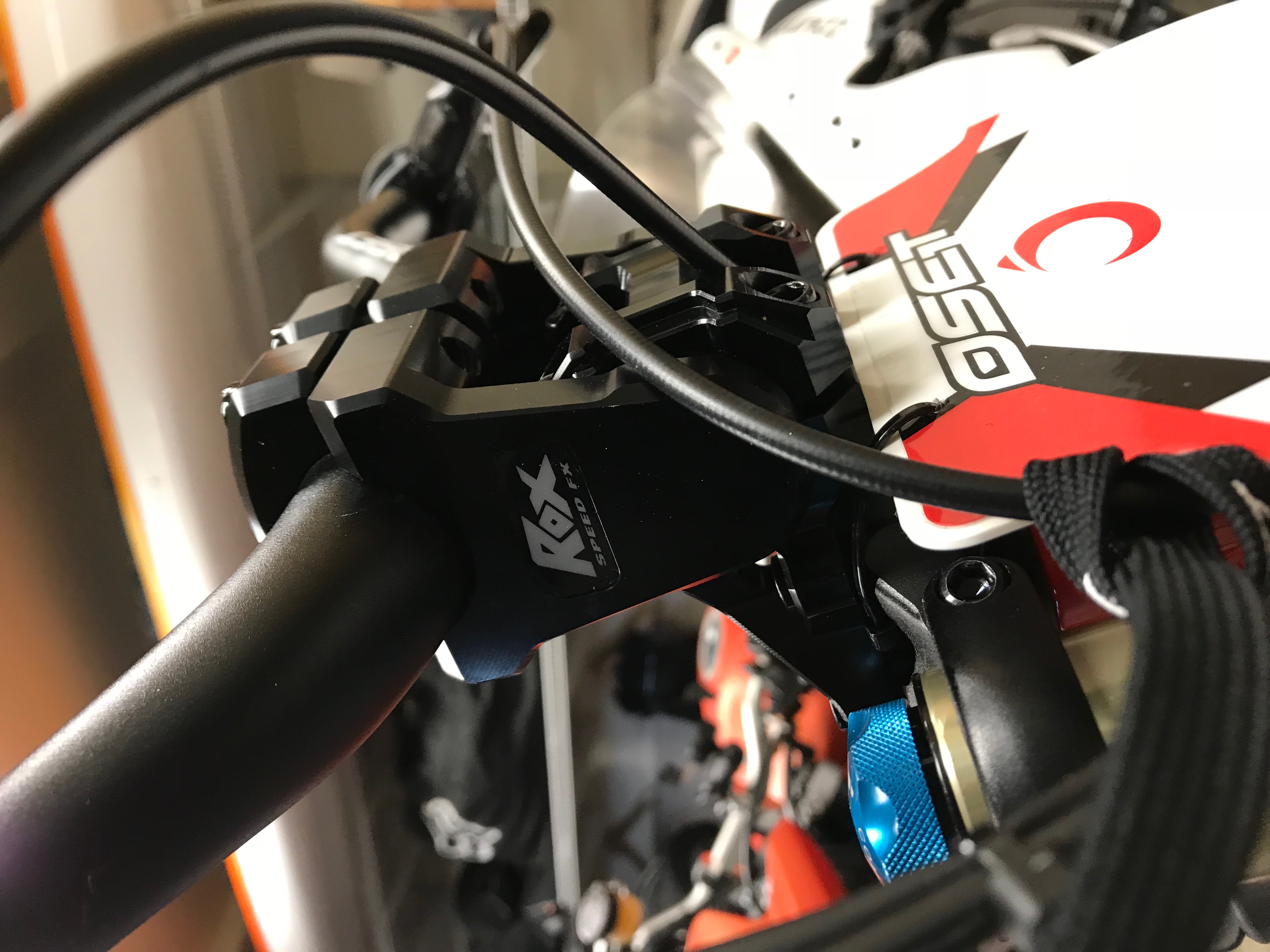

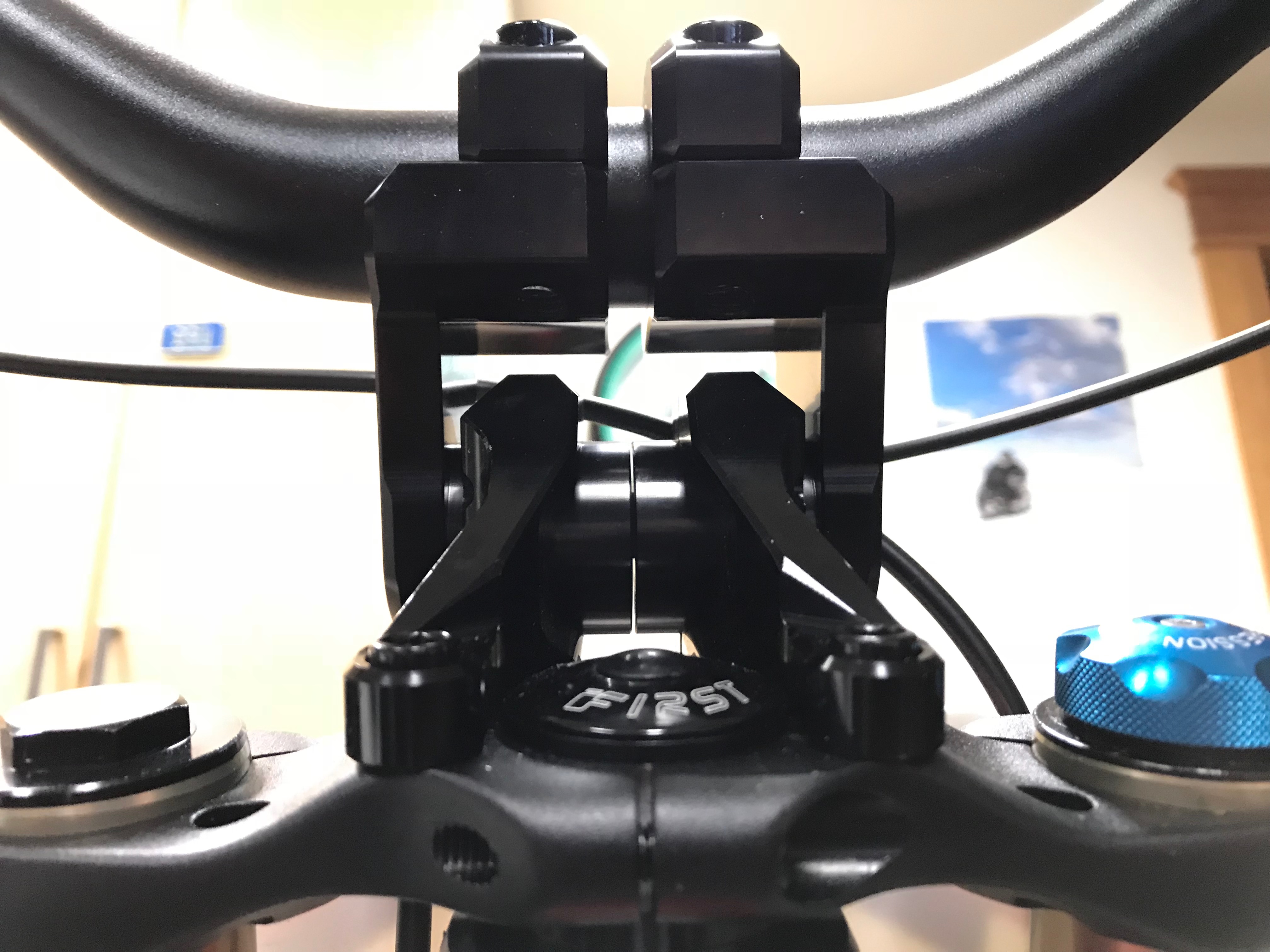

On 11/9/2017 at 5:01 PM, drumoto said:

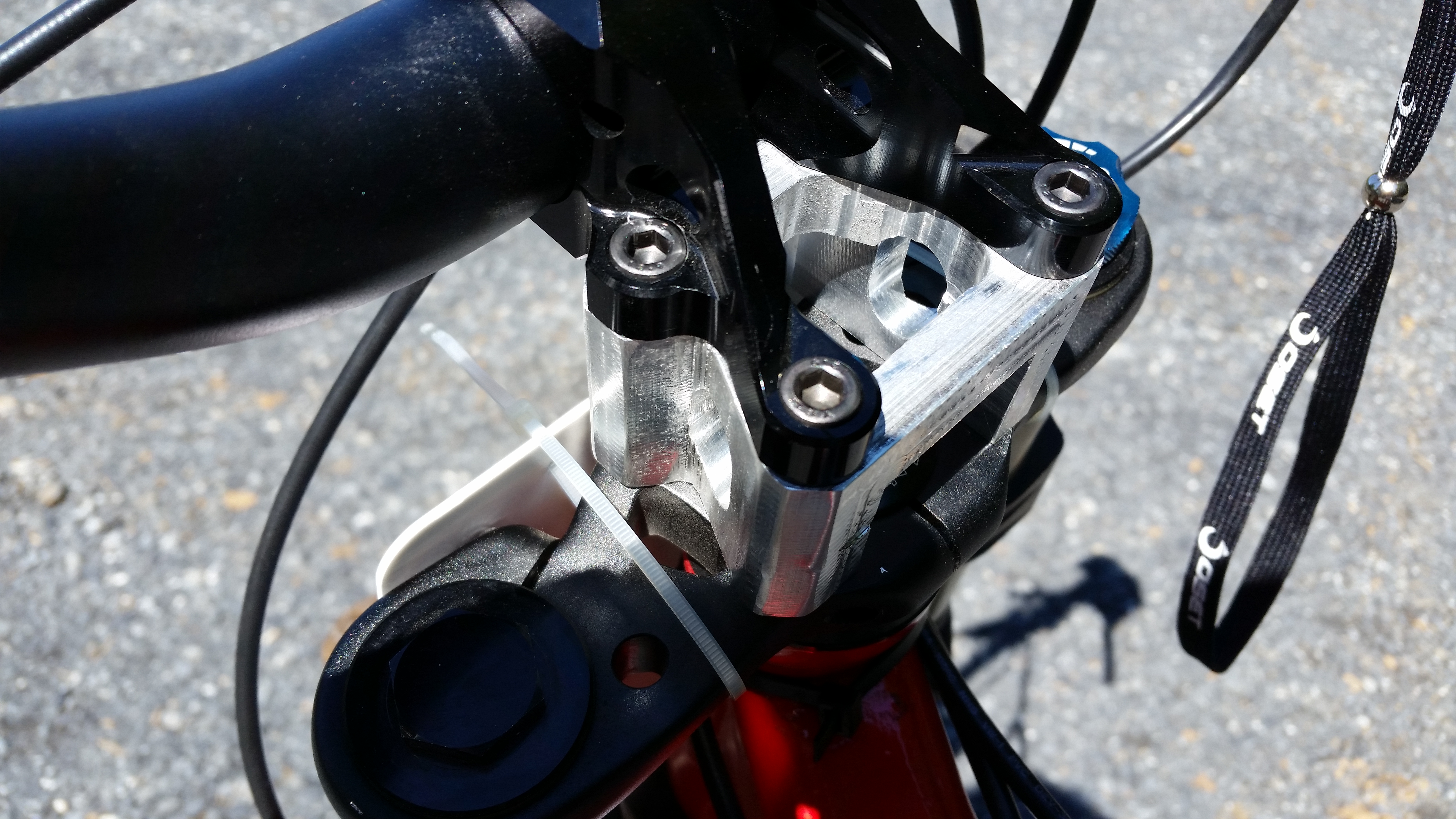

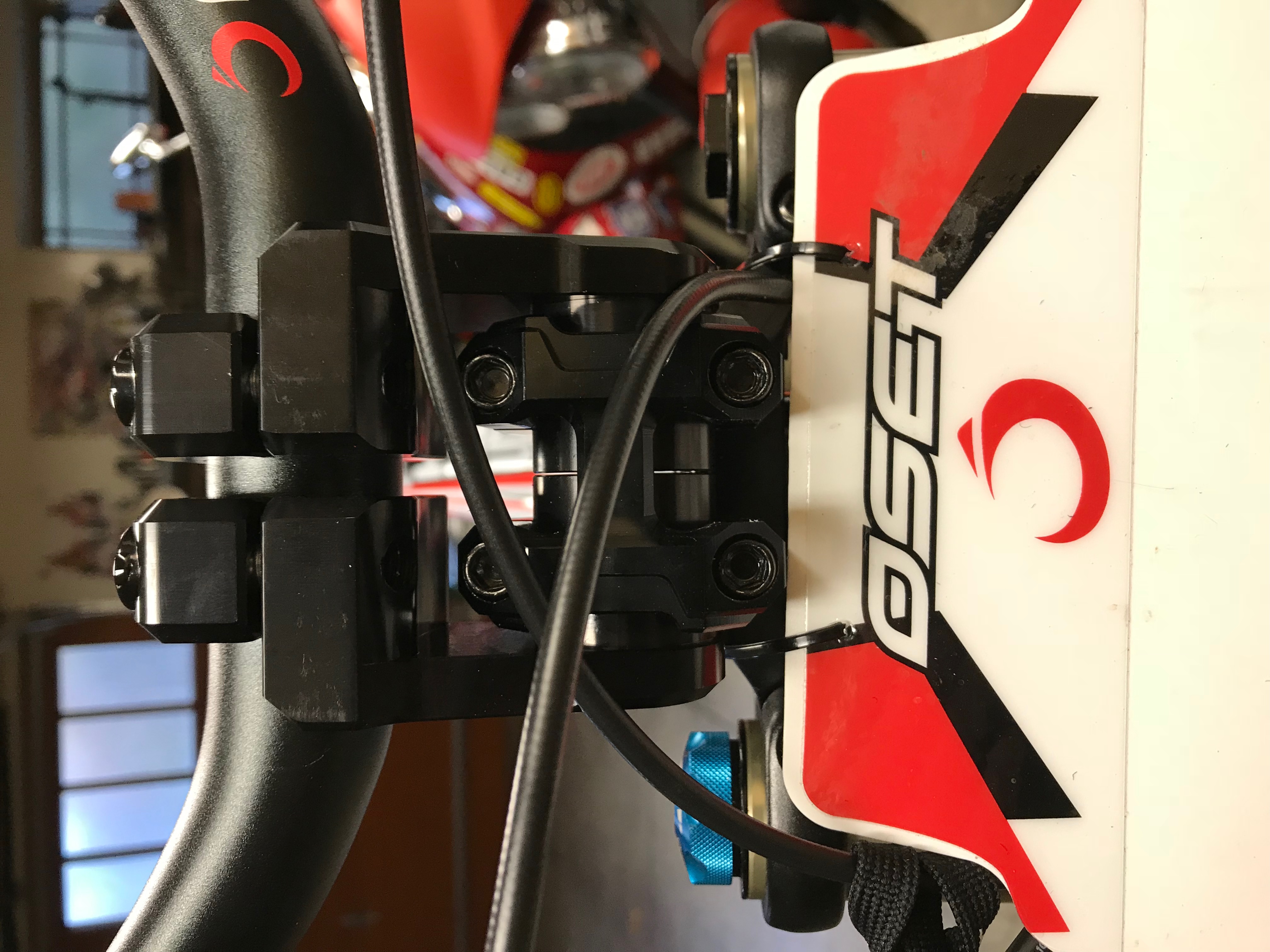

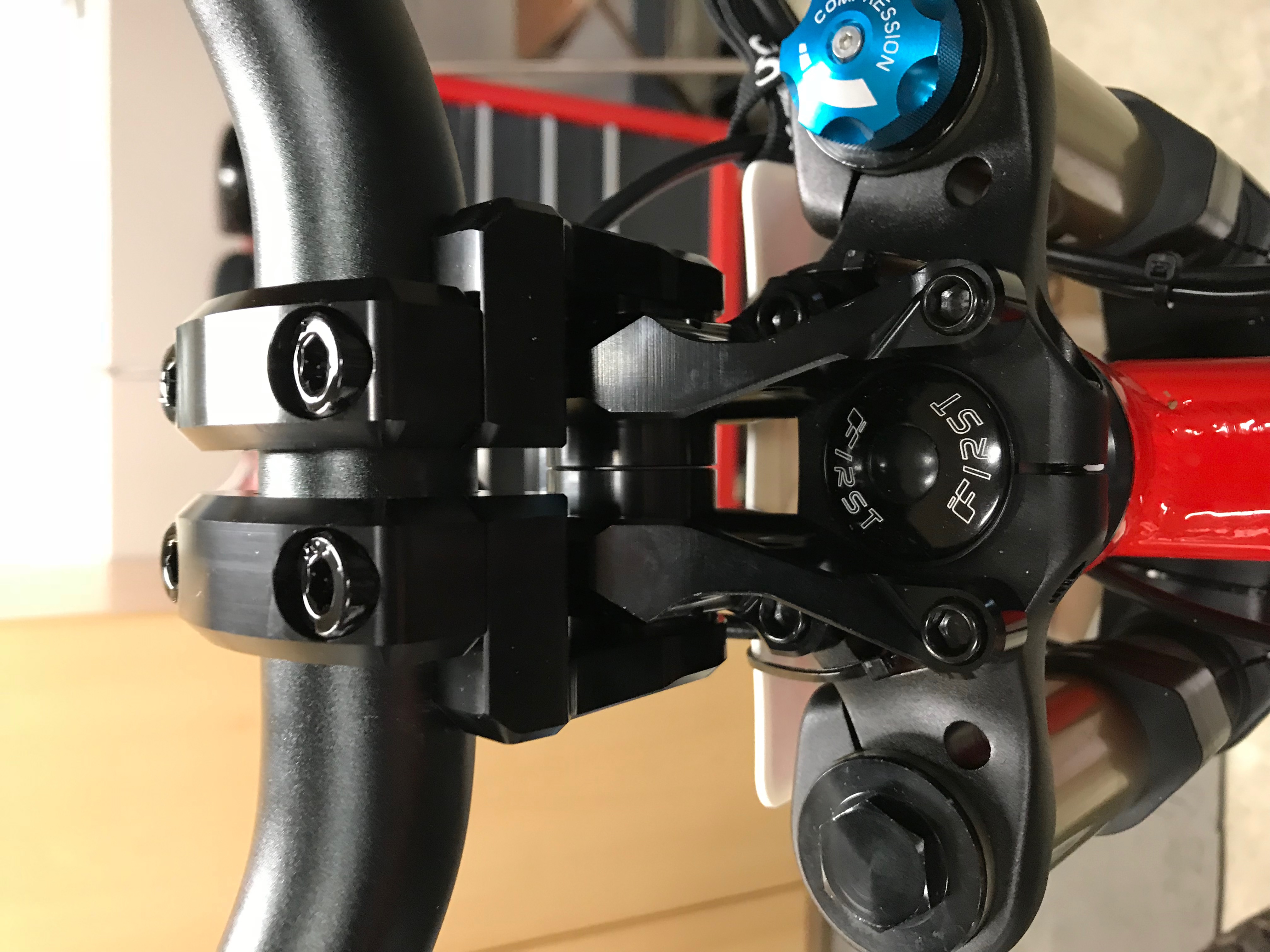

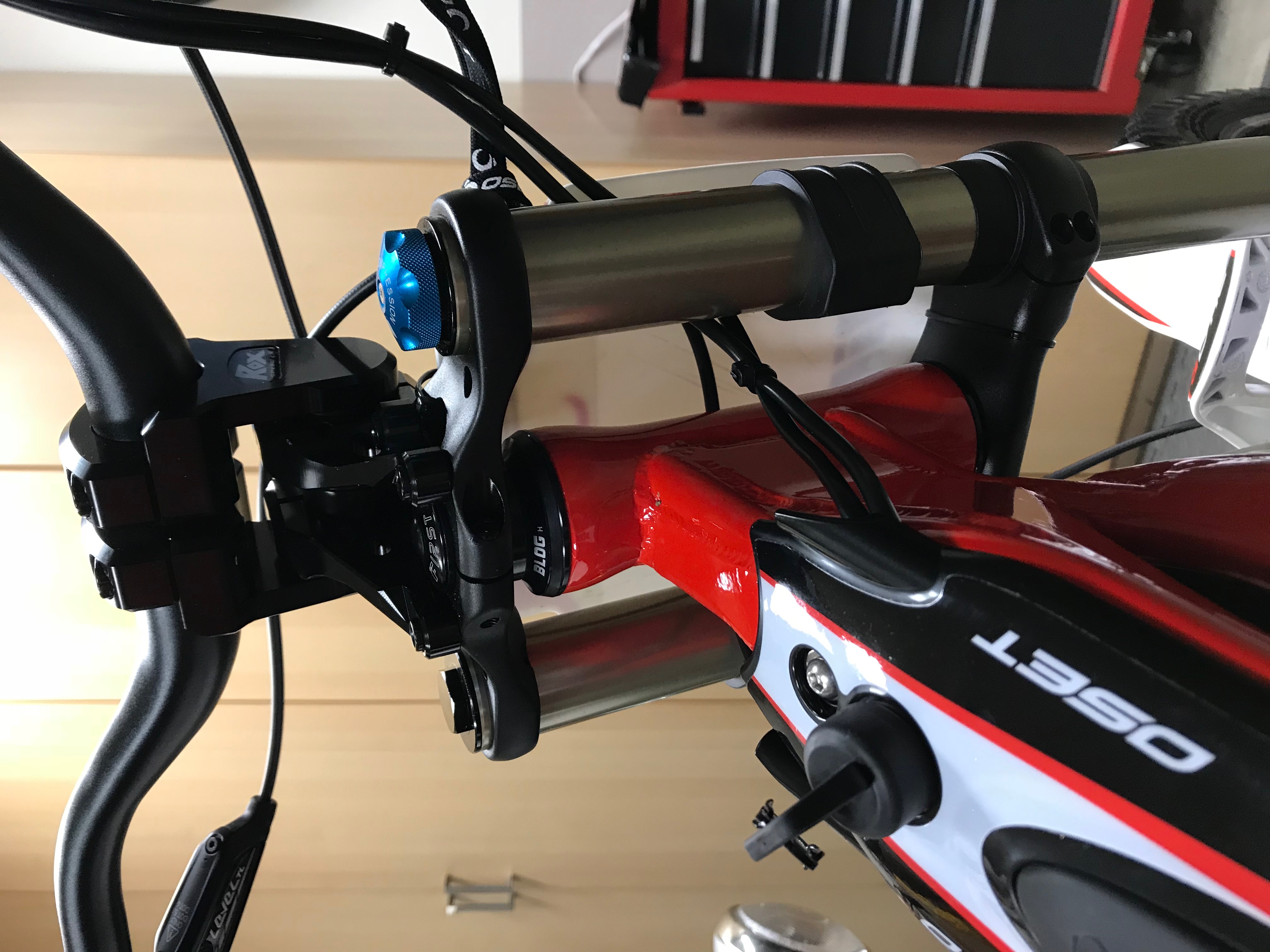

Hi guys! I'm 6' and 175lbs and I found a bolt on billet riser that fits the handlebars really well. https://roxspeedfx.com/products/indian-chieftain-roadmaster-2-pivoting-bar-risers  Havnt ridden with it yet, but am excited as it's been a bit short for me. That's probably exacerbated by the fact that I'm a beginner to trials from the enduro + road race world.
I like this riser.  Are you happy with it?  I just bought a 24 and think I'll try this.  I'm 6' 180lbs.  Excited to try Trials riding.
Rode my new 24 around the neighborhood yesterday.  Really fun bike, I'm 6' 185lbs.  I'm still getting used to the throttle response and it seems there's a mid point where the power comes on all the sudden which is a bit difficult to control.  The response knob certainly affects how strong it engages but it seems to always engage at that same point.  I was hoping the control of the power would be more linear.  You guys noticing this as well?
