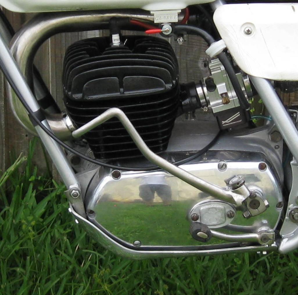

FWIW, you can see how it came to me, the one photo is after blasting (with skidplate also shown), next is sanded, then after polished.  Consider the polished photo is after handling and install onto the motor.  A couple of minutes touch up and it will be no handling marks from fingers and grease.
