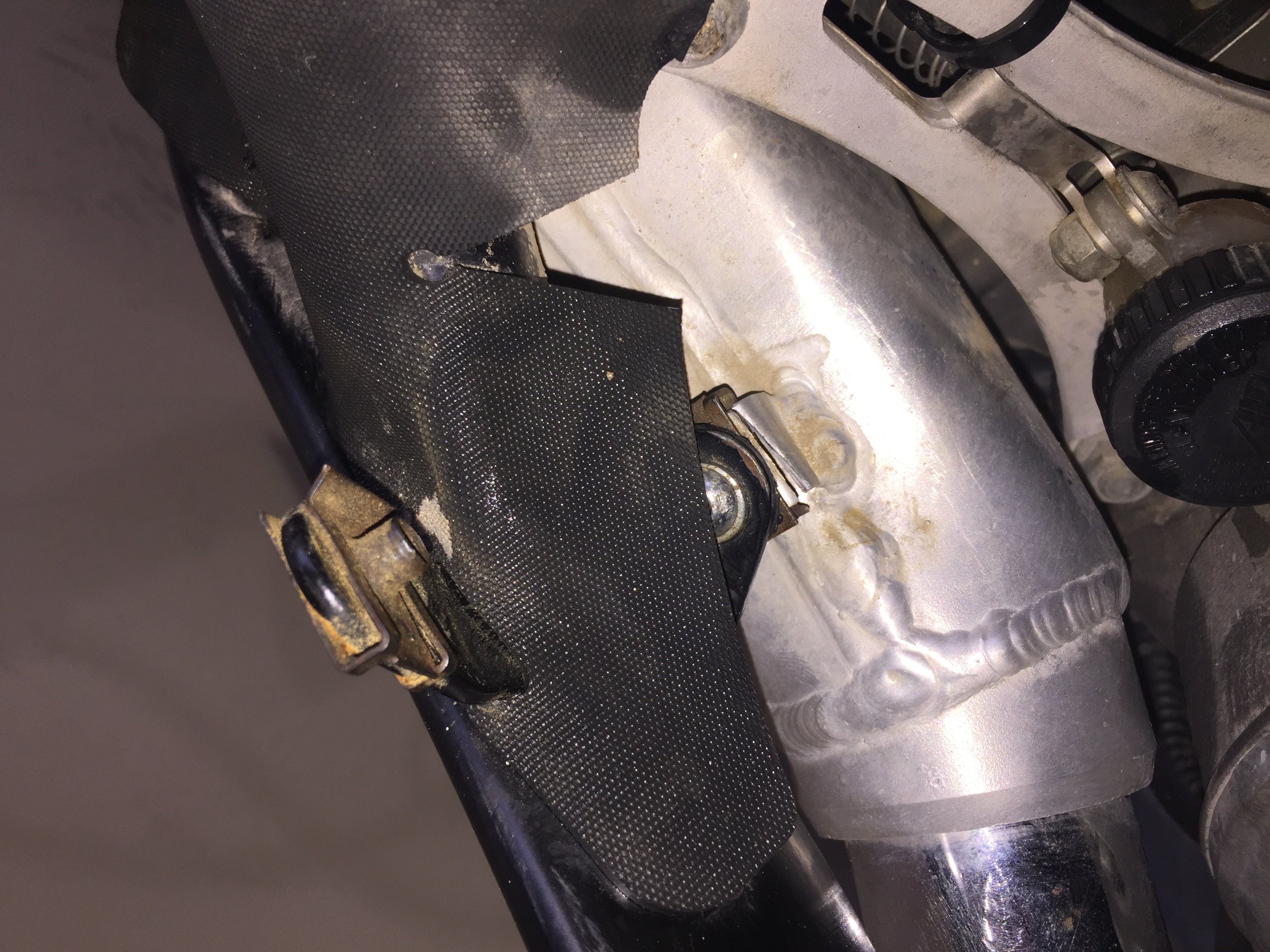

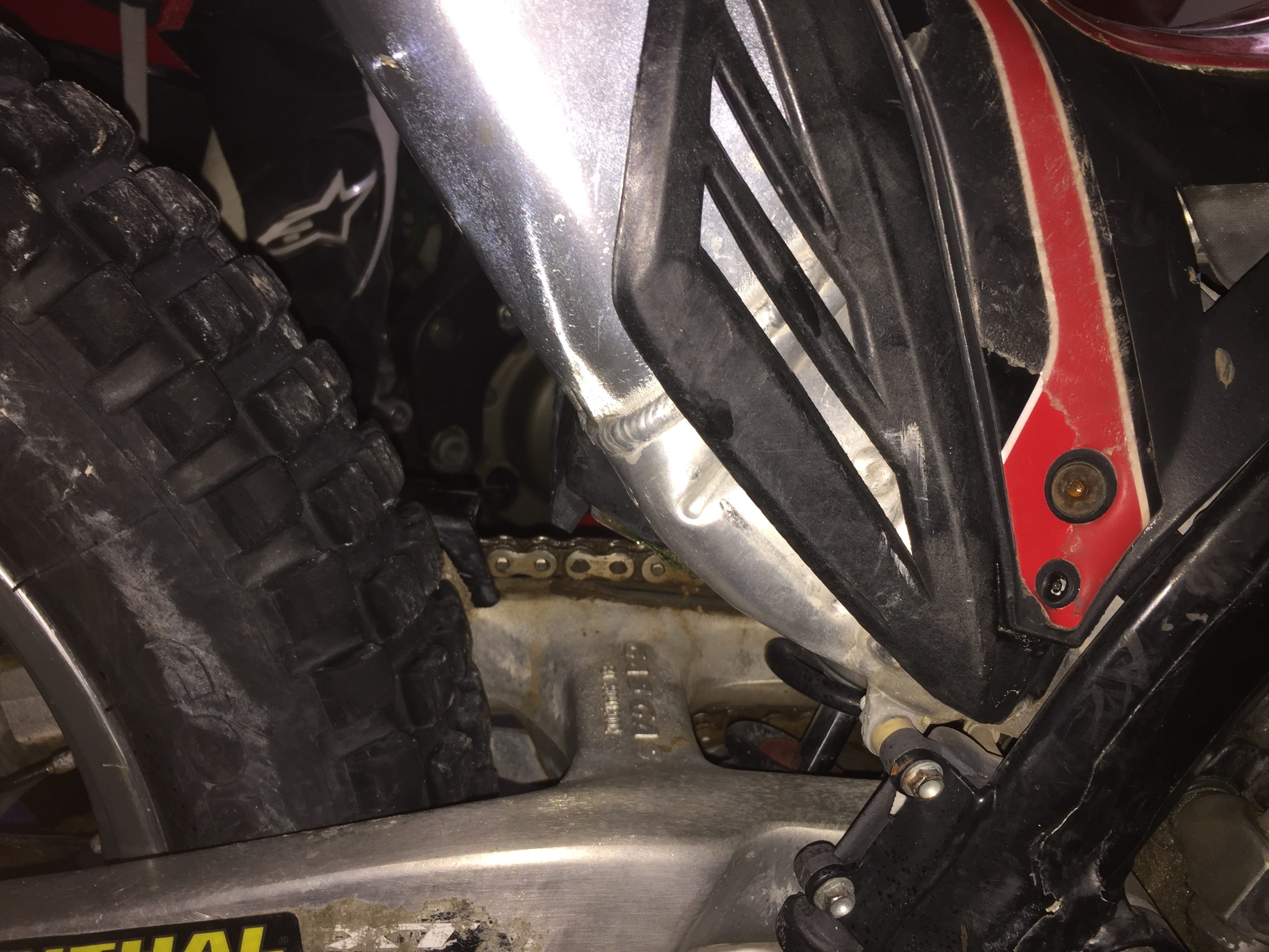

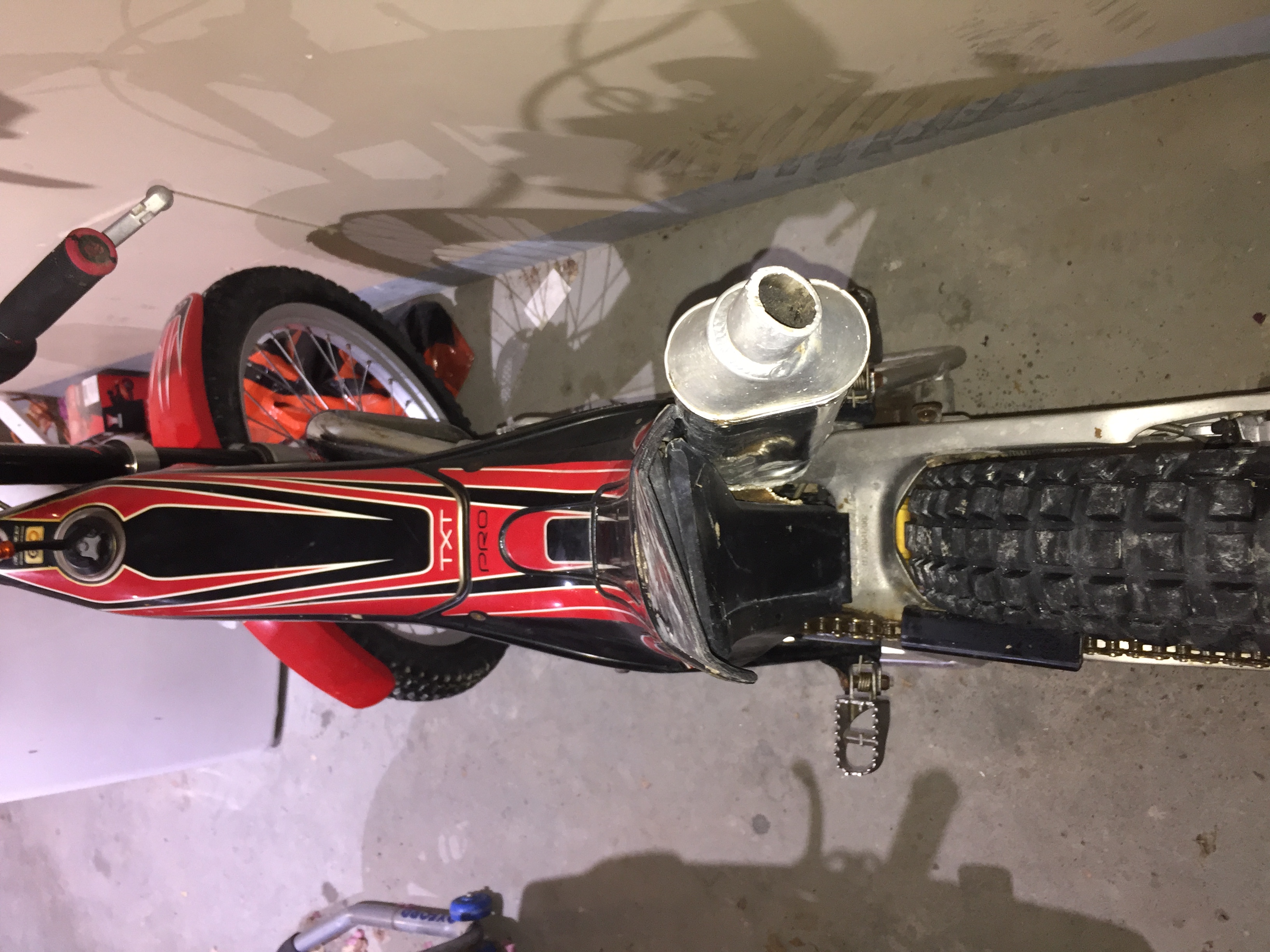

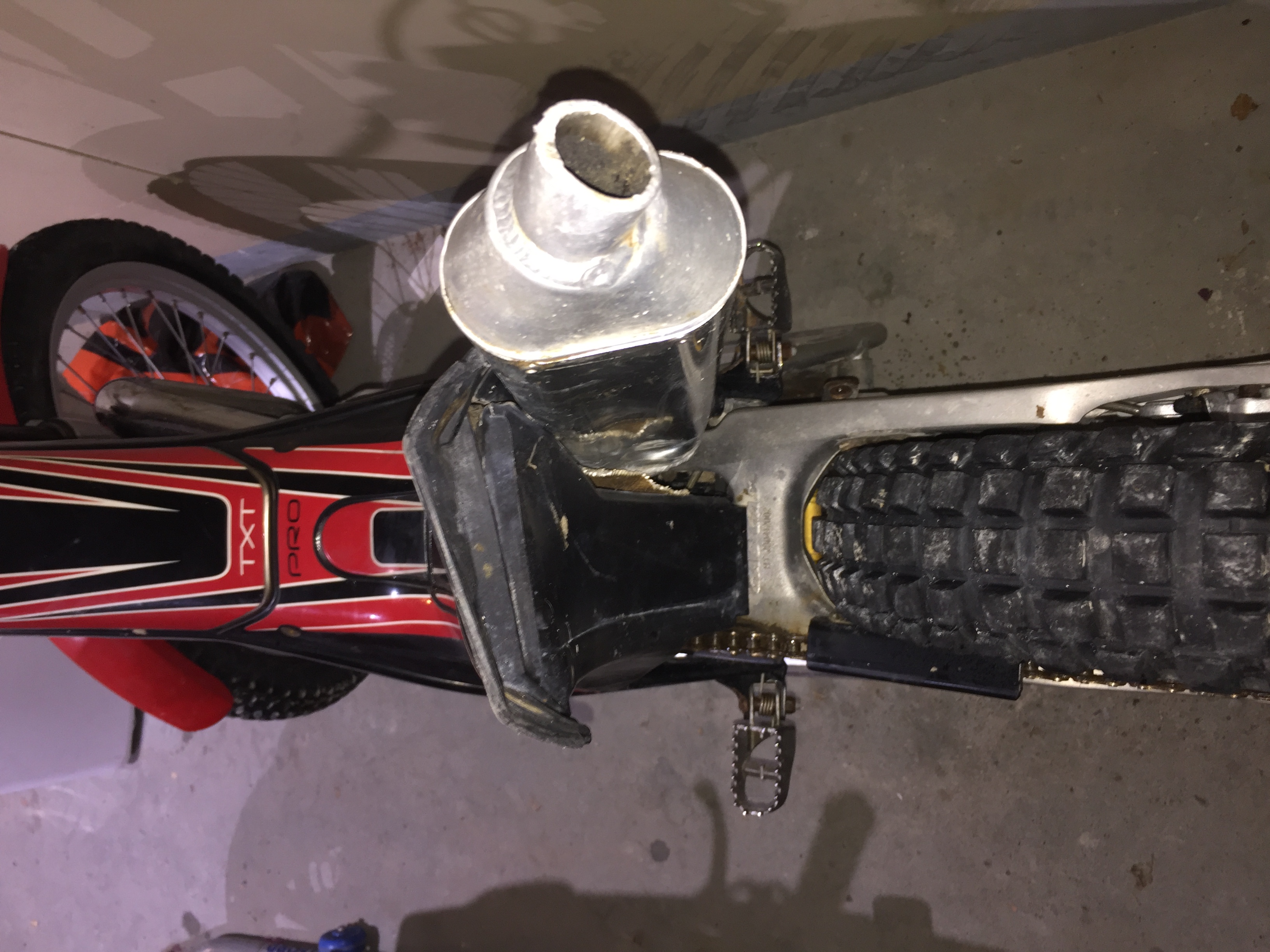

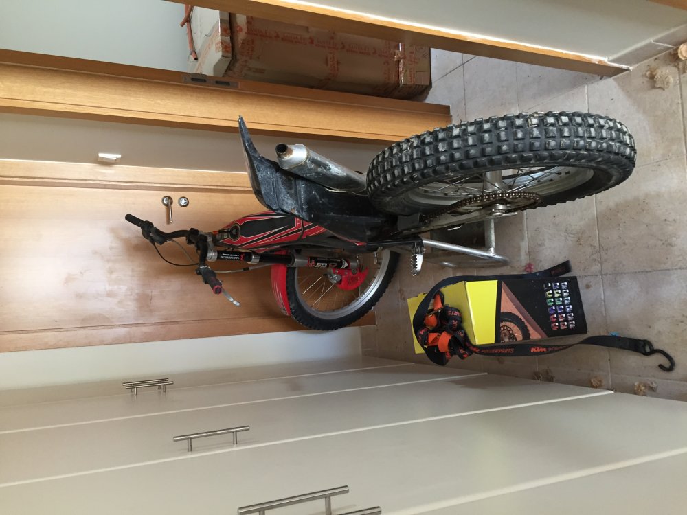

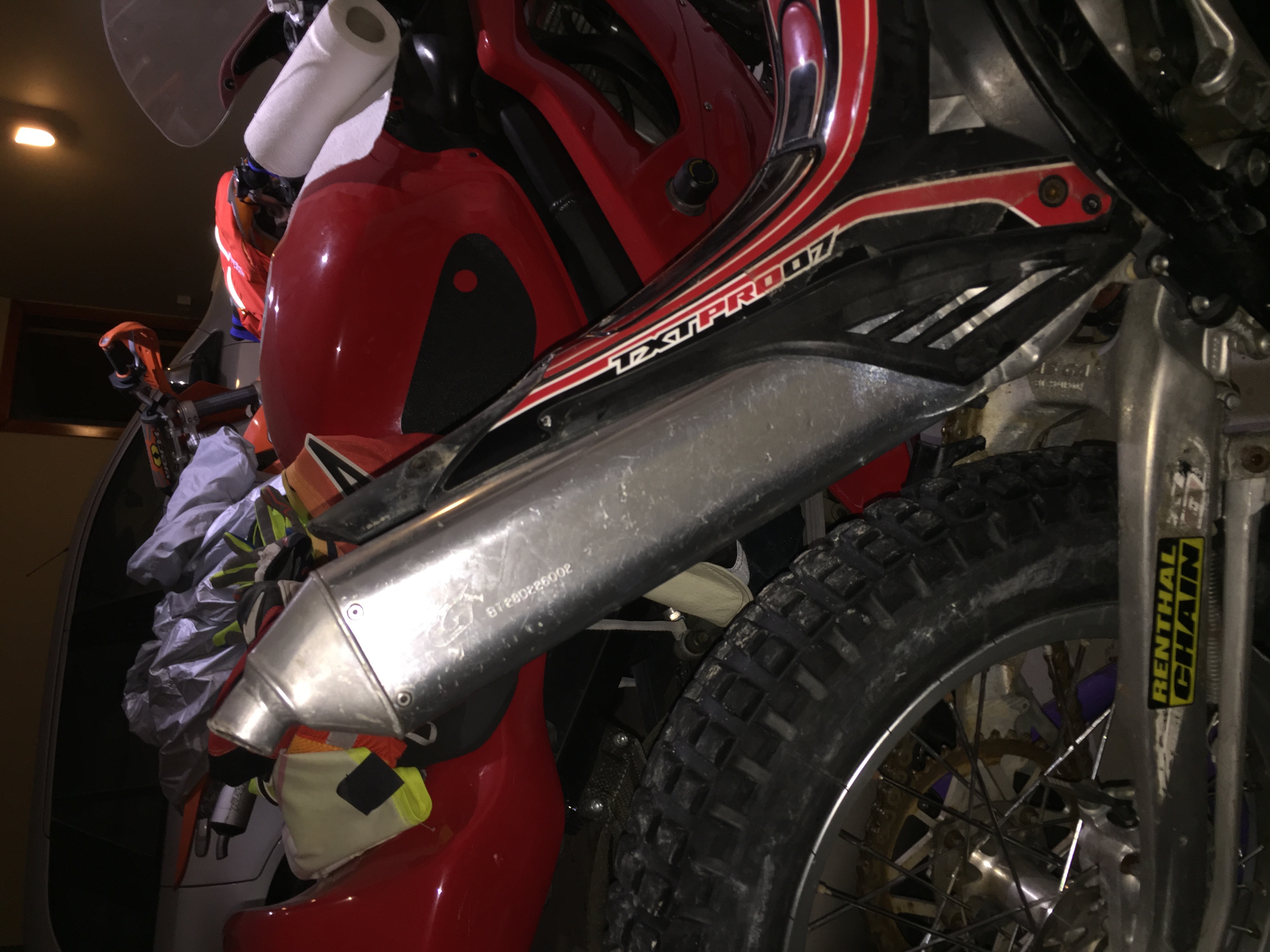

Got home and set about straightening everything up and noticed this....

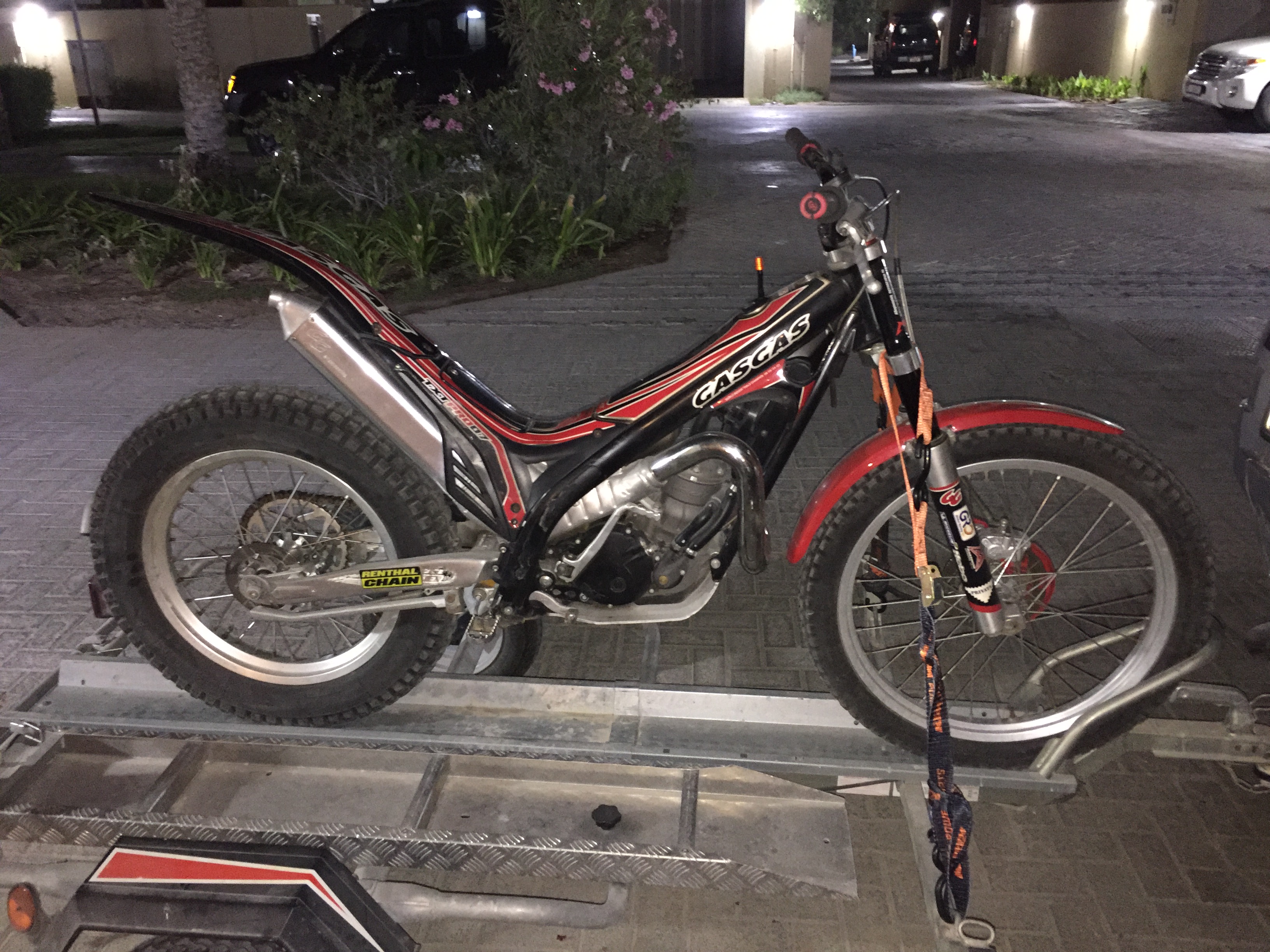

The first two photos are previous.... the rest are tonight....
Is this bent, or just shifted? Anyone else done this before?
Copped a shed load from the mrs as well for going out night before my op.... this was another kick in the baws.
??? any idea of how best to un-bent it?
Usually they get bent towards the tire, then rub, get hole in exhaust.
I would chalk this up as a "performance modification".  No rear wheel rub ;)
Ha ha! More worried about getting the tail squared up than anything else. ?
Google says it's probably just the bracket that's bent, sound about right?
I figure you have 3 options:
1. fix it the right way, take it apart. locate bad bit and repair properly  (could be just a bracket is bent and easy to bend back)
2. whack it real hard and see if you can push it back into position
3. ride it as is and tell everyone how much of a genius you are for modifying the muffler to eliminate the rear wheel rub.
(and then wait to see how many people do the same to their bikes, and then chuckle quietly to yourself)
I would undo the tank and check the bracket underneath the tank/near the carb, check the bracket near the rearbrake. If those are ok you can try to bend it back in shape a bit but if it doesnt rub leave it as it is.

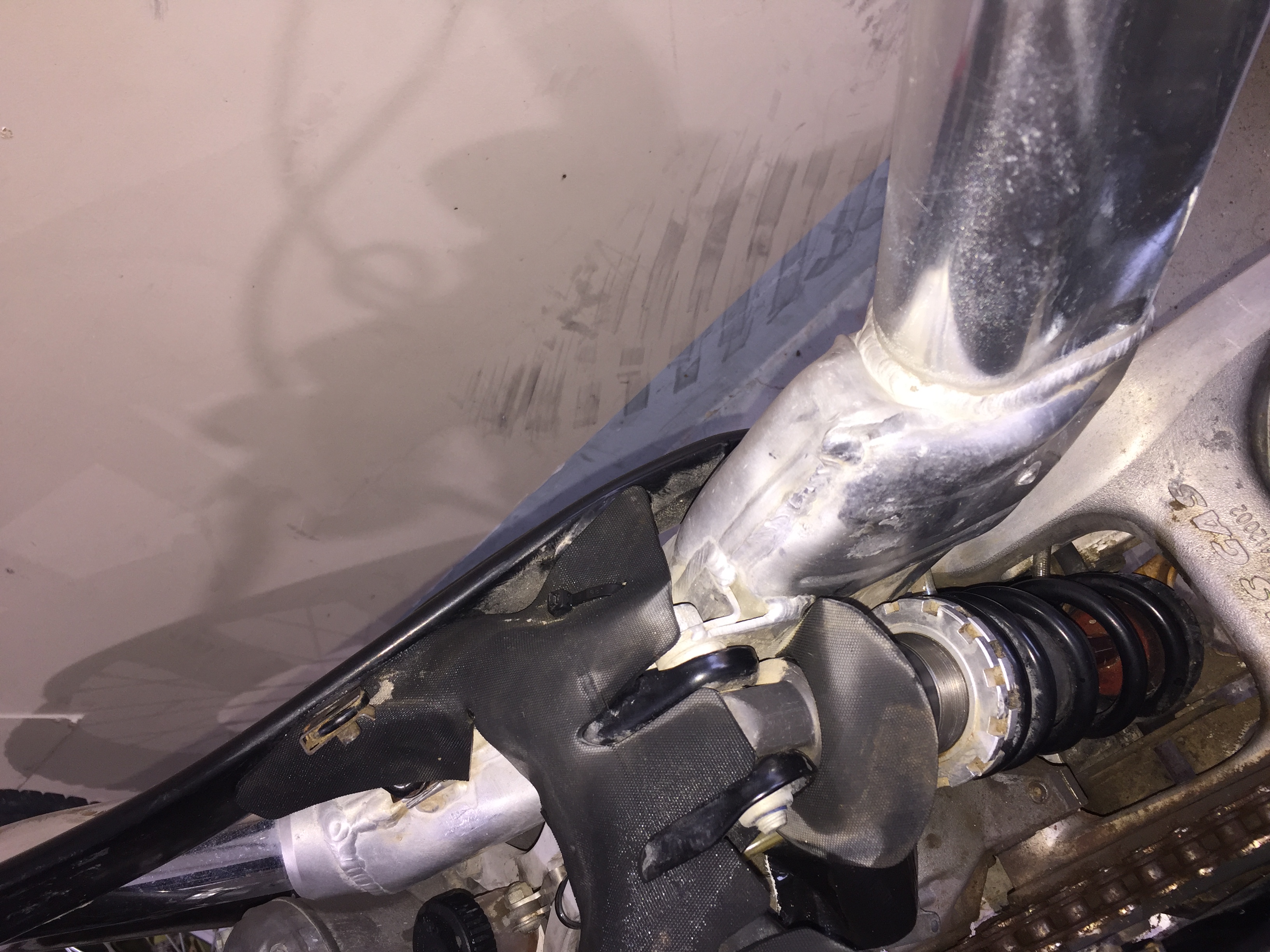

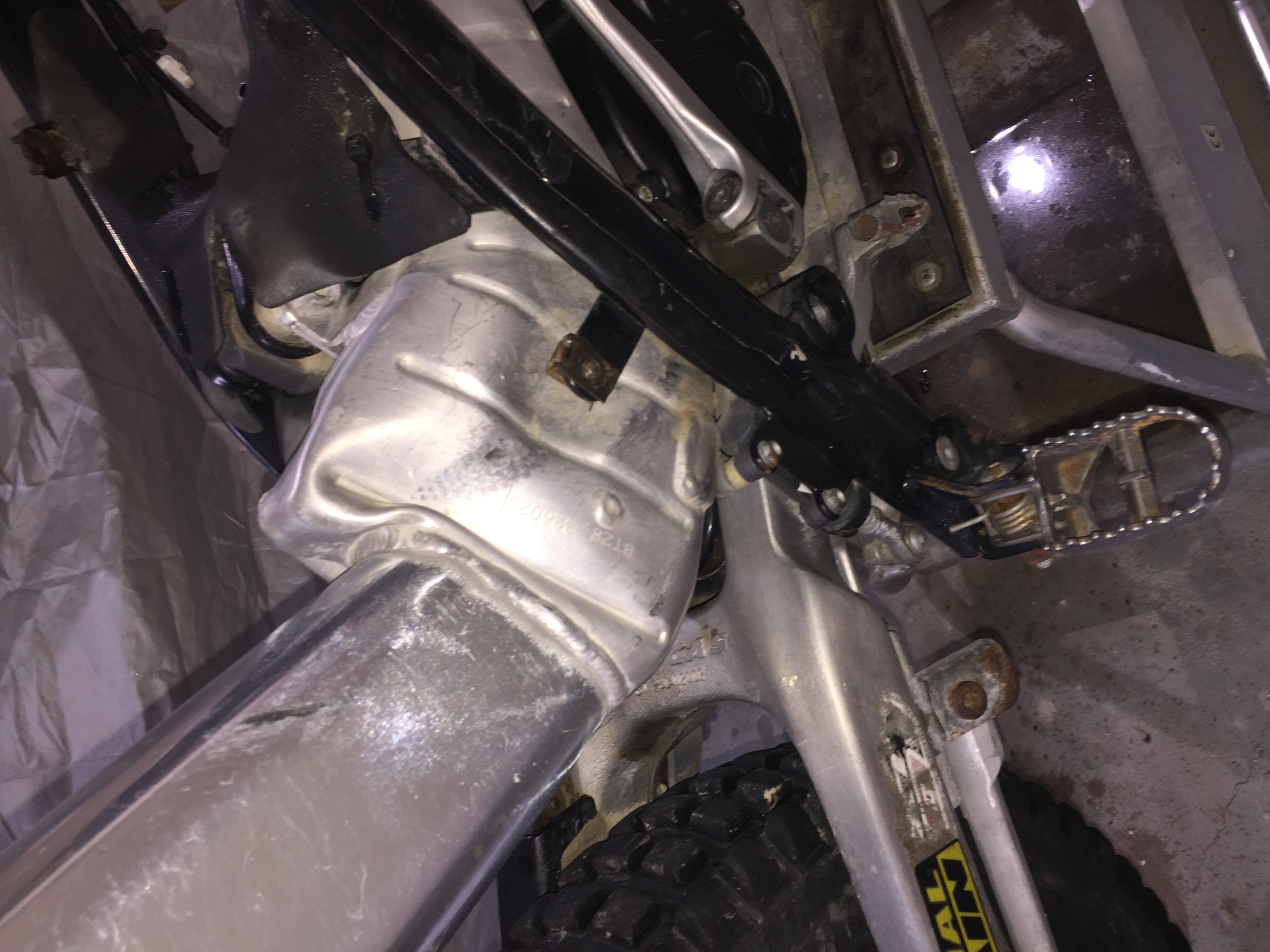

Been a few weeks since my op so hand better now.... got round to stripping it today. A little heat and persuasion required, also a little welding. Think it may be blowing at the bend on the front as well, so not a bad time to whip it off.
Pics below..... thoughts?
I get you.... I've got a blow torch as well.... was going to sit on it whilst it's on the box stand, heat it and try and push it  straight, mrs will hold the bike steady. Good time to repack as well I guess. Will look at using some wood as a former/lever.
Take some advice on using heat, too much and you may just end up with a load of soft bent alloy, I would keep the heat to an absolute minimum unless you know all of the pitfalls.
Only looking at warming where it's bent in on itself at the top.... there will be some work hardening from when it yielded, just a little heat to reduce the risk of it cracking (too badly) when it's being straightened.
What's inside the centre muffler? Is it baffled? Or packed?
