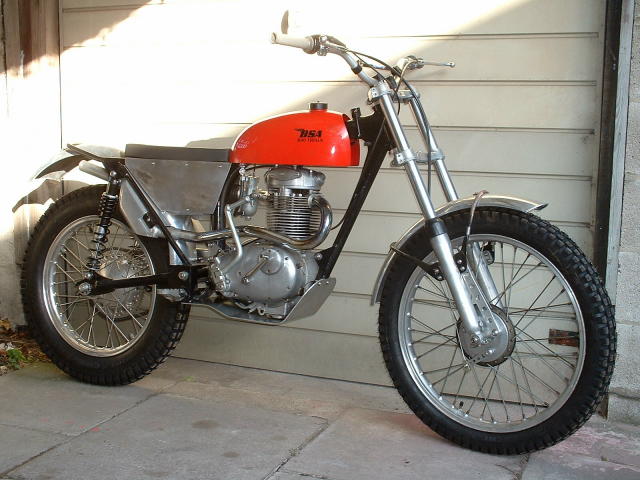

the otter framed B40 is almost finished for next year
That's interesting, I'm currently building an Otter C15. It's in Mr Weedy's workshop at the moment having the awkward bits done (exhaust system made up, wheels and forks grafted on). Did you build yours from scratch also? What centres/events do you plan to ride?

Did i build it from scratch?
Well sort of. I assembled it and made parts as required on the lathe etc.
Frame from Faber
Forks from OSSA Gripper
Front wheel SWM
Rear hub Billet alloy care of Mr Whitton
PVL electronic ignition also care of Mr Whitton
Rear shocks care of Mick Andrews
Exhaust pipe Sammy Miller
Hebo footrests BVM Moto
Air box and side panels fabricated and welded care of ME :hl:
Seat covered by RK Leighton
Usual Renthal bars and Amal Levers
Bit like most Pre 65 bikes really just assemble what comes to hand or make yourself.

nice looking bike
what make are the rear shocks/ springs?
the exhaust box doesn't look like anything in sammys catalogue although it looks fantastic and probably works a treat
good luck with it
Aww shucks thanks for the nice comments guys.
The rear shocks are Mick Andrews Classic shocks that Mick brings over from Spain.
The exhaust pipe is a std B40 one from Sammy Miller but the silencer i made myself. I wanted something to keep the bike slim, cant stand the miller one it sticks out and gets damaged too easily so i fabricated this one up. Works fine and sounds really nice. The exit is level with the rear mudguard so deep water is no problem. Just got to finish the bottom engine mount and she's about done.
Mine got even less slim after a particularly bad backfire when still dialing in my bike. It balloooned out to the shape of a barell! Try getting your leg to clear that!
The BSA looks great.
