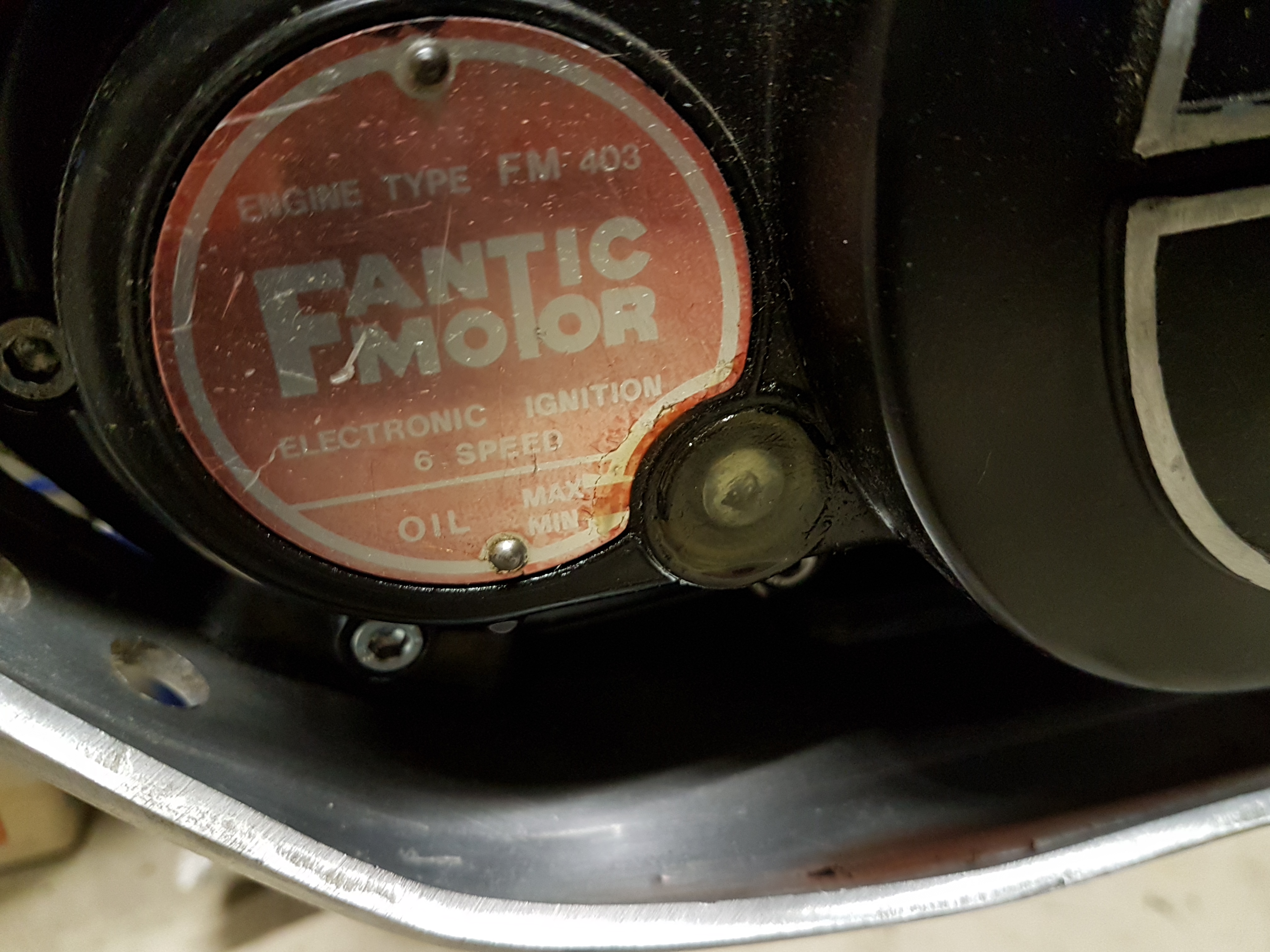

Hi All .. I recently bought a fully restored Fantic 241 trial bike monoshock 1986 progress 1 version. I have used it only twice and I have a leak coming from the gear box.. It seems to be under the glass eye level rather than the gasket itself.. It's leaking quite a bit now so want to get it fixed asap as i want to use the bike.

Picture now added and oil seems to be coming out from underneath the glass eye

The 241 is a very simple engine and has no oil filter. The sight glass does not normally cause problems. Very occasionally the casings do crack but this is unlikely. I notice that someone has fitted replacement bolts to hold the side casing on and this reminded me of when I did this myself and used bolts that were just a fraction too long resulting in the bolts bottoming out in their holes and although everything seemed tight, The casing was not quite being pulled against the other facing resulting in a very difficult to locate slow leak. I'd check that if I were you
Replacement oil level viewers are available if your's is damaged.
The oil leak will be simple to fix, these bikes aren't know to have oil leak issues. Should be easy enough to see where the oil is coming from.

That's fantastic advice, thank you so much. I will take one of the bolts out tomorrow and see what length it is. Luckily where I live we have a place called alpha fasteners which sell allen bolts in all sizes so will buy some slightly shorter ones just I case it is that.. You guys on here are fantastic an know your stuff :-)

Well it's not the bolts as bought 5mm shorter ones today and it started to bite the 1st one then just spun, so at least that's ruled that out...

I still think it's the glass eye thats the problem... do they just screw in or do you need to seal them with sealant?
Alberto is referring to the ' engine type' plate shown in your photo, it clearly says FM403 that identifies it as a 250 size engine, I think you will find the 212cc size is an FM450.
Talk to a fantic spares specialist for more info, as I would not know if the clutch cover could be interchangeable therefore changing the engines identity !
Ah right. So maybe it's a 250... it's decalled up as a 241 but it does seem really powerful. Saying that its the only bike ive ever ridden lol...thanks for the info ?
Is there any other way of identifying what size engine it is apart from the engine plate?

send us a picture of the engine (cylinder and head are different from 212cc and 250 cc) and gasket kit are differents
Thanks for that Alberto.. I will later and also the frame has fantic 450 stamped on the front of frame on the headtube
