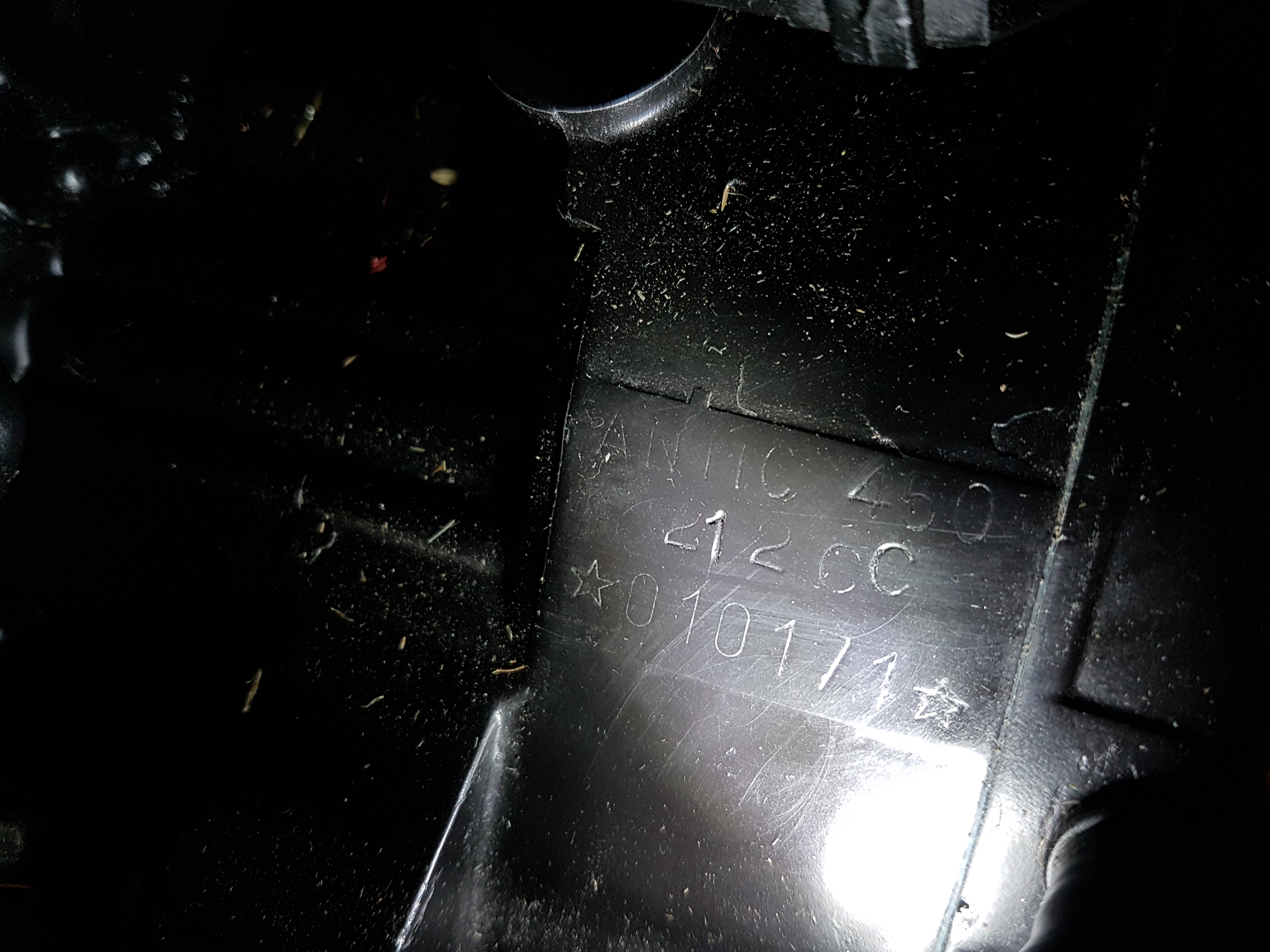

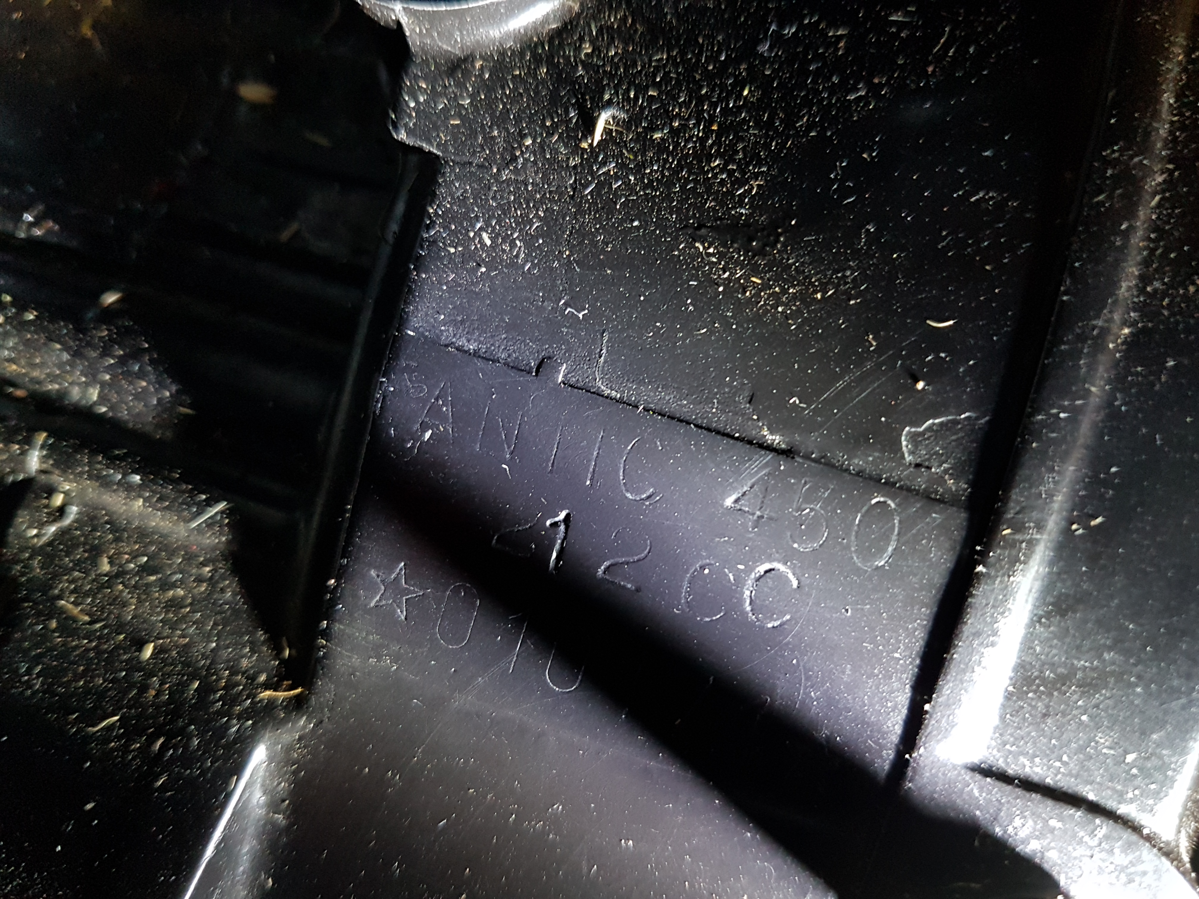

Thanks for the information, I've just taken some pictures and think this confirms its a 212cc so a 241.. Going to upload now
So i'm guessing my engine number is 010171  and also I need a 450 plate on the gear box cover?
It there a technical name for a gearbox cover? The case that covers th gear box which has 11 allen bolts holding it on, as I'm going to try and get the correct one if I can with the right plate on it.
And where would the frame number be so I can find out if it is matching the engine?

I've always called it a clutch cover, not sure if that the correct terminology.
If you find a cover for an FM450 with a good sight glass it would save you fitting a new one to yours. Two birds, one stone!
I've never seen a Fantic with matching engine a chassis numbers. I'd imagine the engines and frames were stamped separately in different parts of the factory and brought together for assembly. Frame number is on the headstock tube.

For your engine identification plate get in touch with Cambstrials as quick as you can as he has new plates available [very limited stock] and states [On Ebuy]that he has a 450 plate to fit the 403 sidecasing
Thank You, I contacted him this morning and he told me he sold the last 2 last night on facebook and won't be getting anymore... so trying to locate a decent 450 cover now.. But thank you for letting me know.
