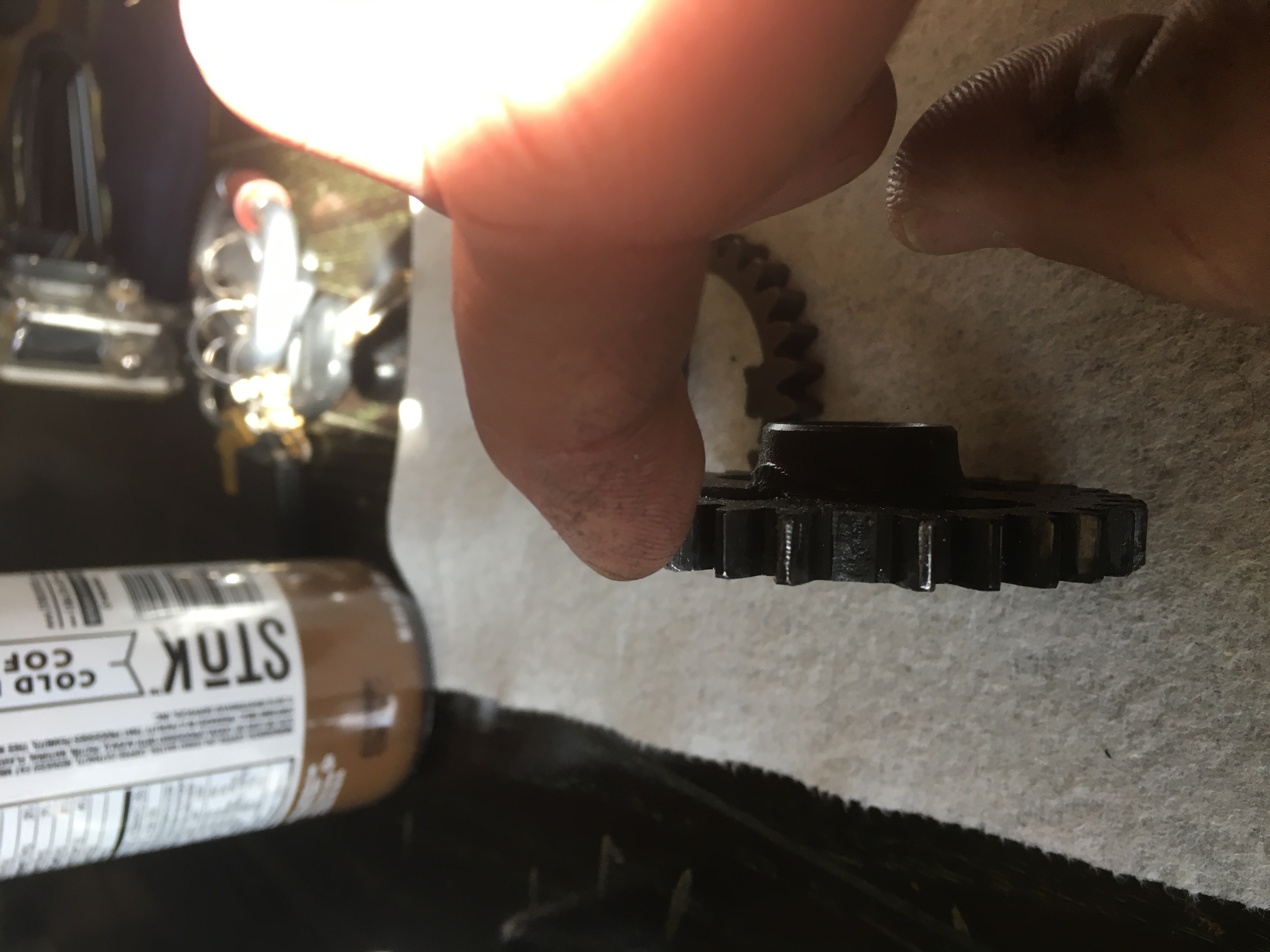

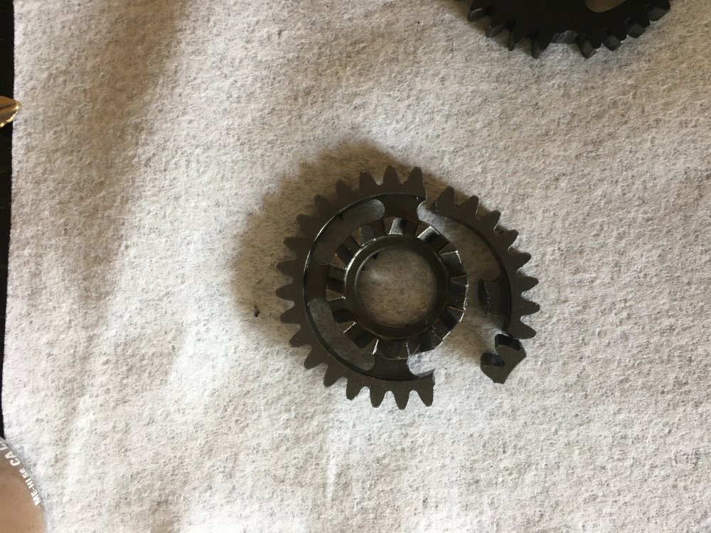

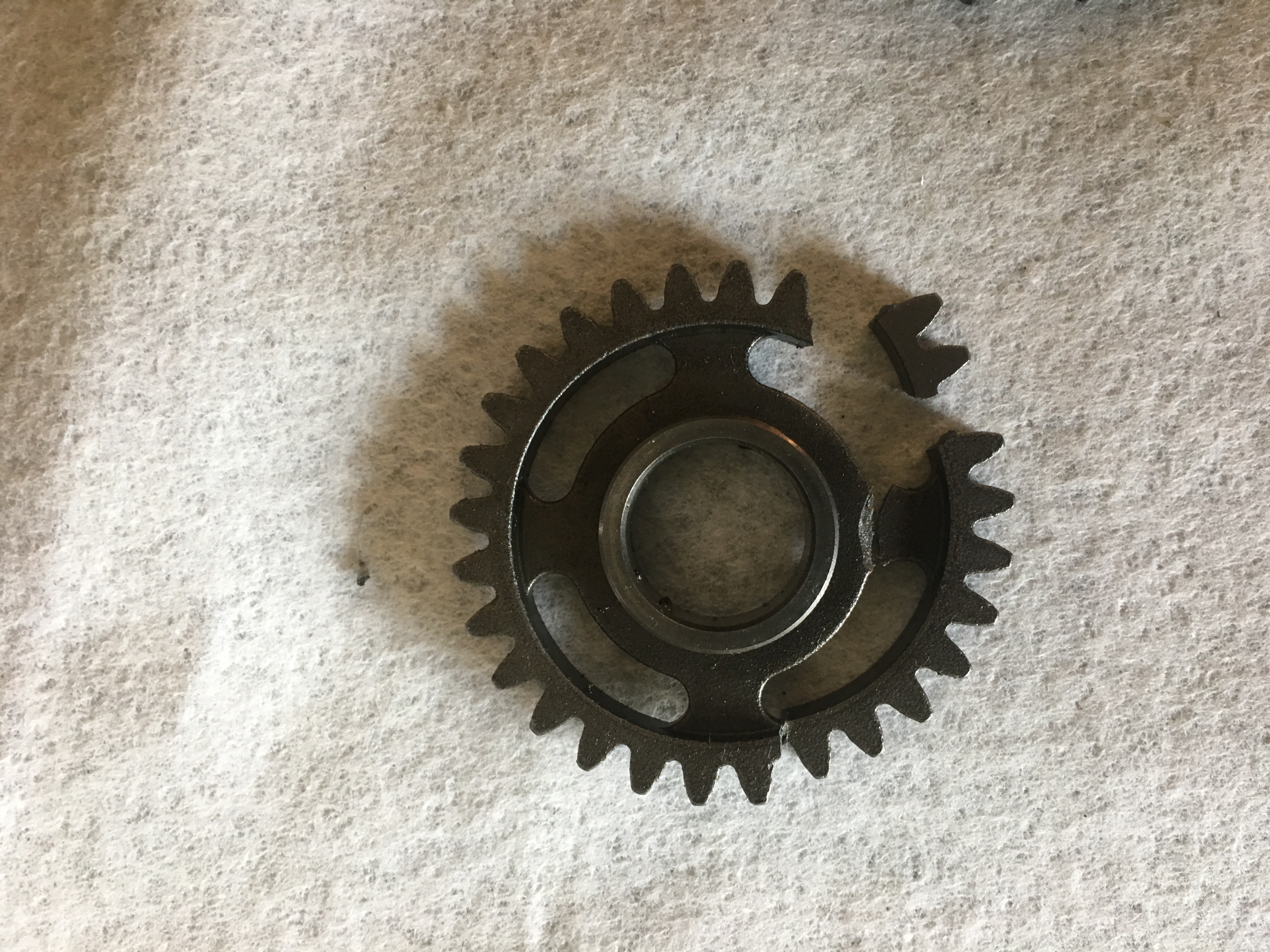

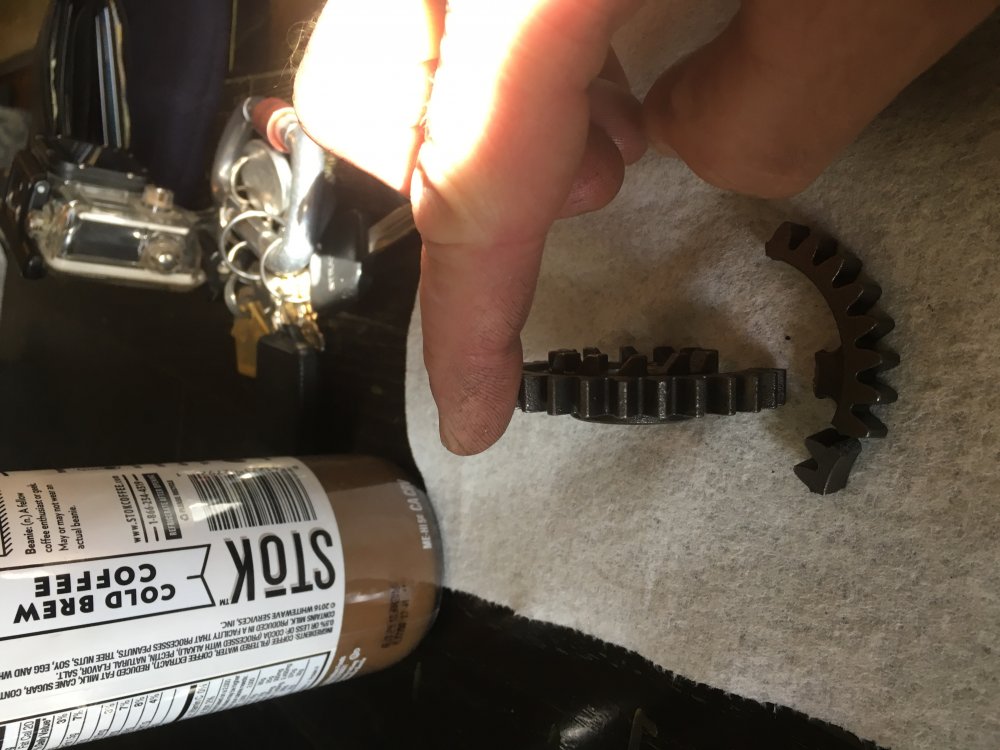

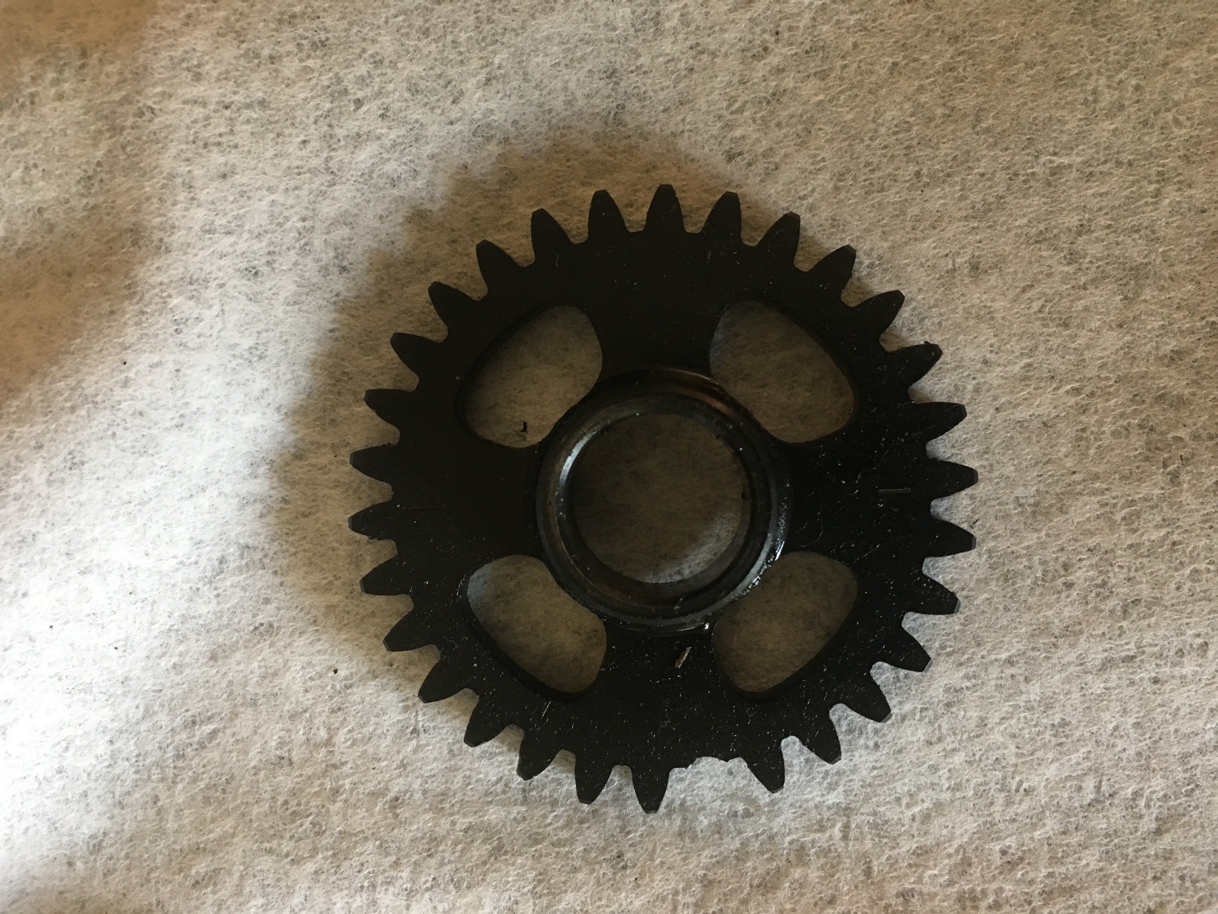

I have a 2008 rev 4t with a broken kickstarter pinion gear.  I need a replacement or a cad 3d drawing to build a new on.
Any help on this fix would be appreciated.   See pic of broken gear and gear with broken tooth.
Thanks, Steiner
I would not copy that design even if I had a CAD drawing. There is too much unsupported length under the teeth, no surprise it has broken.
I agree with you.  I will have the CAD drawing fill in the spots behind the gear and reinstall it.   I just found out BETA has discontinued the part and has an upgraded part with one other gear and shaft for twice the price.

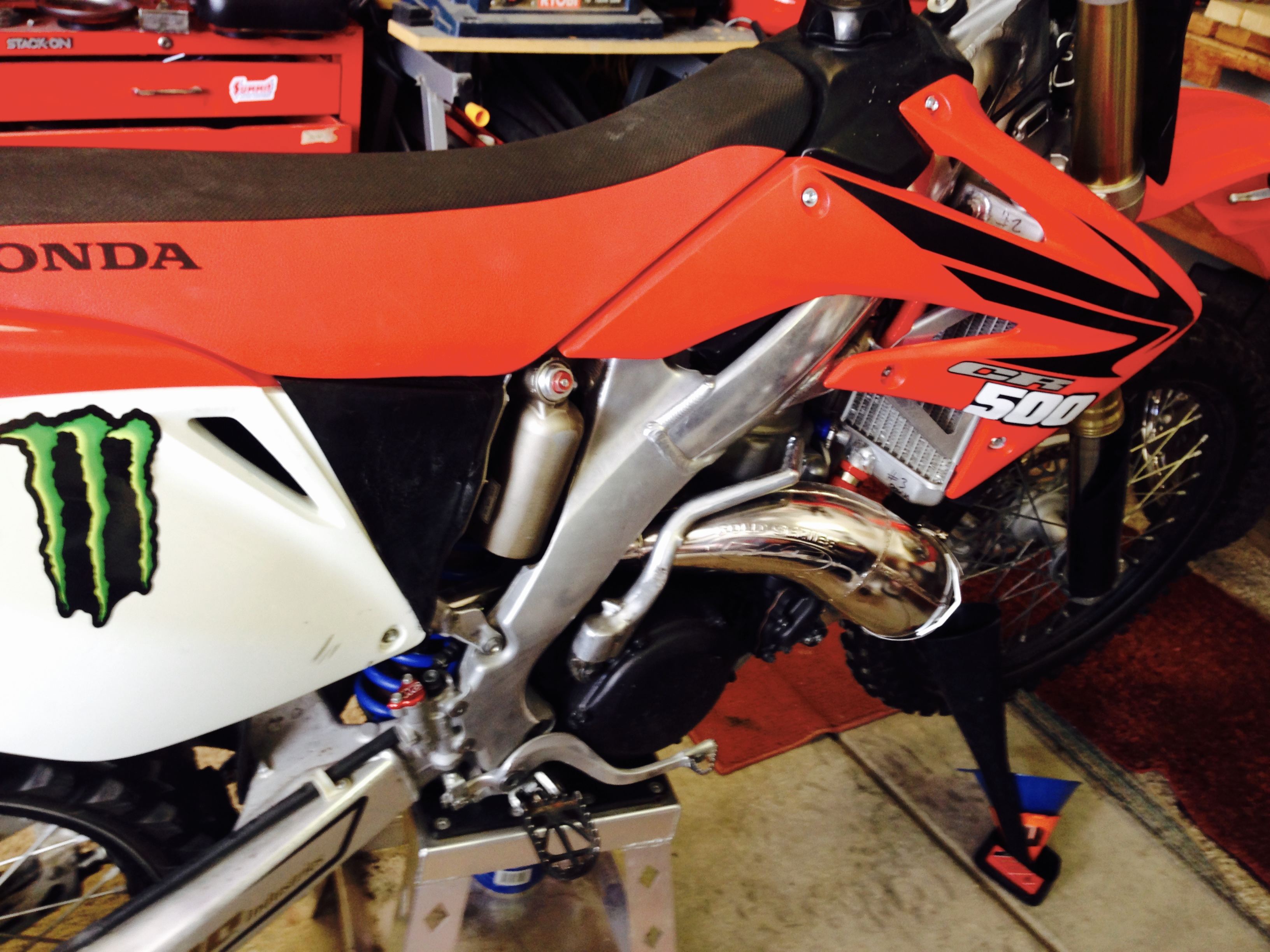

Made these bikes in a month.  08 Honda CRF 250 frame with a CR 500 aluminum frame and a KTM xc450 frame with a CR 500 motor.

Lots of Beta owners around here and several Rev4s now and past, never heard of issues like this. Just a thought here, no offence or finger pointing intended: Do you stab at your kick lever before letting them ''Mesh together'' completely? This method is big killer of any kickstart assembly, especially the cogs in a light weight trials motor. Hope you can get sorted soon and back on the pegs.
Paul, thanks for the tip.  I try not to kick the bike like my 500, but who knows.   I have four boys riding it so between all of us, I am sure someone or all kick it to hard.   The gentleman I purchased the bike from had three broken gears and this is my first.   Bottom line is the gear is a poor design.  I will work on making it better.   I really, really like the bike, just disgusted with these gears.   This is just another problem to solve. This particular year of Beta is the issue.  Just making a statement on my dislike and bad taste, did not mean to offend.   Tim p, I love your Beta as much as you.  Frustrated not being able to ride.   :(
