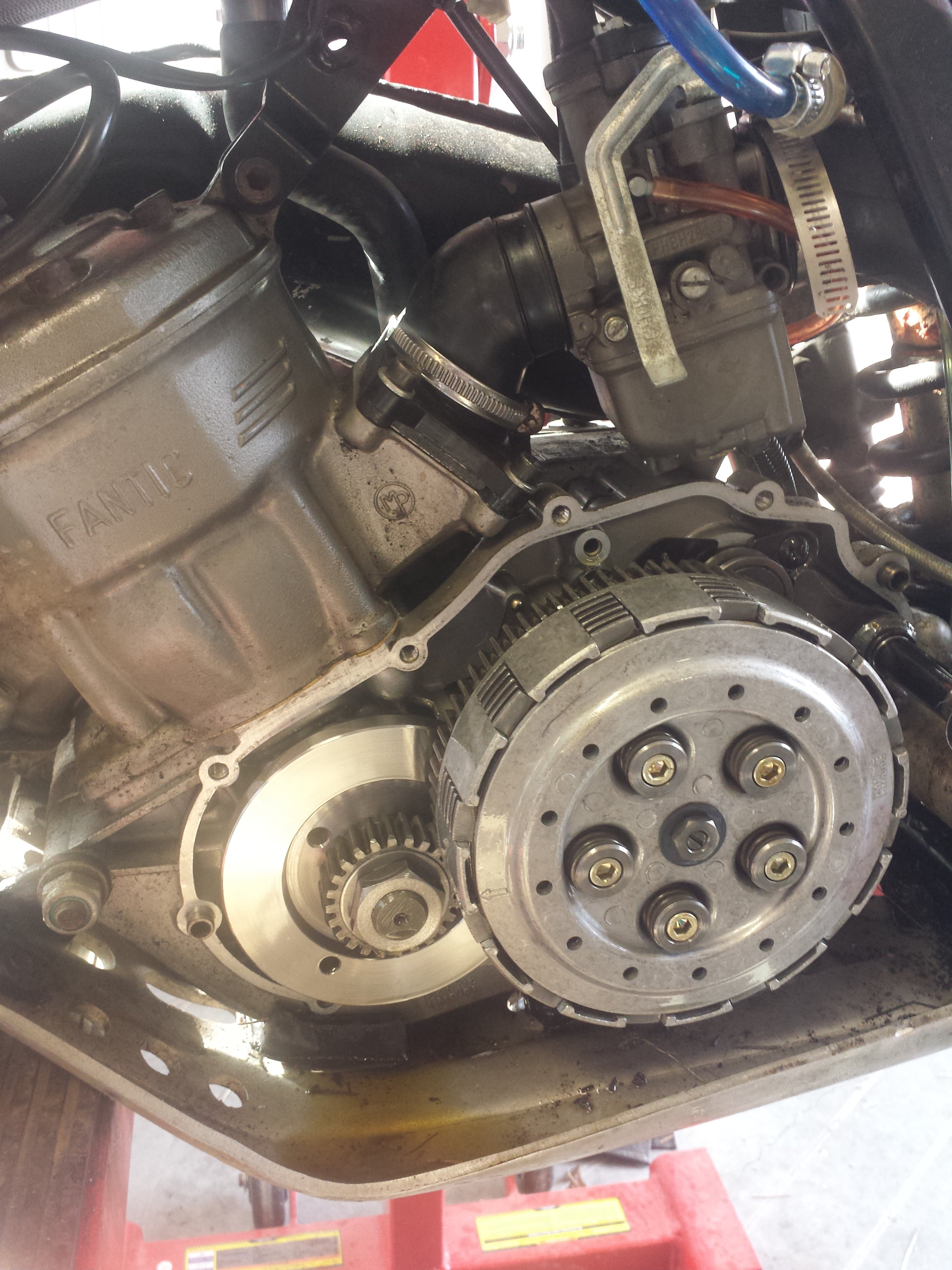

And just as I expected - tranny full of gasoline from the carburetor. Drained and filled with full synthetic 5w30. Will run a bit and flush a few times over. For some reason though, I tried to fill the Coolant from the top fill cap above the radiator and it will not drain in to the radiator. So now I squeezed in to the cap from the Coolant Reservoir to fill The coolant. Why will the radiator not take any coolant from above?
TO CLARIFY - this is how the previous owner had it hooked up. I just had to find the problem and do the troubleshooting. I'm trying to fix that idiots mistake!
Fixed all the issues created by the previous owner. Pulled the clutch apart re-lubed and roughed up the discs and slapped it back together. Fresh oil and correct size clutch cable thanks to you all! The bike is now running like a raped ape! Now to move on to the electrical with the lights. They quit working. I will chase the wires, and ensure that the radiator fan is working. You are all so wonderful and I really appreciate the help!

 Coolant cannot flow to a full cavity. It was air locked. Most systems have an air bleed. You could always bleed from the thermostat in the head. I till think it is strange that you have a clutch cable. If you looked at that manual it only showed the hydraulic parts, no clutch arm on the engine either.
