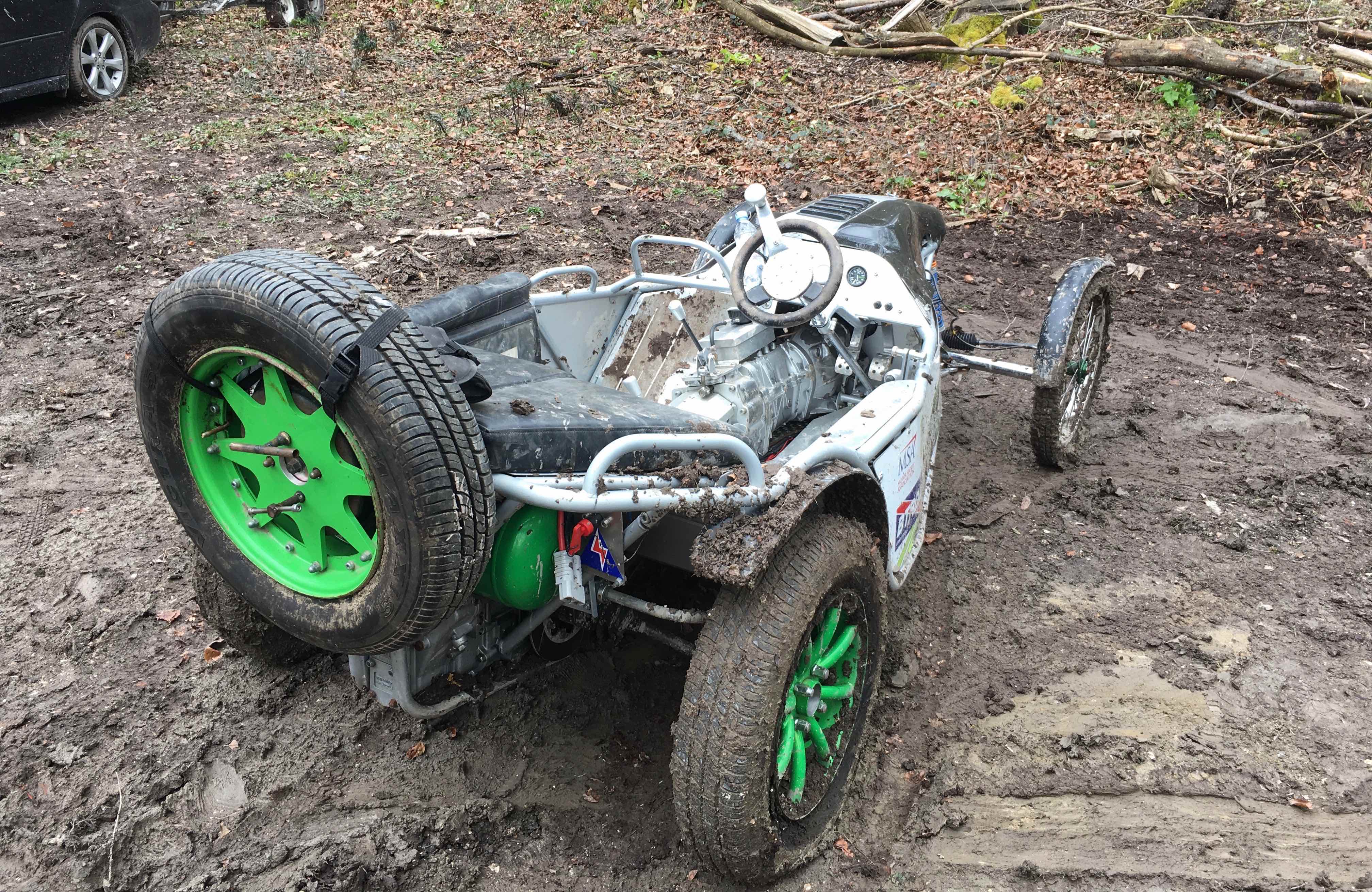

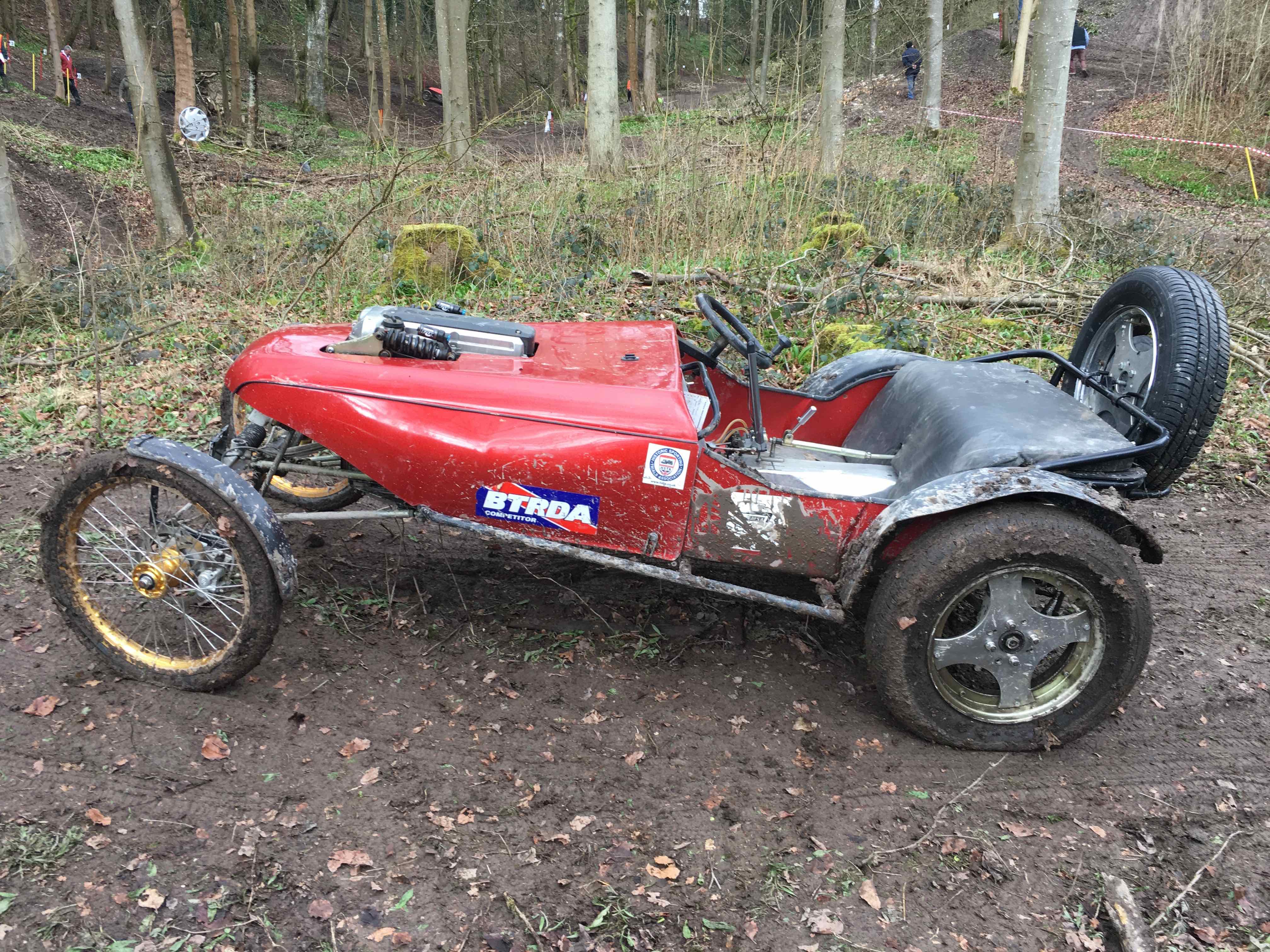

Couple of photos of the trick style sporting trials cars at an event near Petersfield in Hampshire over the weekend. Like the two and three wheel variety there is a thriving 'Retro' car scene but the rules on altering original parts (think Ford 1172 side valves and BMC A series motors) are pretty strict.
The latest cars (photos) have transaxle gearboxes and elaborate suspension setups, but all the cars cannot shift their engines back beyond a certain point. Also they are not allowed to fit limited slip diffs. All sporting sections are what we would call graded hills, often with many turns.

Interesting. A couple of points spring to mind:

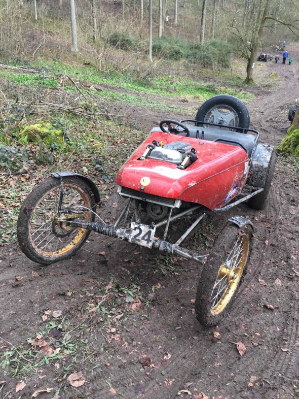

1. Why have a rule controlling engine position (presumably to indirectly control F/R weight distribution) and then allow what looks like a humungous lump of ballast in the spare wheel (pic 3)?

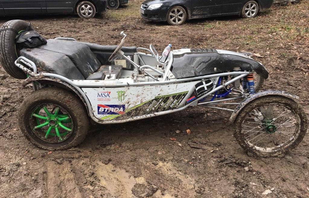

2. Why is there a conventional mid-mounted gearbox (pic 4) if the car has a transaxle?
I am guessing, but 1. they have found a way around the rule on weight distribution? and 2, to lower the gearing? I think there is a rule about what tyres they can use, basically a standard road tyre
The front spark plug front axle rule was clearly intended to control weight distribution. I believe it can only be a 1/5th of the wheel base behind the front axle. The cars can suddenly rear up when climbing also when reversing from a climb on a steep hill when the back brakes are on.
Yes the transaxle is for the same reason as is the lead in the spare tyre centre. Ballast is OK but must not be changed during the event. All cars must use the same named tyre and at each event a tyre pressure is announced. This event it was 5psi. No supercharging, so carbs or FI, the engine size being around 1500cc as in Honda or Suzuki.
