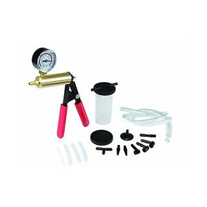

When you use a vacuum bleeder (by far the best way IMHO) you will always see air bubbles in a transparent line. It's pulling a little air from between the seal of the bleeder and the tube. So don't worry about it - you will never see clear fluid in the transparent line. But it will bleed heaps faster than ANY other method.
You can purchase cheap plastic bleeder kits from EvilBay for not much, but after doing 100's of brakes over the years I can advise get one of the brass bodied pistol grip types. It is one of the best tools in our workshop, and so fast and easy. We have one in the workshop, and one in the van at events, and they are GOLD.
