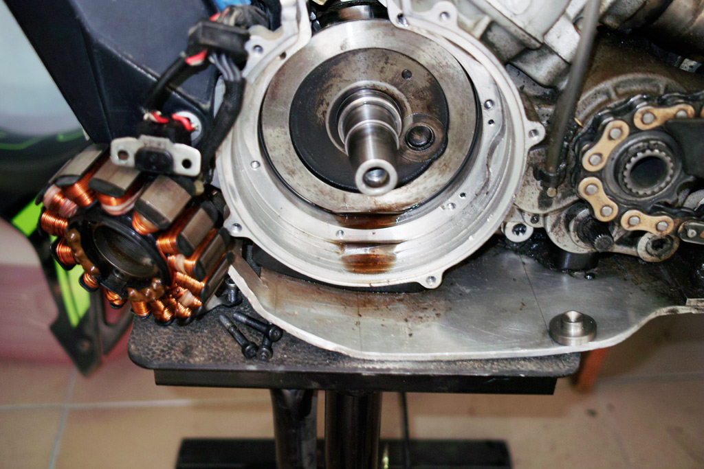

    Take the flywheel off and look for residue or loose or sheared bolts on the plate that holds and seals the crankshaft, gasket can go and lots of smoke is a sign of this. I would check this side first

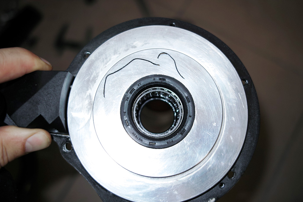

Opened the LHS case and a gulp of confirmed gearbox oil came out whre it's not supposed to be. Also found some suspicious rubber strips, apparently peeled off from the seal so I think I've found the devil - a failed O-ring.
Replaced with high quality high-pressure seal (made for hydraulic pumps). Lets see if it last longer.
After a longer run to clear residual oil from the exhaust - not smoking anymore, :) and now runs so sweet!

Those strips look like they are from installation of the original seal.If the bore it fits into has a really sharp edge,it will cut some of the outer rubber off.Be extremely careful with the tiny o-ring installation.(i use heavy grease to keep it in place)If it doesn't seal properly or blocks the oil passage,you will for sure damage the main bearing.

Could be, or could be the bearing is loose to strip a lip off the seal. The particular needle bearing gets its oiling from a separate channel (coming from two small holes you see below the big seal below the last pic) and it was well oiled as you could tell from the leak, lol. Those two o-rings both sides of the bearing are only to stop oil from getting into crank or magneto chamber, so the bearing gets it's oil anyway and you cannot block them with those o-rings, so the question is if it leaks into a place where it doesn't belong which was my case of leaking into crank chamber.

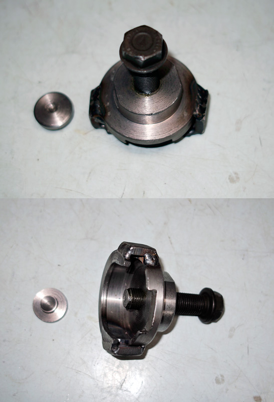

Did you make a homemade puller? If so let’s see it, I like to marvel at ingenuity
A good mate of mine made it, he's a technical wizard and even better trials rider. It's a finely machined and welded semi circle, that just fits the three alternator bolts inside (remove the alternator, stick the same bare bolts back inside, turn the semi circle around them and just pull the cover off, easy as that!), even made a spacer support that centers on the crank hole so it has a surface to rotate on. It's a top quality handwork, even the expensive pro grade tools have hard time to catch that kind of quality :)

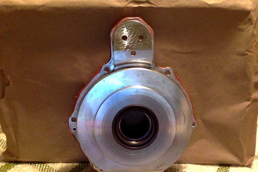

Just looking at the photo of the inner plate with oil seal, it's hard to be sure but I wonder if the oil seal was in the wrong way around, you should be able to see oil seal spring from this view, the spring always faces the pressure side, in this case the crankcase inner. With the replacement seal, this should be in viton due to the temperature limitations of other usual seal materials. Bye, PeterB.
Pretty sure the seal is correctly installed.The oil pressure is on the bearing side,not the crankcase side as per usual 2 stroke design.
Hi Ric, I disagree, there is no oil pressure, from the gearbox to the needle roller it is a gravity fed system, oil is tapped off between two tapping points through the crankcase to the bearing. Always, the spring of an oil seal faces the pressure side of a housing, in this case the pressure side is the crankcase. But, I can't tell from the photo if the side we can see is the spring side or not, it does not appear correct. I'll have a look at a spare Ossa seal and let you know. Bye, Peter B.
I'm well aware which side of the seal is pressure. (retired hydraulics tech) I have always assumed there was "some" pressure on the inside of the bearing race.Oil can't be compressed.The other side can.My Workshop manual doesn't clearly illustrate.Need input from someone else.Or...i could be wrong.
Pressure is on crankcase side, tension spring side of the seal faces inboard towards conrod:popcorn:
Here is a photo of my 2013 Ossa inner plate, that I removed to replace with a ball race conversion plate. It has the original oil seal in place. This is different to tsiklonaught's photo which I reckon is in the wrong way round and is very likely the cause of the gearbox oil entering the crankcase. Bye, Peter B.

Oil seal deffo wrong way round
