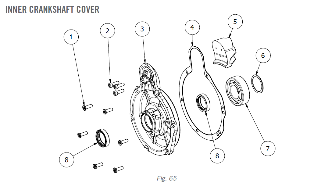

Hi Ric, the posted drawing is of the later ball race type inner plate. This bearing does not receive any oil from the gearbox, it is a 2RS, sealed type (which I don't particularly think is the best), the inner plate has the oil feed holes blanked off.
Hi tsiklonaught, If you were to remove the oil seal to fit it the correct way, then yes, it will very likely be damaged, a new one is needed, viton. There is no oil pouring in from the feed holes, it is gravity fed from the gearbox, with the very small movement of oil through the bearing taking place by capillary action and the tiny amount of height difference between the in and out feed holes.

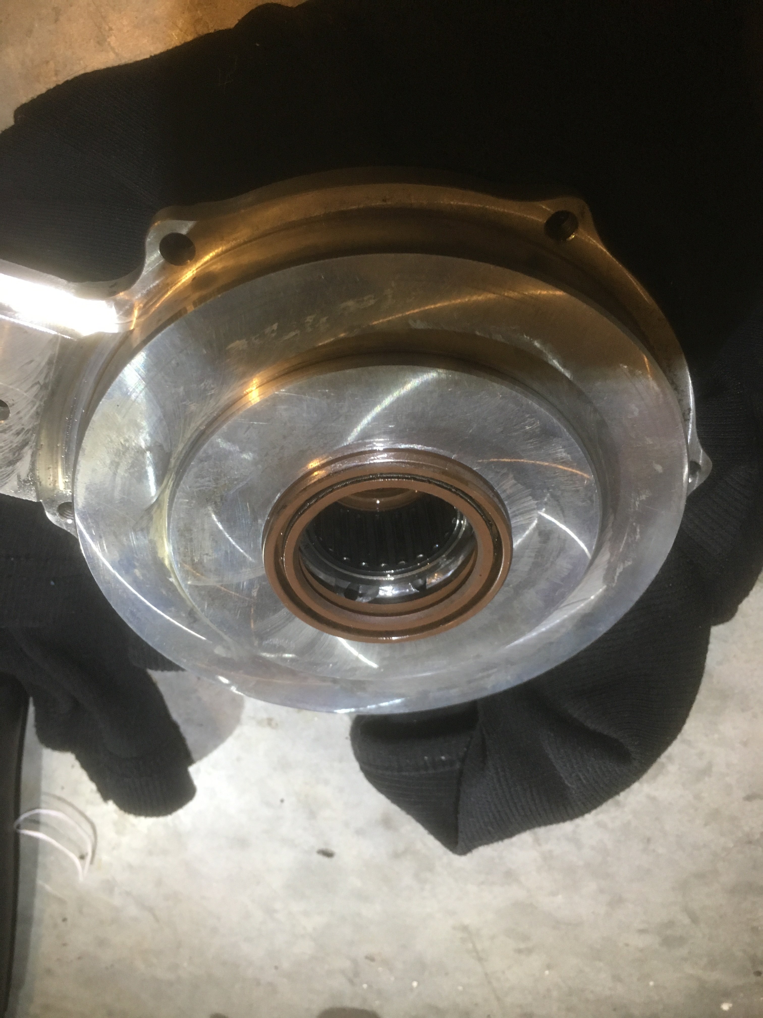

Hi,
Last year I replaced the crank seals and this is the way the inner seal was originally fitted so I replaced it the same way.
I haven't had any problems with smoke and loosing engine oil since.  My bike is a 2011 280i
(This image was before I pushed the seal fully in)
