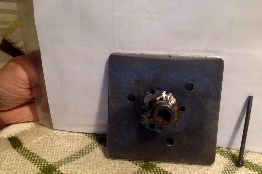

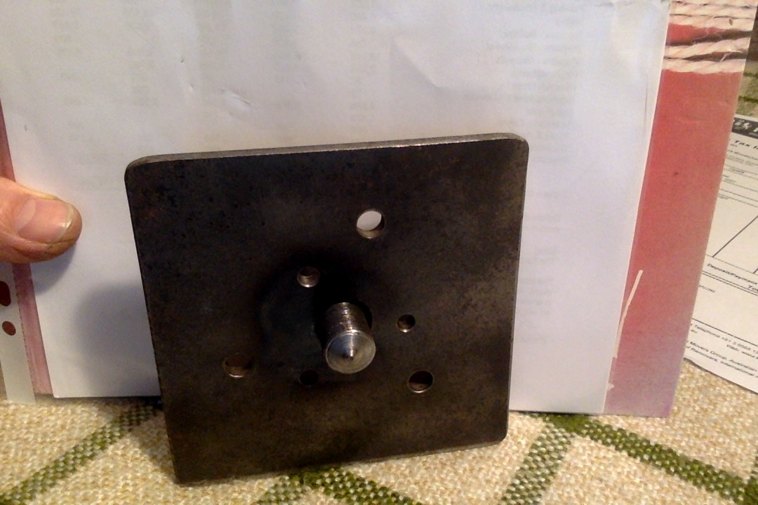

The 2013 motors have a tighter tolerance between the inner plate and crank case and need to be extracted reasonably squarely. To remove the inner plate, remove the 3 stator bolts and hang the stator out of the way, then all of the plate bolts too. You need 3 long M5 allen bolts and a steel plate with a centre bolt, and 3 holes that match the stator bolt circle diameter (BCD) Use this set up to carefully extract the plate. I'll have a look for my extractor set up and see if I can get a photo of it on here. Some measurements too. Bye, Peter B.
You mentioned thick transmission oil that get's stuck on gears. We always used ATF Dexron III on these (and many others) bikes, which is certainly not thick transmission oil. Bye, Peter B.
Here are a couple of photos of the inner plate puller. Originally made for a Scorpa (Yamaha motor) flywheel puller, then modified for the Ossa using the inner 3 holes. The BCD, not accurately measured, is 42.0mm, check your stator hole placement. M5 bolt length = 70mm. Hard to see the third inner hole on the photo. (Two sets of 3 holes) Plate is 6mm. Hope this helps. You should be able to get someone to make up one of these. With the centre screw puller, make sure it does not damage the M10 thread at the end of the crank, I use a nut in between. Bye, Peter B.

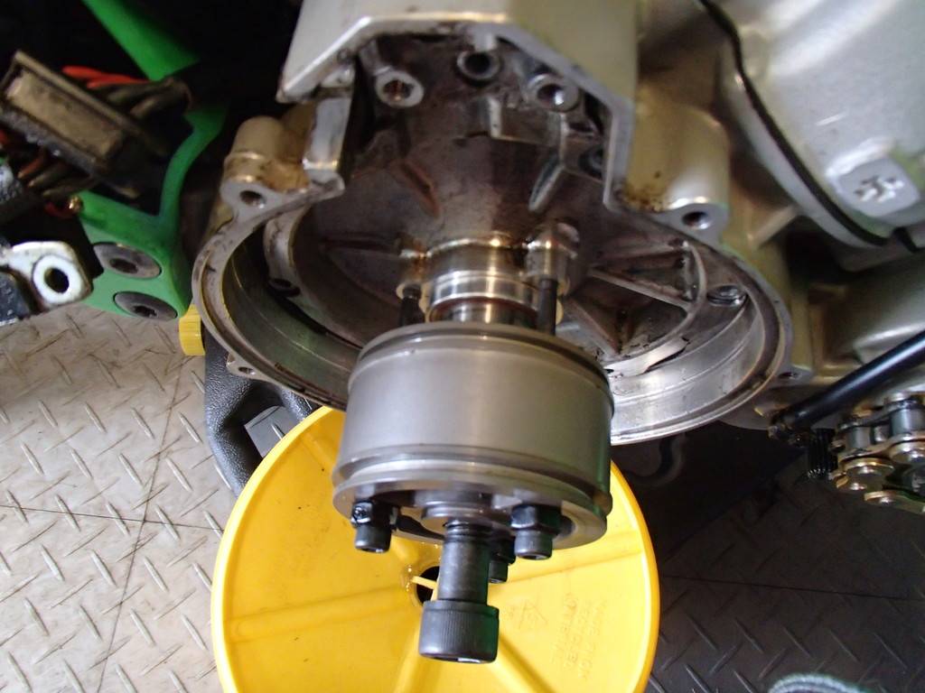

I used a piston from an old hydraulic foot pump with a few nuts and bolts.
