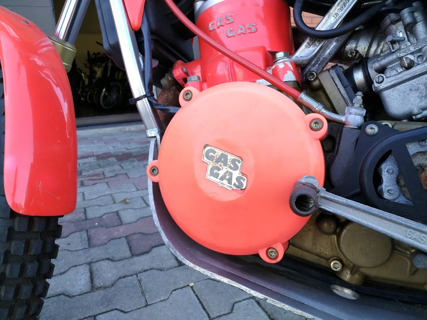

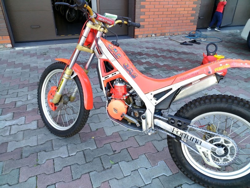

September 25, 20188 yr Hello. I bought my first trial motorcycle after enduro motorcycles. I always had Japanese motorcycles and this is my first Spanish motorcycle. I'm from Russia and my English is very bad, sorry if I wrote something wrong. I do not know what kind of model it is and what year it is? Looking at the pictures, I assumed it was JT 25? I would really like to know the weaknesses of this model, please share if anyone has the information. In Russia, the trial is very poorly developed and there is no information about these motorcycles. Also I can not find the manual of the motorcycle and user's manual. I replaced the transmission fluid on the motorcycle. Replaced DOT4 in brakes and hydraulic clutch. I cleaned the carburetor. What else to pay attention to and what to do? Many thanks! Edited September 25, 20188 yr by venickey
September 25, 20188 yr Hi, your bike is a 1994 jt25, 250cc. Edited September 25, 20188 yr by tshock250
September 25, 20188 yr Dobroe utro venickey, the bike is reasonably reliable. There is no manual for this. Although the recommended gearbox oil is 700ml, it is ok to use 600ml of ATF rated to Dexron III. The water pump seal and shaft wear, which allows coolant to enter the gearbox and mix with the oil. The water/coolant can create a problem with the glue used on the clutch fibres, allowing them to lift away from the steel. This makes the clutch action drag when pulled in. On your carburettor, the pilot adjusting screw should be set to around 3.5 turns out, from fully in as a starting point. The throttle needle in the second notch from the bottom. The suspension linkage, as most trials bikes, requires stripping, cleaning and greasing with a waterproof grease. Hope this helps. Bye, Peter B.
