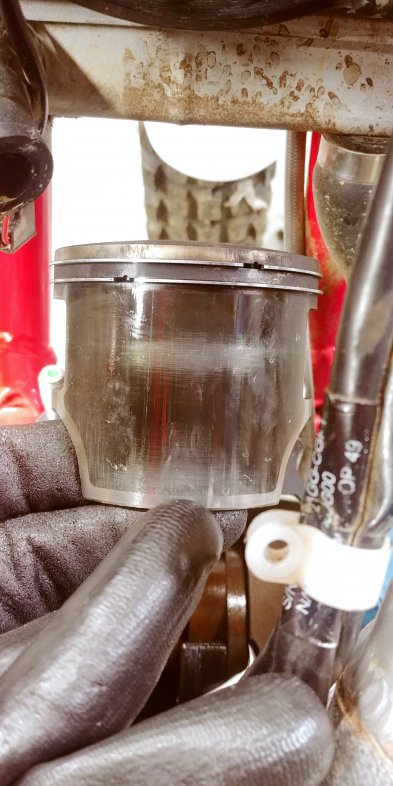

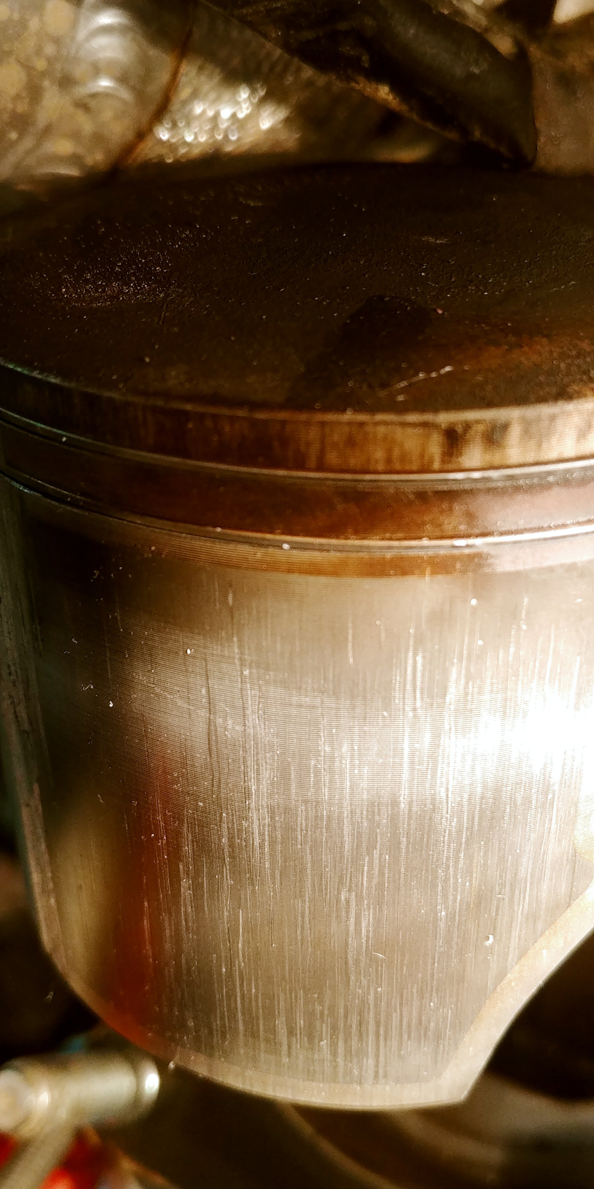

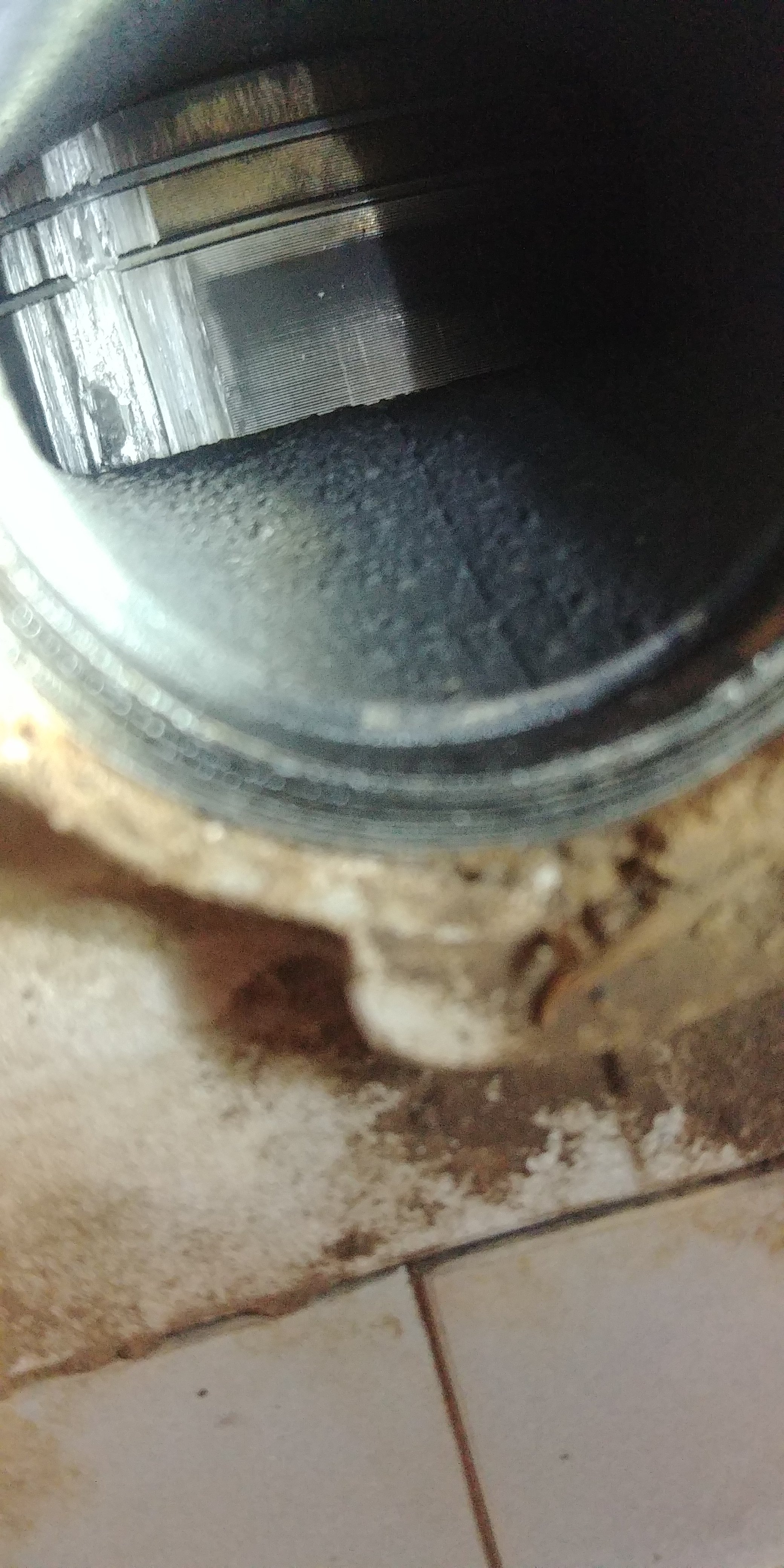

Sorry for lack of updates, had limited time to work on bikes and had to dedicate all of it to keeping my enduro bike going.  Finally took a look at this pos Contact ES.  Turned out I have left hand thread flywheel puller but needed a right hand so waiting on that to show up to see if the flywheel got spun.  Pulled exhaust and then had to pull the head off and now need to pull cylinder off to see if the crank is dead too.  Sorry my terminology might be off, I know my 4-stroke Honda CRFs in and out but clueless on 2-strokes.  Head looks good.
So I'm now wondering did it spin fast enough while in the "diesel" mode to do this damage or it was some manufacturing defect that was there all along?    And also still how do I prevent it from doing this trick again.
Dakh - excuse my old eyes and it's early morning here now, but - in the (first) photo taken through the exhaust outlet, is the ring retaining pin visible in the groove of the upper ring? The ends of those rings look too well define. There should be no ring ends visible in that area of the piston. To me it looks like the piston was installed backwards and the ring ends caught on the exhaust port. Ensure that your piston is correctly oriented; the manufacturing "arrow" should point to the exhaust port (and the ring retaining pins and ring ends should not pass over any open areas of the cylinder).
And to me, the second picture seems to show that the wear was occurring over a longer period of time - as evidenced by the variations in the black and brown areas - and that it didn't just "grenade". I think something was rubbing on the cylinder that shouldn't have. :(
Edited by d2w

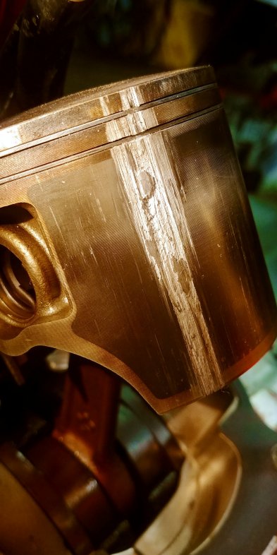

Ring gaps look to be in the right place (it's the back of the cylinder), it was just enough piston material that obliterated the ring -- I scraped it off with a knife and it's as expected.  Cylinder is definitely toast too, the scrape that is above the port maybe can be cleaned up and honed out but there's a good chunk of coating (nicasil?) missing below the port that I uncovered after I scraped some of the aluminum.  Maybe it was an imperfection in the cylinder to begin with.  But looking at the exhaust side of the piston, it has perceptible scrapes all along the surface so this thing just ran way too hot.
At least the crank and rod look Ok, no play at all.
Should I send this cylinder to Millenium or someone like that or just get a new one?  Good source for pistons?
One more thing, while the bike was parked it weeped a bit of coolant.  I could not trace where it came from.  Took the water pump out and it looks all good to me.  Is that maybe expected or should I try to maybe pressure test the cooling system?  It didn't leak anymore so I'm not able to reproduce it.  Radiator with no cap that would blow pressure off freaks me out a bit, if it got so hot maybe there's damage that I'm not able to see?
Thanks!
