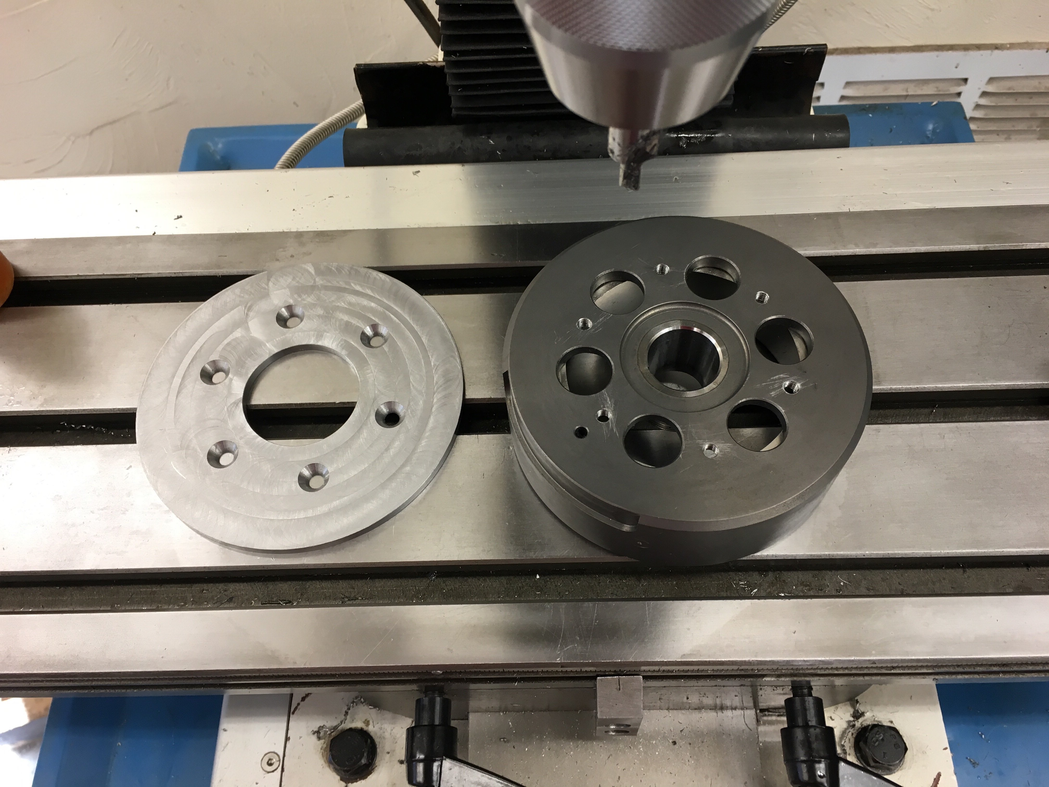

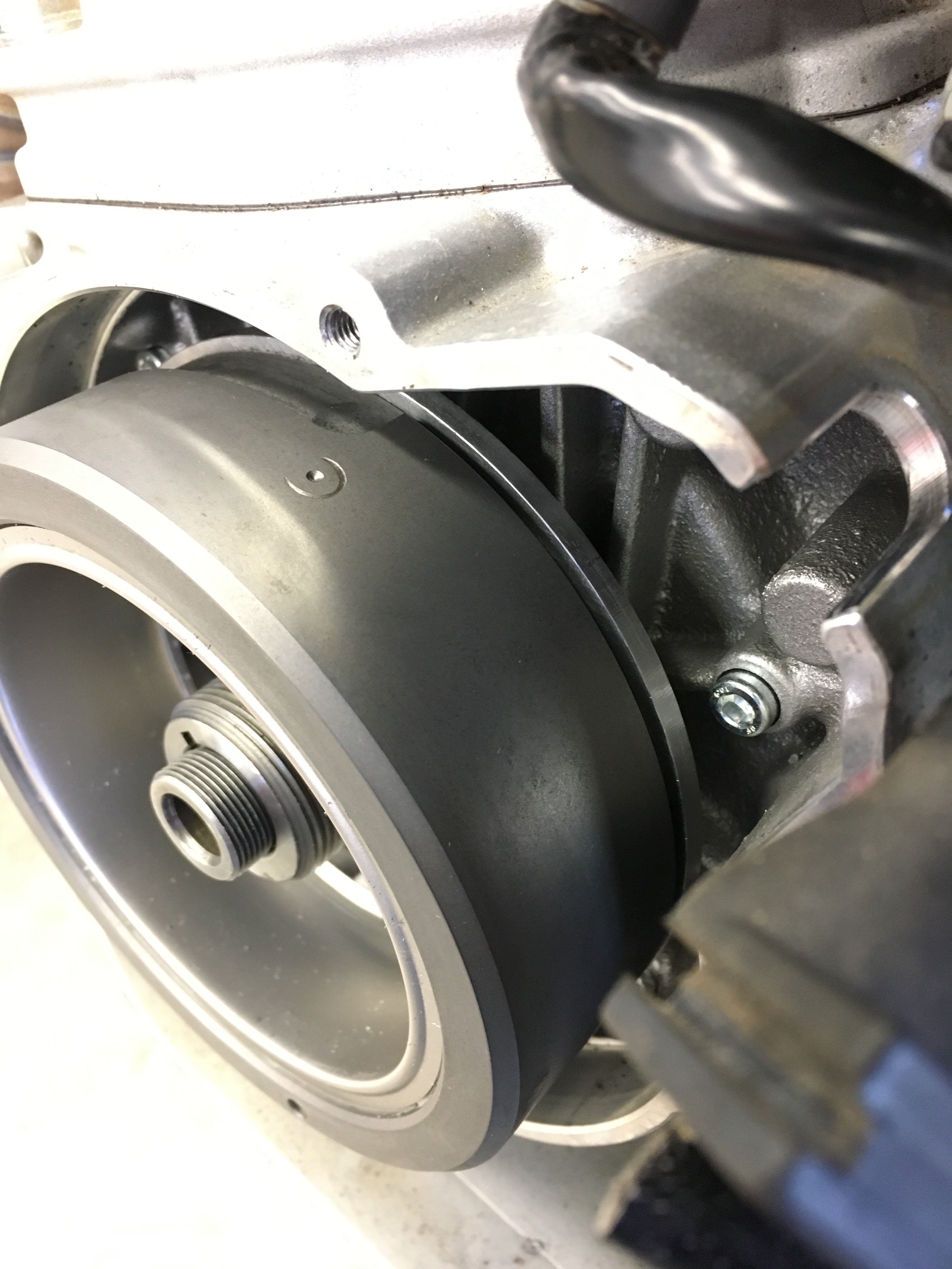

I've been pining for more flywheel mass on my TRS125. A commercial flywheel weight is not available. Here's the solution I came up with.
On my 125, there's about 5mm space between the flywheel and the crankcase. I machined a 4mm disc from mild steel that attaches directly to the back of the flywheel via tapped holes added to the flywheel.
I haven't ridden the bike too much yet. My first impression is that perhaps for me the weight should be a bit less. This one weighs about 11oz. Does anyone know what is typical for a 125?

I think by trial and error you are going to be the expert when it comes to adding weight to the TRS 125 flywheel!  Keep us posted.
Out of curiosity why do you feel you need more flywheel weight on a 125? What type of feel are you trying to get out of this?
Usually on 125 your wanting a fast revving bike to get to the mid range and most importantly wide open where the power is quick when it is needed. Increasing bottom end is also a big thing to do but only so much can be done there without harming top end. I just dont see the benefit of more flywheel weight on a 125. Just would make the throttle response slower, rev slower even though it would hold rpm longer thats why you see guys keeping the throttle on at the top of obstacles on 125 more often. Then again its probably my riding style and being able to push a 125 to the limit on big obstacles is why i feel this way. But im still curious on your thoughts. good luck on your experiment.

I'm looking to make the engine a bit more stall resistant.  I'm a 63 and have been riding trials for a hand-full of years.  Prior to the TRS, all of my trials experience was on a ty175.  The ty, by comparision, is impossible to stall. I'm hoping that with some percentage more flywheel mass, there's a sweet spot. A place where the engine is less likely to stall, but not too sluggish either.
