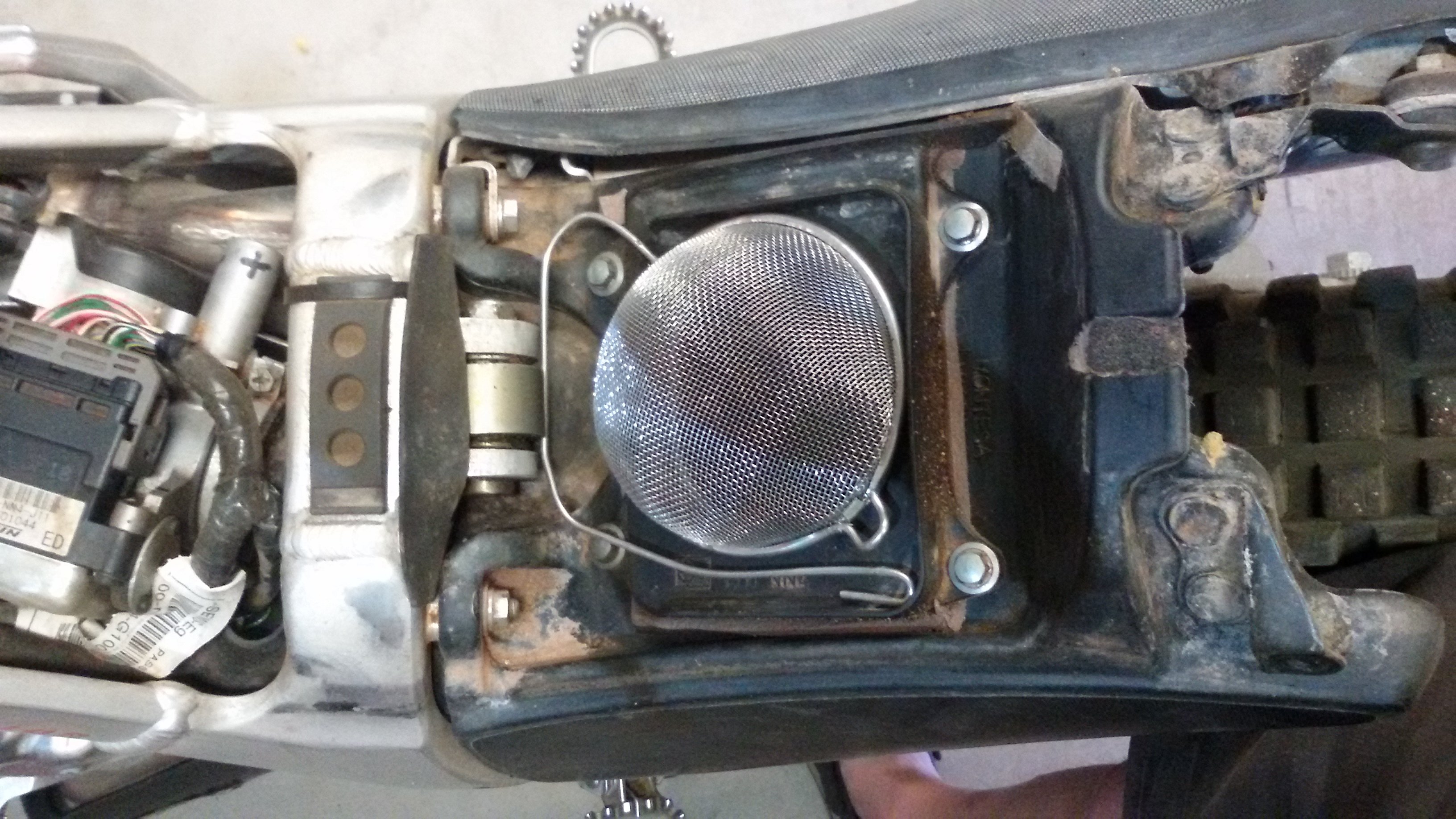

Thanks Jimmyl, that's what I hoped to hear! I am going to compete, after years away, but don't expect to be setting the world on fire. I've got a Mitani bash plate coming (went for the 5mm as opposed to 6 as I'm not going to be doing anything really heavy duty), Mitani stand and that's it so far. I have thought about the air filter protection and the bike has the std splash guard under the rear mudguard and I think this should be ok...I'm in the south and it's not like there are the rocks and streams that you regularly ride up North.

would put the mesh on the mudguard vents and dump the oil catch tray under the head stock

Cheers. I had seen a couple with mesh under the vents (in the dip of the "seat area" right?) and wondered 'cos you can see the electrical connectors and what not - is it just a mesh and tape job??

I just put a little strainer on the air intake.
Tea strainer... like it! Cheers

I just taped up the vents from the inside. Bike runs fine and the amount of muck that still reaches the filter shows that plenty air is getting through.
Ahhh that helps. So no worries about the gauge of mesh then. Thanks a lot ?
