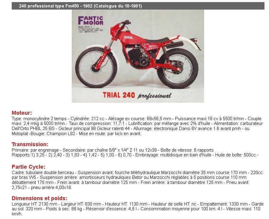

If it's Fantic 240 your after  69x56,5 mm
Edited by Bilko
Thanks for the info and link Bilko, much appreciated.
bore 69mm ,overall hieght 75mm, center pin to crown32mm, pin dia 18mm There is also letter stamped on crowm A to G
