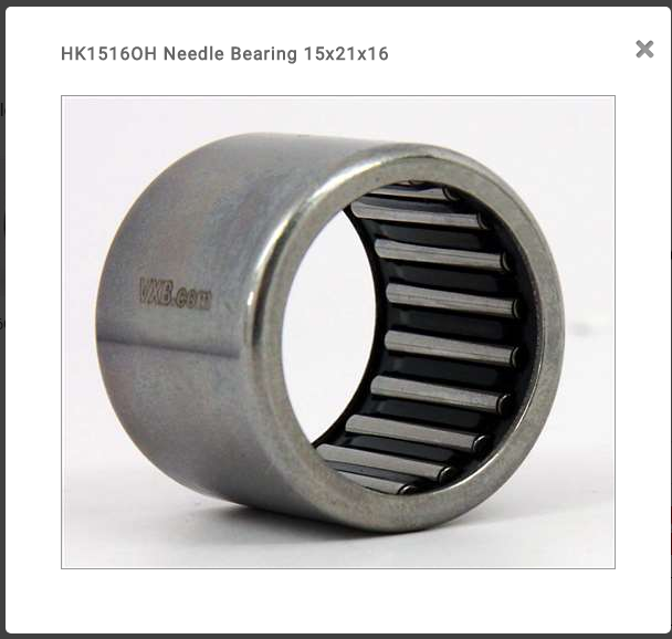

I tore down the dog bones today.  As you can see in the the VXB photo of the bearing there is no seal.

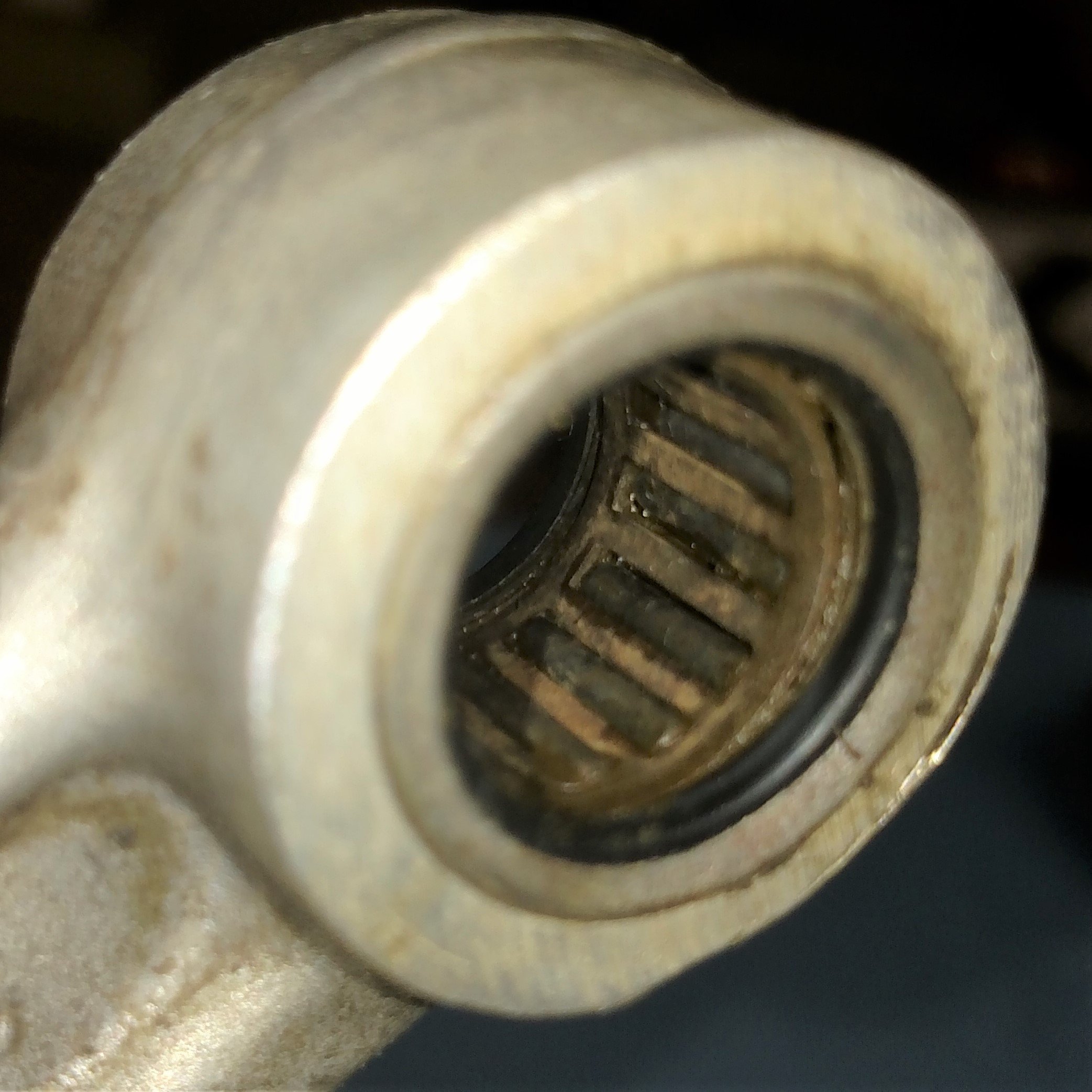

Here is a photo of the same bearing installed in my dog bones.  (Still a bit dirty, but hopefully can see it clear enough)
note: it is a caged bearing and there is a rubber seal, I "persuaded" the original GasGas seals to be in place. It is a very tight fit and the seal does stick out probably a half mm from the dog bones.  but after install in the bike, they don't stick out anymore.  SQUISH!!  ?

Thanks for the follow up and pics Zippy. I'm going to try using the GG outer seals next time I replace my bearings then, should help keep some moisture out.
