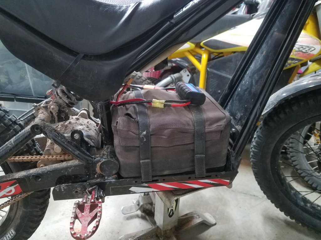

Just an update.
This is the pack I bought:
https://www.ebay.com/itm/Rechargeable-48V20Ah-LiFePO4-Battery-Pack-for-Ebike-Scooter-pedicabs-Charger/123191554222?ssPageName=STRK%3AMEBIDX%3AIT&_trksid=p2057872.m2749.l2649
It's AWESOME!!  Shape is almost exactly the same as the lead acid battery pack, probably an inch taller, but the canvas pouch fits over it and it just looks stock. I added a gauge that's velcro'd to the top velcro strap.  We haven't been able to run it out of juice yet!!  What a huge improvement.  Used 9.5ah yesterday and did about a 12 mile trail ride, the pack is still at 52v.  It's rated for 20ah, curious to see if I get that much out of it, but it's REALLY hard to run it down riding around the house (I always fully charge it for rides...)  Even though the stock lead acid batteries said they were 10ah, We were only getting about 6 miles or 30-45min....so 12 miles or about 2-3 hours so far is a huge improvement, even if we don't get 20ah.
As for max amp draw, I don't have any real definitive info.  I turned it all the way up and compared it back to back with my buddies 2015 20.0R and it 'feels' the same to me, definitely plenty for my daughter trail riding.  The increased voltage does speed it up a little, so I had to turn it all the way down, so if you need the lowest settings with the lead acid batteries, you will lose that with this upgrade as it won't dial down quite as low.  I also went up a slight paved hill and was able look down at the guage, and it was pulling 1785-1900w up the whole hill (maybe 100yards)  which is about 37-40amps, so I think that the rating of 50a continuous is probably correct (there was some question about this that gwhy brought up above).
Time is the real test, but the pack seems totally legit and for $300 (make an offer, he accepted my $300 offer) its a crazy good value.
Edited by Yrocmoto

It's a great pack for the price.  We aren't getting the rated 20ah, but way longer ride times than the stock SLA batteries.  We rode for 2-3 hours yesterday and never ran out of juice.  The 5A charger helps keep it charged between riding.
We've only fully drained it twice and got 14.96ah out of it the first time and 13.88 the second time.  The second time was over 4 days, so I don't know if there is any drop just sitting.
The low voltage cutoff of the pack is 40v, but the Oset goes into limp mode around 46-47v, and doesn't run long after that until full shut-off.  I don't know if that's a problem with my Oset as I bought it used, but I would assume that also has something to do with not getting the full 20ah out of the pack.  Overall, it's worth $300.

Did a quick search and this looks like what I got, check the dimensions to make sure it will fit, I will double check mine when I get some time.  Mine is 48v 20AH LifePO4, but they come in a couple different dimensions.
Lifepo4 Pack
Also, we did a 22 mile ride in the desert, I thought we'd get stranded when I saw that we were at 11 miles and still needed to make it back, but it made it.  My meter said she consumed 15.85ah, but I've been reading that the meter I use may be inaccurate for the accumulated ah, but I've found it to work for us and seems pretty consistent.
Edited by Yrocmoto
