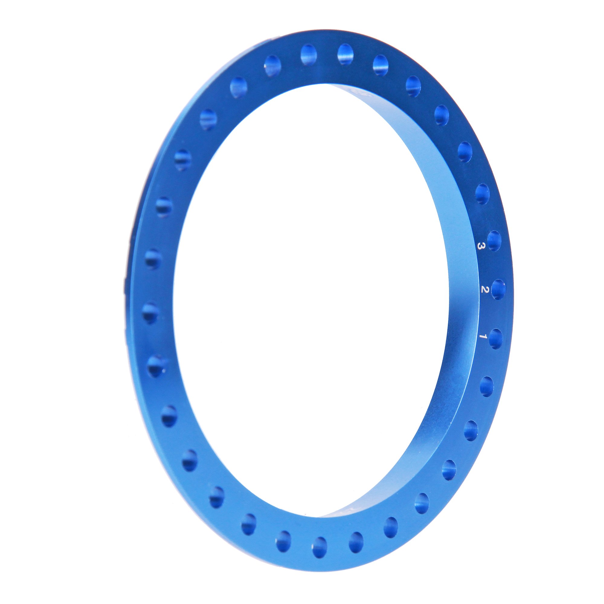

I suspect your adjust clutch is something like this: https://www.splatshop.co.uk/xiu-rdi-adjustable-spring-clutch-support-plate-ossa.html
If so, huski is (mostly) correct. You actually remove the clutch spring retaining ring, and then rotate it by one or two mounting positions, and then re-secure. What you're doing is changing the preload on the clutch spring. And, yes, you can perform this change without draining any fluids; lay the bike on its side to retain the oil, and there's no reason to drain/remove/separate the water pump as it can stay with the clutch cover.

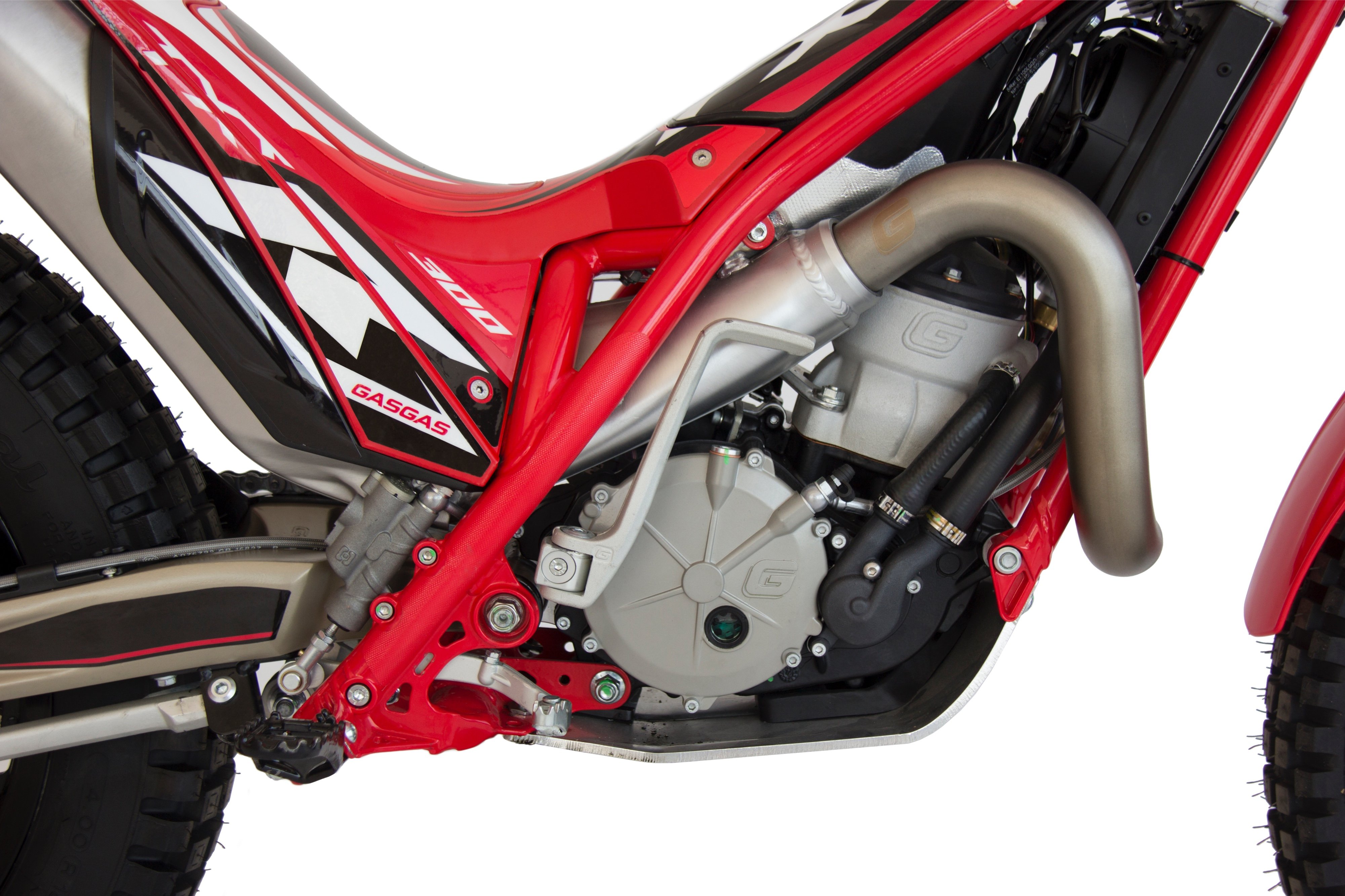

2019 bike is slightly different to that video. They redesigned the case to make it easier to get to (see pic). Think you can get away without taking off the kickstart but its only one bolt and easier with it out of the way. Just under middle case bolts (leave the water pump alone) paying attention to the length of the bolts (3 different lengths) and remove case with hydraulics still connected. Use a zip tie to fasten out of the way. You can remove bolts next to the numbers and change the settings to either 1,2 or 3. Once you put the first bolt on its new setting move the rest accordingly with equal spacing. The different bolt positions alters the amount of pressure on the clutch pack and changes the speed of the clutch. I've also attached a picture of the Xiurdi plate which is the guy that designed it. GG one is the same just different colour.

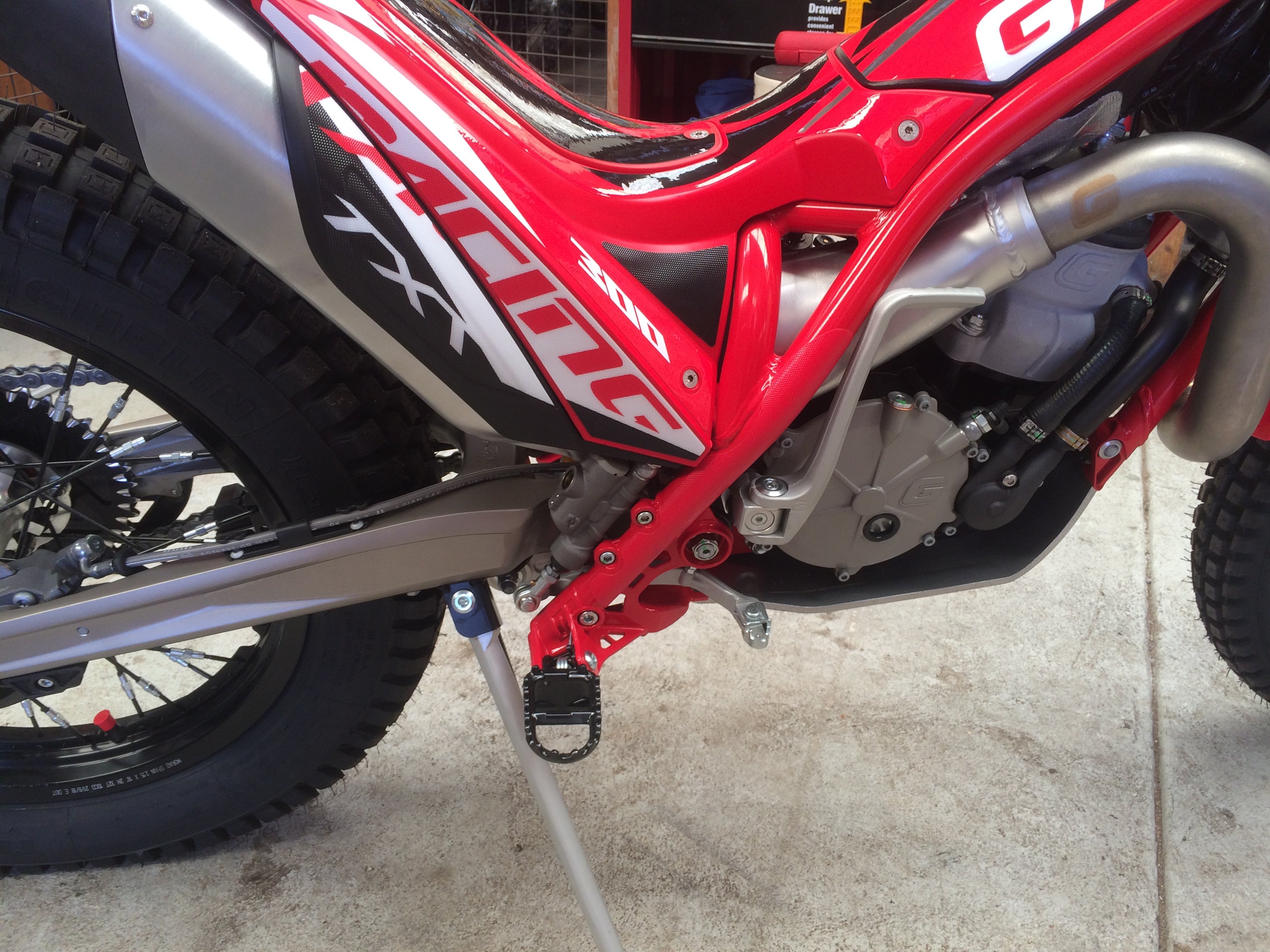

Slightly different graphics on mine....... Looks the same model.
The last one left in Oz apparently (pinch of salt) and sold off cheap since KTM just bought them out. (Just figured out your image is a 2020)
Edited by Kevinoz
Yes it was the best quality image I could find. There isn't that much difference between the 19 and the 20, certainly not in the clutch.
It looks almost like bold new graphics for the 2020.
