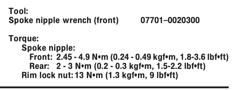

While doing a search on truing up a new rear rim, I came across this post.  Thought I would add what my 2017 Montesa manual says regarding front and rear spoke torque in case someone in the future searches and finds this thread.
