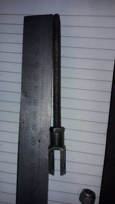

Took the bike to the local shop to have the rear brake bleed, on picking it up they mentioned that it was a right pain to bleed and believed that the bar that goes in the master cylinder was to short.. Went out on the bike on Saturday and the rear brake was hit and miss, some times it worked then nothing,  you could feel through the pedal like something was slipping...
So before I buy one on ebay as they don't tell you the size of the bar, does anyone have one to measure on theirs?
Mine is around 123mm

I think it'd be wise to just double check the mcyl piston can return all the way out to the rest position first, just to make sure the garage aren't missing the ball.
I agree with Lineaway on that NOT being an original Beta part.  There is no need for threads running all the way up the push rod.
In fact having threads at the top will damage the seals.
Will order a standard one, probably damaged in the past and someone has made a replacement..
Cheers Jamie
Shouldn't have damaged the seal which is internal to the master cylinder but will destroy the dust cover.
