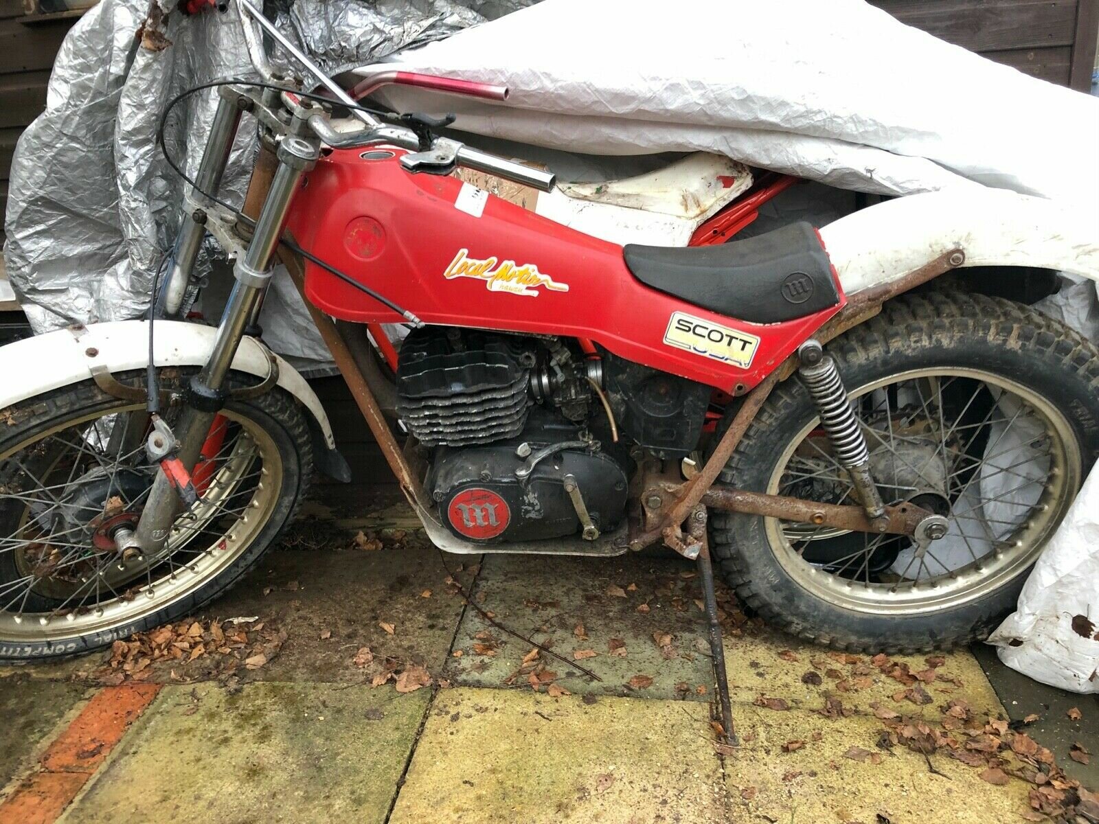

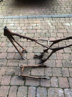

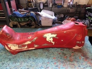

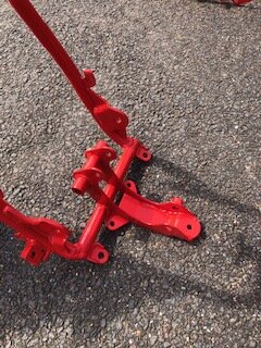

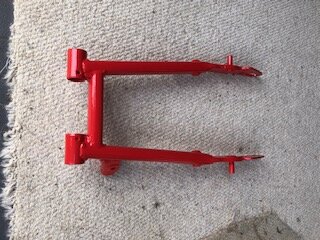

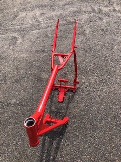

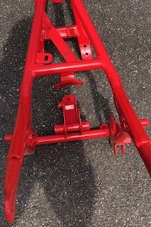

Just thought I’d put a few pics up of the 349 White Wonder if anyone is interested?
They're not in order, which is down to operator error!😃 but it gives an idea of “before & after”.
If I knew what I was doing on the ipad, they would be in order & not looking so random.
I don't know what I'm doing so they are! 🤪

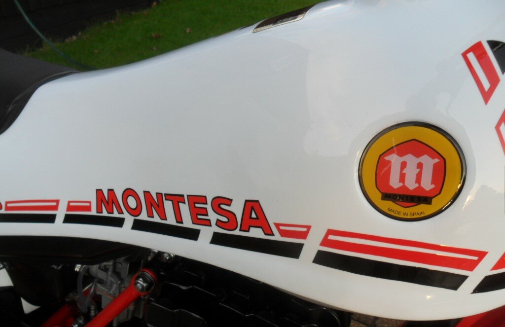

It's looking good!

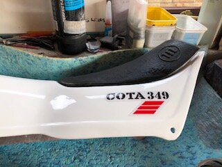

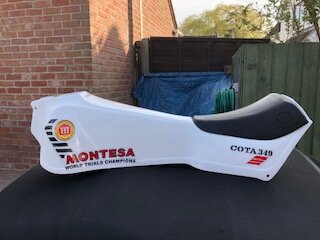

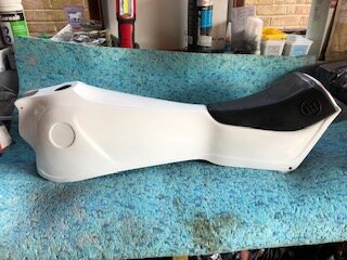

Especially the tank can I ask did you paint that yourself? got a new tank cover to paint for my 348 and I'm after tips
6 hours ago, barnesy said:
It's looking good!
yep, painted it myself. I’m no painter but it came out pretty good considering the state it was in.
long story short, rub down tank-high build primer x 3 coats-wet sand 1200 grit-white primer x 3 coats (unless your high build was white anyway, mine was grey)-stopper putty if you’ve got any pin holes or imperfections-as many coats of gloss white (or whatever colour you’re using) as you can (I used Autotek gloss white large tin 1k)-wet sand 2000 grit-medium compound-light compound-final polish.
as I said, I’m no painter but have done several bike tanks with half decent results, so if you need a heads up, just ping a message over & I’ll do my best to answer it.

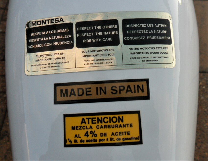

Decals came from Spain off fleabay, pretty pleased with the quality at the time I must say.

The front forks on mine were red with black hubs and gold rims.
The foot pegs were horrendous and made of butter. Oem was definitely not best !
The forks were chrome, badly pitted, but definite signs of chrome. The frame pre-powder coat had signs of chrome, possibly someone years ago decided to chrome the frame? I had already painted the forks silver (to match what was there) having looked through dozens of 349 WW photos, think I need to paint these red now.

I thought I’d been a clever clogs & used the greenhouse as a make shift spray booth, all glass, nice & warm, no dust. Paint job still ended up with dust particles on it & a couple of orange peel areas. If you get the same, don’t worry, 2000 grit then 3000 grit with plenty of soapy water & all the dust marks disappeared. Don’t forget, that even with 4 or 5 coats of paint, paint from a rattle can is very very thin so too much wet sanding can go through the paint. 😳
What did you use to stop petrol attacking the finished result ?
I used rattle can lacquer from Halfords and it did not resist a minor spillage, very disappointing. You would think that paint from a car accessory business would be paint resistant.
Mmmm haven’t got that far just yet! Mine is purely a ‘tank cover’ I have an alloy tank that sits beneath the tank cover. I would hope that any spillage would not affect the paint......you’ve got me worried now!😳
Hit the button too quickly, perhaps a good coat of polish followed by a sealant might help?
When I did mine, I used a rattle can for the primer/filler build up, then rattle can brilliant white. Flatted it back to matt (500 and 1200 grit), applied decals (last original set from Vallmoto), then had an aquaintance with a body shop apply 2k clear coat in his painting booth.
That was petrol proof.
